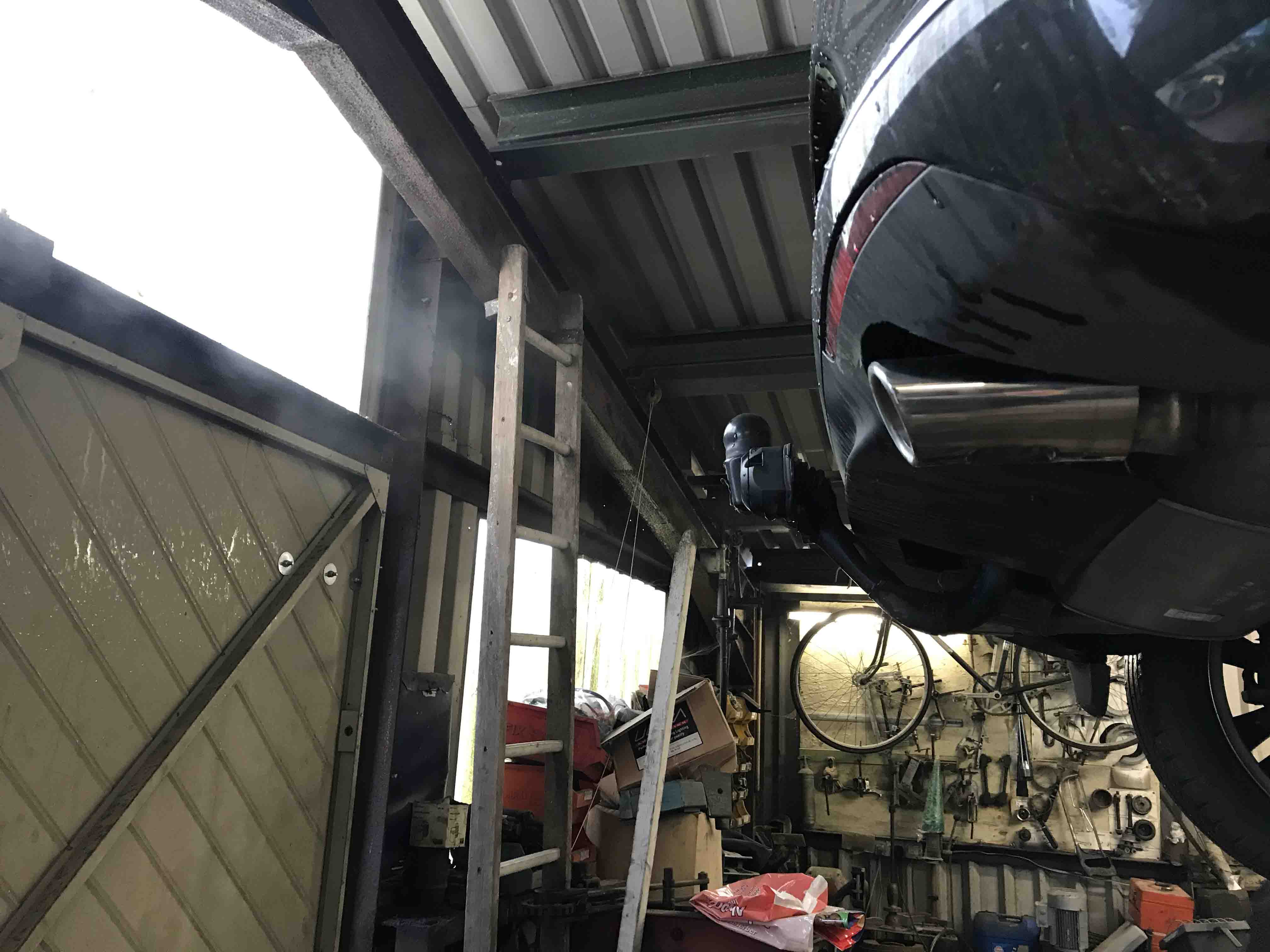

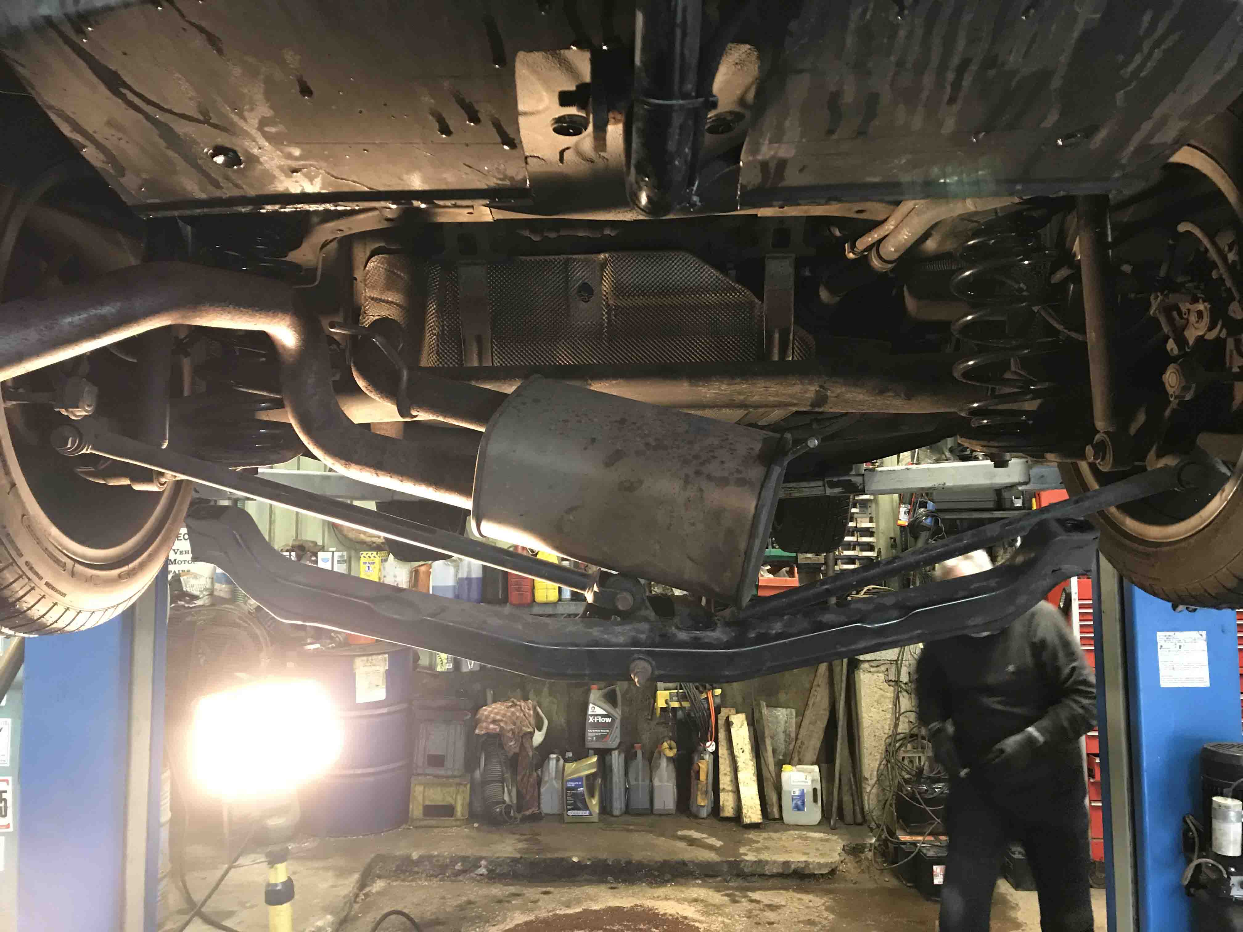

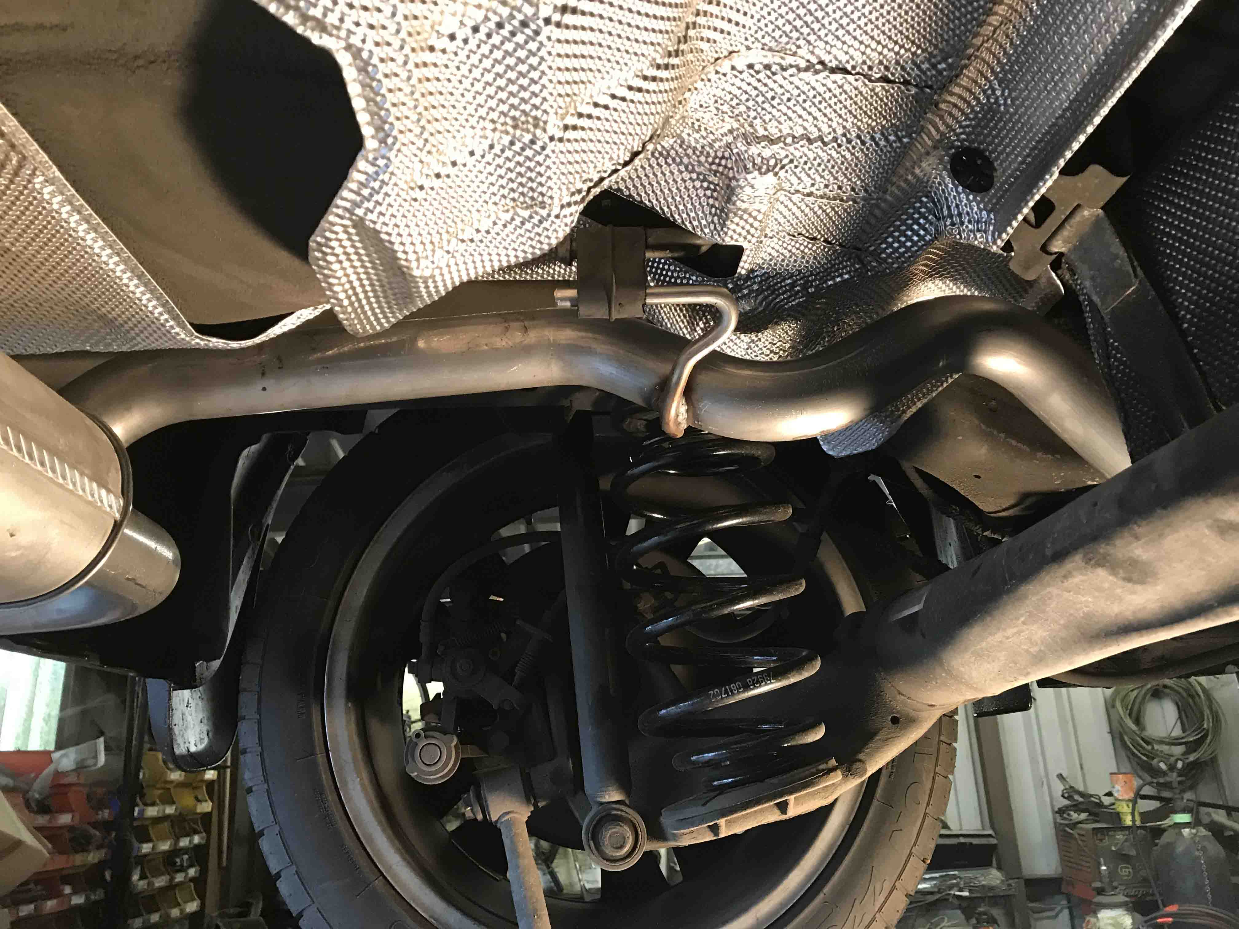

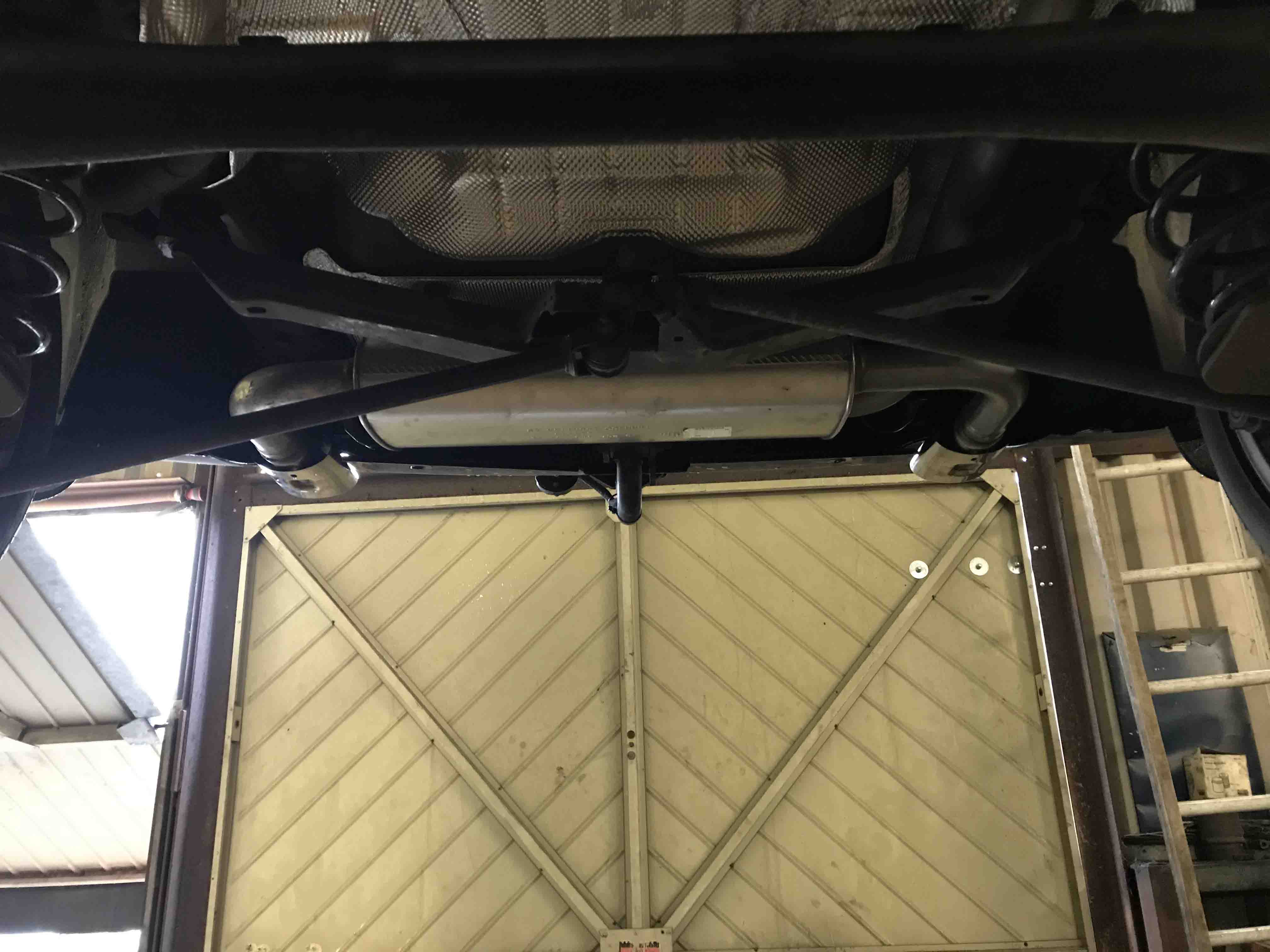

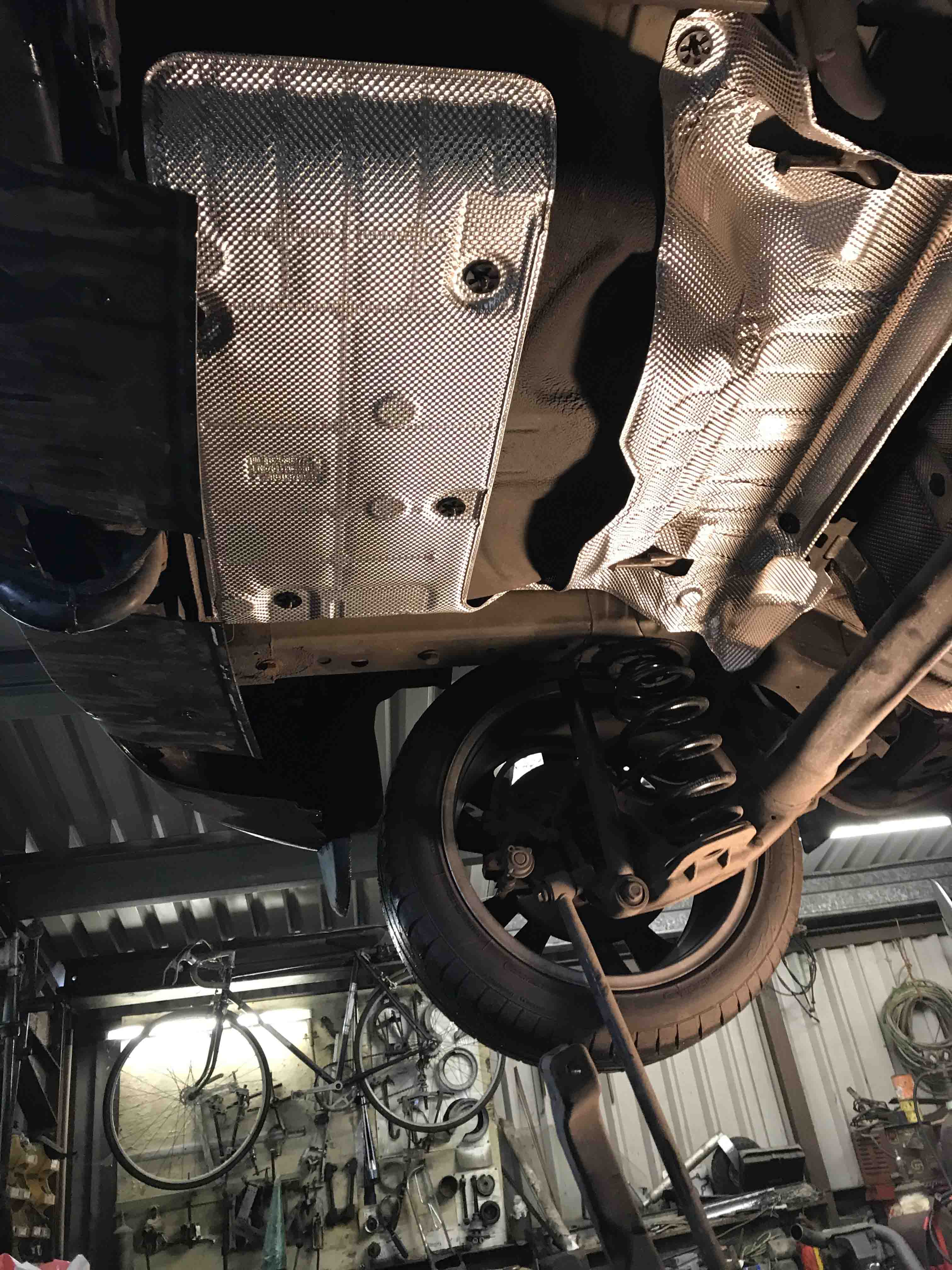

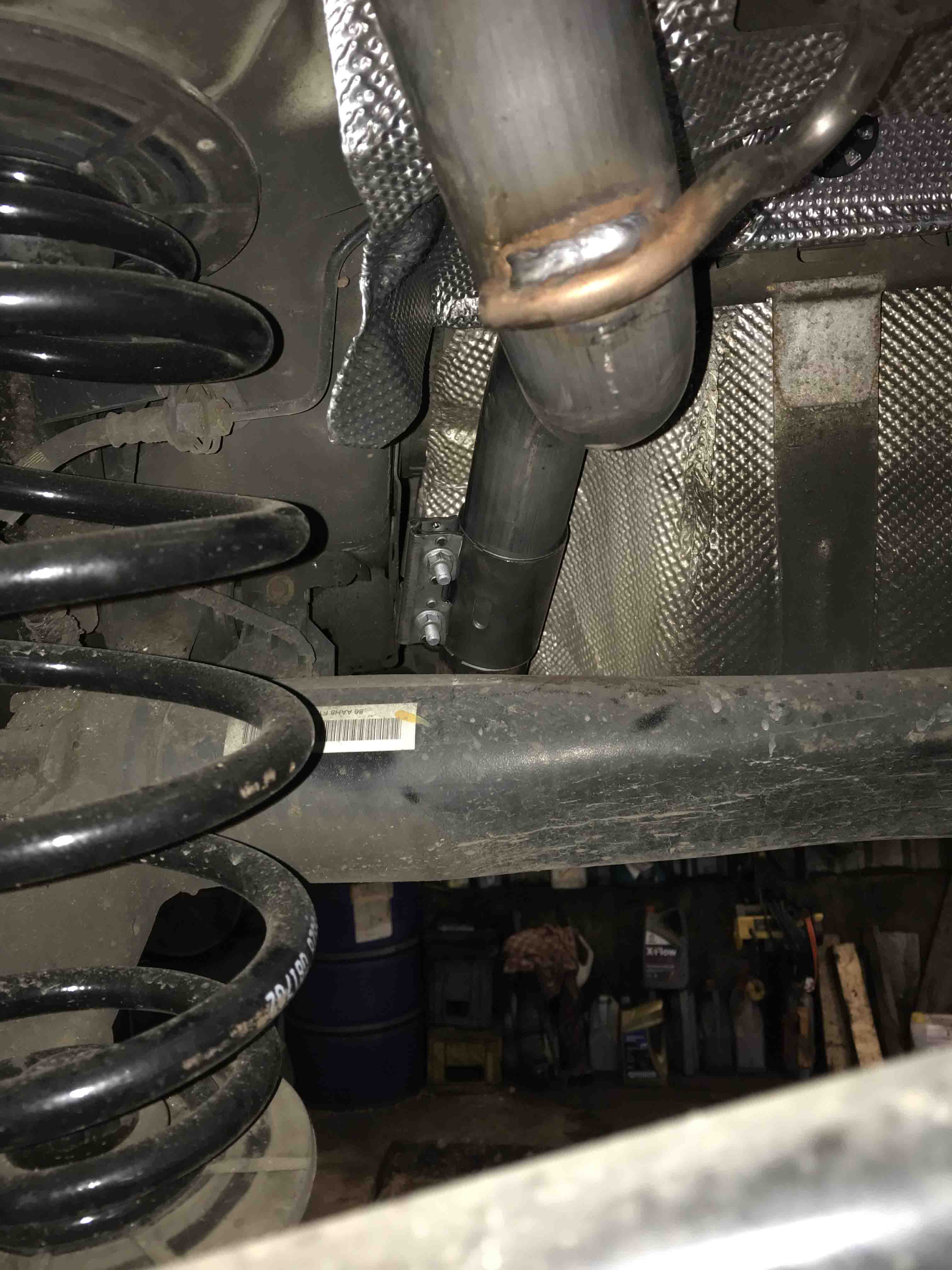

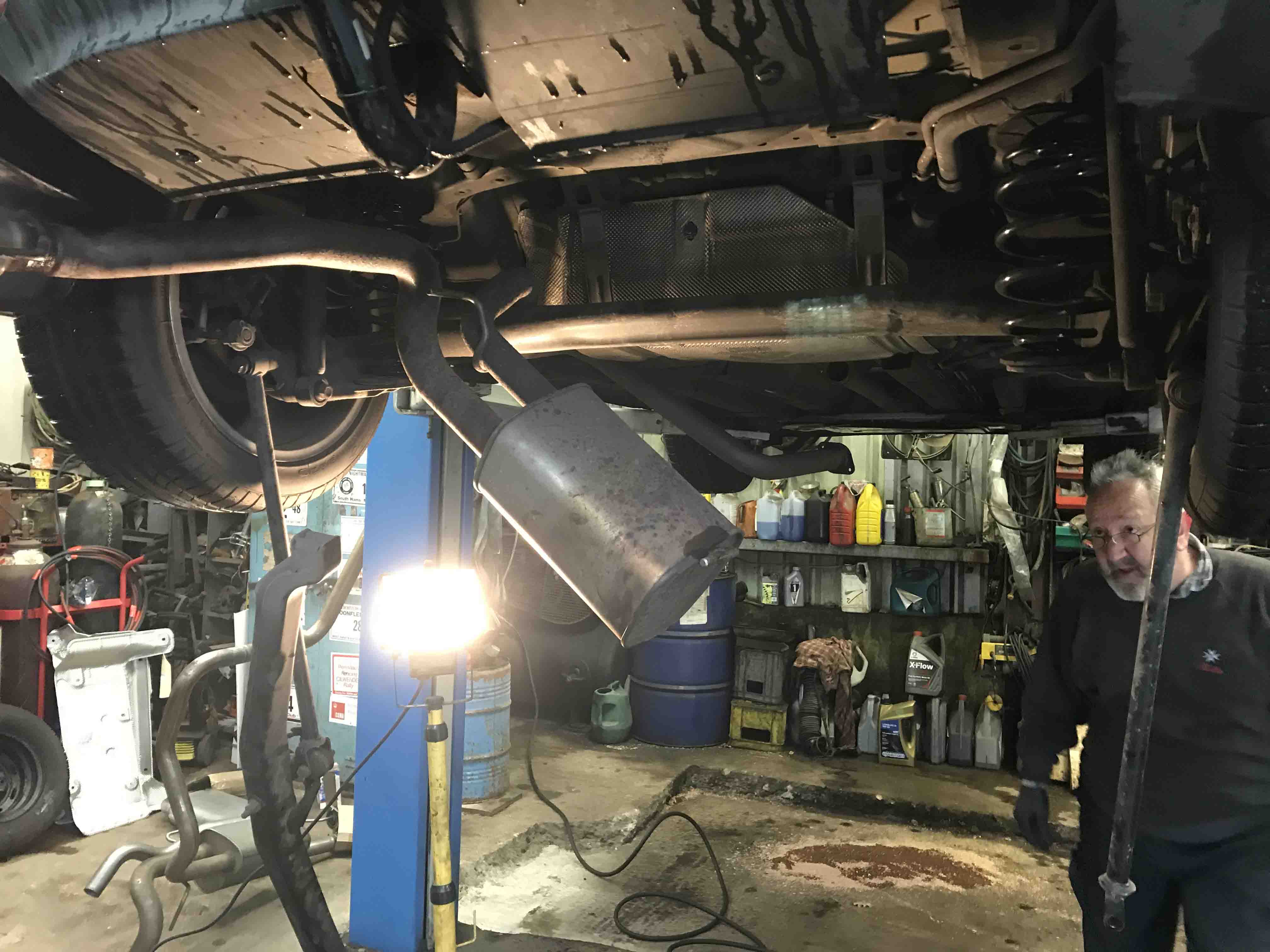

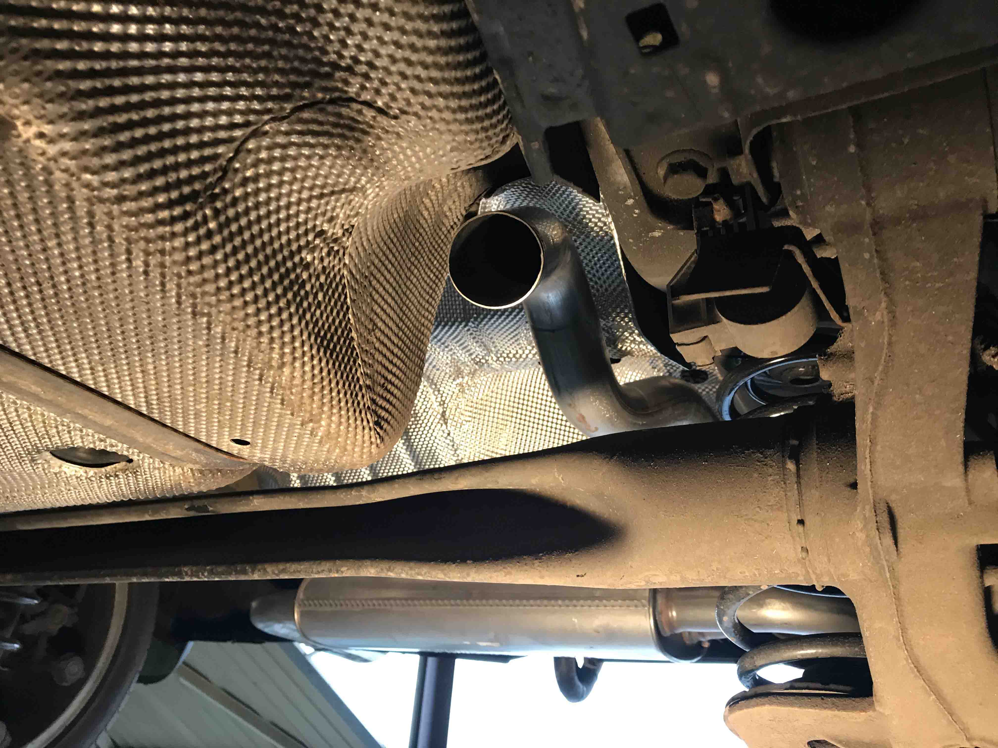

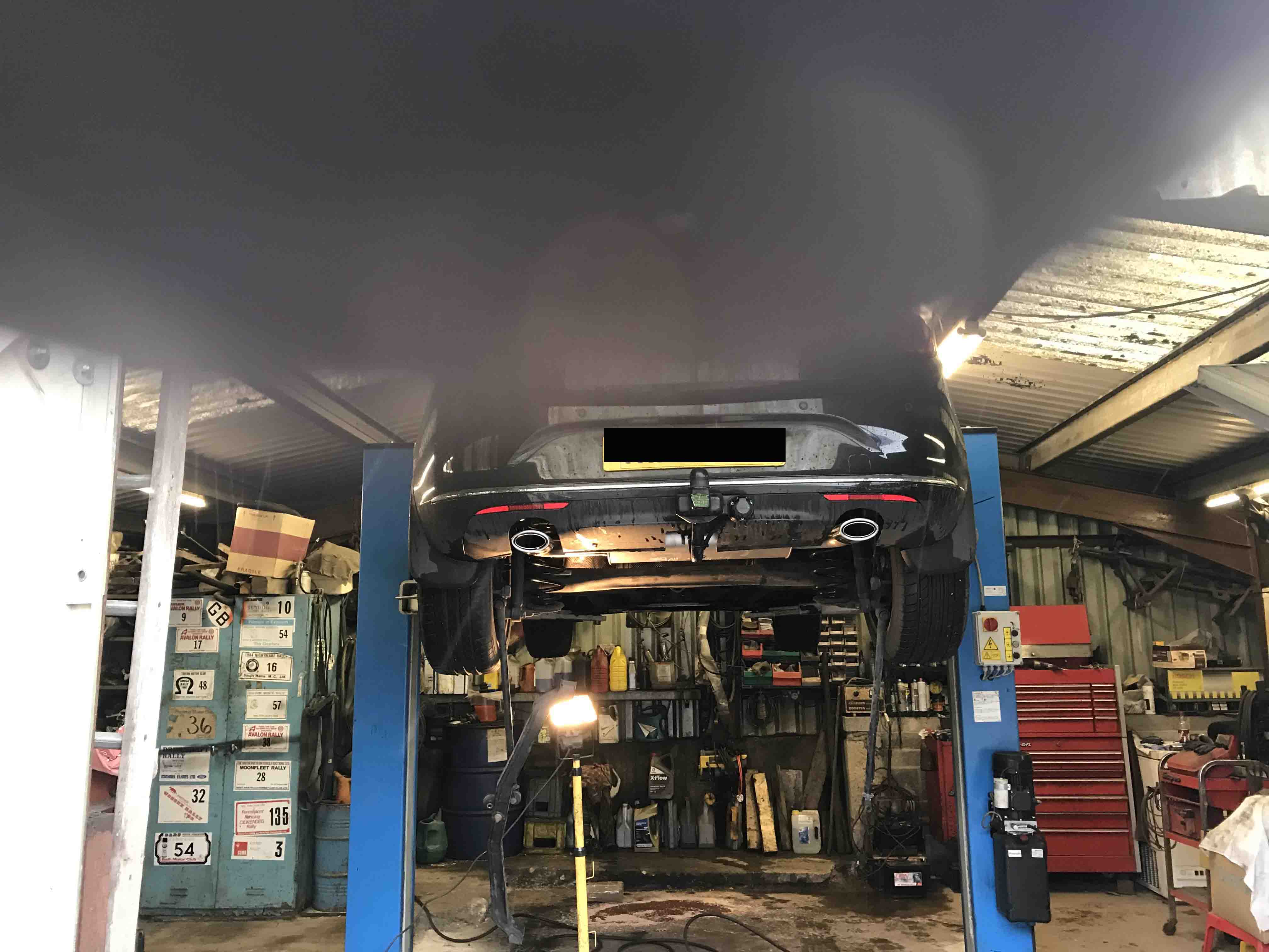

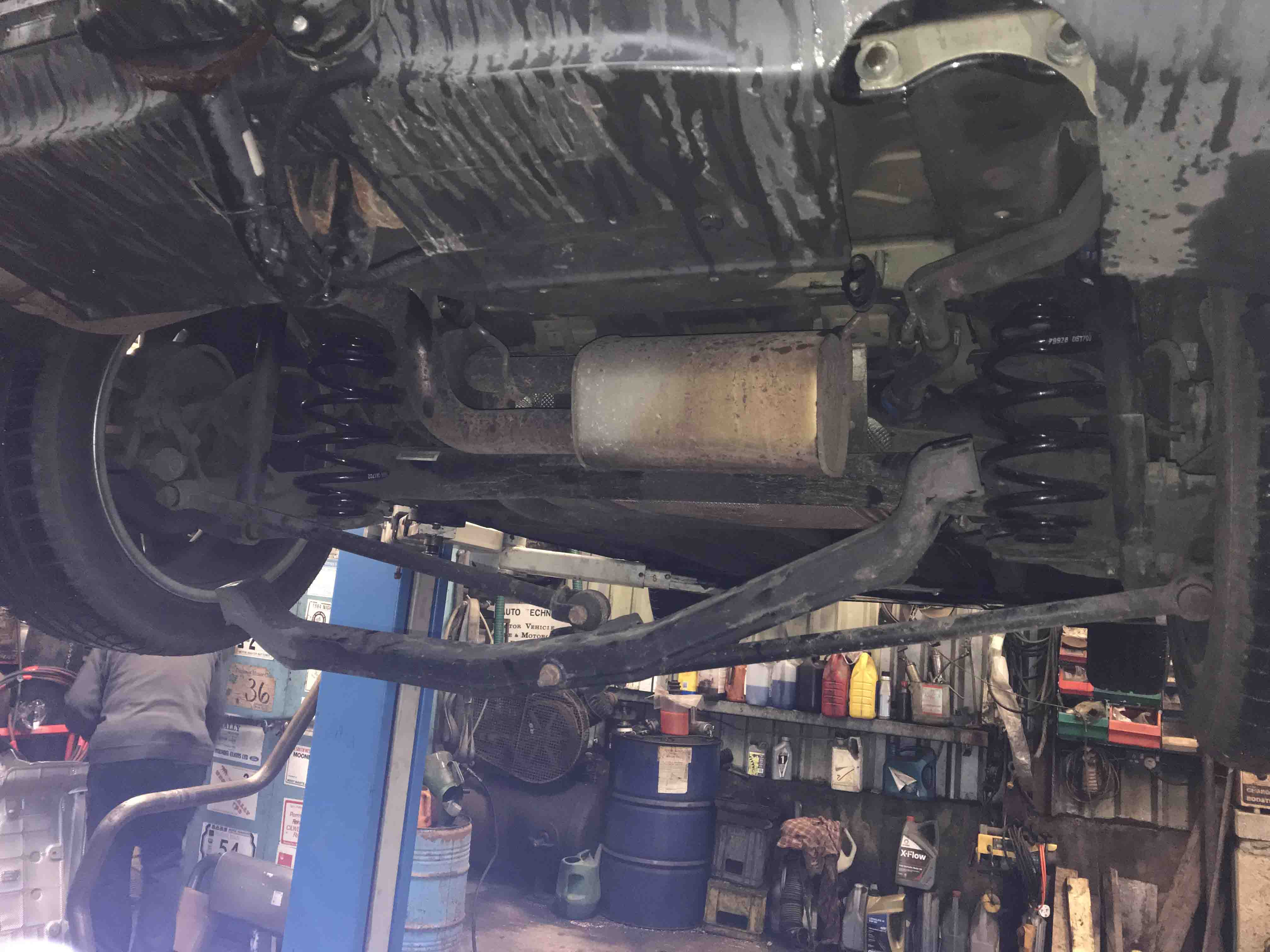

Bi-Turbo exhaust fitted.
Didn't quite go to plan on removing the old exhaust we still had to end up cutting it. But here's the pic's.

For those who want to know the 2.0cdti pipe into the backbox is 55mm & from backbox to tail pipe it's 65mm.

Loving that mate, I want one!!! No I actually think I need one
Think it looks so much better.

looks very good, great upgrade.
big change in sound?
No not really there is a slight difference when up the top end of the rev range (but only very slight)
The car feels different to drive more like it's getting the exhaust gases out quicker.
