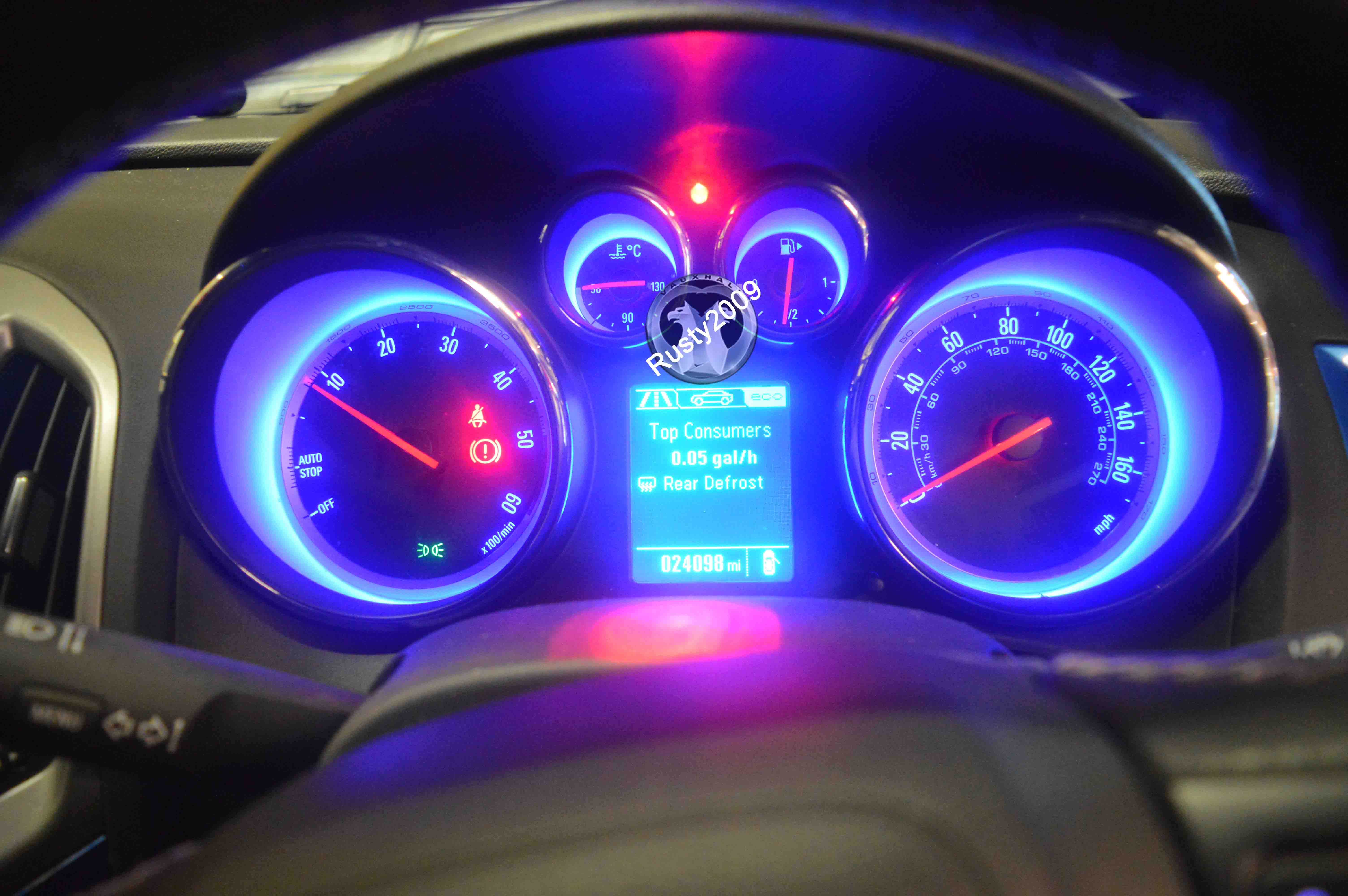

If you have the tap consumer menu it will show rear defrost being on.
[Image: DSC_0222.JPG]
Also you incestuous fuel consumption when ticking over will be 3-4.

see Images of the display of my car and consumer menu, but i dont have the top consumer, i may be wrong, so this is why i am attaching the pictures.
further pictures.
further pictures
