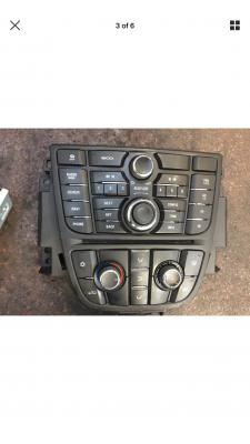

So the fleebay ad stated it was from an Astra so I assumed the fitment wouldn't be an issue, however in hindsight  perhaps I should have done more research. Here's a picture from the ad.
That's a navi600 mate not a cd600 easy fit they are, but you need the SD card port and the USB/AUX plus the storage tray they fit into.
Navi600 fitted and programmed is £260 (no parts supplied other than custom wiring loom).
Ah spot on mate iv got usb and aux in the vehicle already so just the sd card reader to find.
No the USB & AUX on the navi600 is all in one and the USB links into the SD port.
part number you need
13360040 SOCKET, LINE-IN AND USB £34.85
13360041 SOCKET, SD CARD £33.10
95518709 CABLE, USB, 1730MM LONG (NAVI600) (NAVI900) £14.30
13359194 STORAGE COMPARTMENT, CENTRE, LOWER, BLACK (NAVI 600, NAVI 900) £15.10
