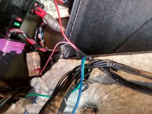

Hi Rusty, just had a look in the nearside pocket in the boot & found the the sensor box!!! Looks like a very tidy job though. Any suggestions??
Just disconnect the box and see what happens.
Cheers Kevin. Yeah tracked down the suspect sensor & see what happens. If not, will disconnect the front end.....not for me...& keep fingers crossed??? Though I still find it odd why the sound when braking in the rain yesterday????
if they are after market they may have taken power from the brake light may be
can you get a pic of the box and as above quote unplug it for now there may just be a duff sensor
Dave can you get a pic of the box?
Rusty2009 Wrote:Dave can you get a pic of the box?
Hi guys hope these are ok????
[ATTACH=CONFIG]126[/ATTACH][ATTACH=CONFIG]127[/ATTACH][ATTACH=CONFIG]128[/ATTACH]
Not sure if done this correctly?
it is an after market job mate they should have taken power for the rear from the reverse light
but for the front where they took the power from is any ones guess
if that has been beeping when the brake is pressed i would say they took the power from the brake lights
you need to trace the wires to were they go to
or replace the sensor that is at fault if it is
the next time you hear this disconnect plug A then plug A back in then plug B and so on this will find the faulty sensor
Yes defo aftermarket mate, I'd echo what Tucpal said trace the power sources and remove each sensor one by one.
TAKING A PUNT IT IS THIS ONE
looks identical.

I've seen a few of these aftermarket units go a little mad. Usually a case of disconnecting them for a few minutes and that fixes them.
