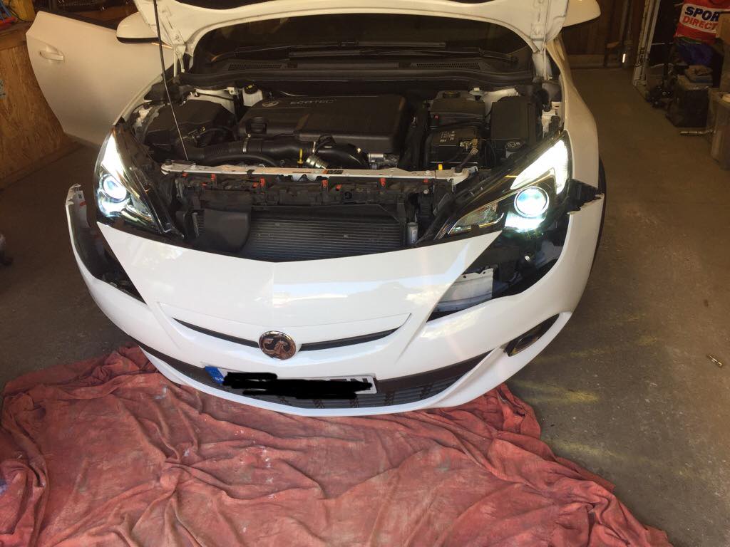

Hi, i want my astra gtc headlights converted to led's so i need a HID kit, i dont no anything about them so i was wondering if anyone had any pictures of them on there gtcs and a link to the kits they got? i have been quoted £96 to fit them but i need to buy the kit myself first, any help would be apprecitated

These were 5000K so white 6000k is white with a hint of blue.
I always advise no higher than 5000k as light output starts to reduce the higher you go.
9012 is the GTC bulb type that's how I know they fit the GTC, most HID kit's say they are for off road use, this is mostly because people fit them in a halogen reflective lamp which scatters the light pattern blinding on-coming drivers.
On the GTC you have projector lamps which is fine for HID's.
