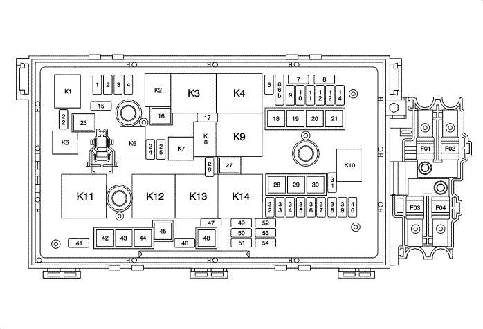

X50A Fuse Block - Underbonnet Label
PLEASE NOTE THAT FUSE RATINGS VARIES ACROSS THE RANGE IT IS YOUR RESPONSIBILITY TO CHECK THE RATING AND REPLACE LIKE FOR LIKE
VXOC WILL NOT BE HELD ACCOUNTABLE FOR ANY DAMAGE CAUSED TO YOUR VEHICLE.
X50A Fuse Block - Underbonnet Label Usage
Underbonnet Fuse Board

[TD]35[/TD]
[TD]35[/TD]
[TD]F35UA Fuse[/TD]
[TD]5A[/TD]
[TD]S52 Outside Rearview Mirror Switch, S79D Window Switch - Driver[/TD]
[/TR]
[TR]
[TD]36[/TD]
[TD]36[/TD]
[TD]-------------[/TD]
[TD]----[/TD]
[TD]Not Used[/TD]
[/TR]
[TR]
[TD]37[/TD]
[TD]37[/TD]
[TD]----[/TD]
[TD]Not Used[/TD]
[/TR]
[TR]
[TD]38[/TD]
[TD]38[/TD]
[TD]F38UA Fuse[/TD]
[TD]20A[/TD]
[TD]KR28 Vacuum Pump Relay (Petrol)[/TD]
[/TR]
[TR]
[TD]39[/TD]
[TD]39[/TD]
[TD]F39UA Fuse[/TD]
[TD]20A[/TD]
[TD]K27 Fuel Pump Flow Control Module (Petrol)[/TD]
[/TR]
[TR]
[TD]40[/TD]
[TD]40[/TD]
[TD]----[/TD]
[TD]Not Used[/TD]
[/TR]
[TR]
[TD]41[/TD]
[TD]41[/TD]
[TD]F41UA Fuse[/TD]
[TD]10A[/TD]
[TD]E13R Headlamp Assembly - Right[/TD]
[/TR]
[TR]
[TD]42[/TD]
[TD]42[/TD]
[TD]F42UA Fuse[/TD]
[TD]40A[/TD]
[TD]KR20C Cooling Fan Low Speed Relay (Petrol), KR20B Cooling Fan
Medium Speed 1 Relay (Diesel)[/TD]
[/TR]
[TR]
[TD]43[/TD]
[TD]43[/TD]
[TD]F43UA Fuse[/TD]
[TD]30A[/TD]
[TD]M75 Windscreen Wiper Motor[/TD]
[/TR]
[TR]
[TD]44[/TD]
[TD]44[/TD]
[TD]----[/TD]
[TD]Not Used[/TD]
[/TR]
[TR]
[TD]45[/TD]
[TD]45[/TD]
[TD]F45UA Fuse[/TD]
[TD]30A[/TD]
[TD]G10 Cooling Fan Motor (Petrol)[/TD]
[/TR]
[TR]
[TD]46[/TD]
[TD]46[/TD]
[TD]----[/TD]
[TD]Not Used[/TD]
[/TR]
[TR]
[TD]47[/TD]
[TD]47[/TD]
[TD]F47UA Fuse[/TD]
[TD]15A[/TD]
[TD]P12 Horn[/TD]
[/TR]
[TR]
[TD]48[/TD]
[TD]48[/TD]
[TD]F48UA Fuse[/TD]
[TD]60A[/TD]
[TD]KR20B Cooling Fan Medium Speed 1 Relay, KR20C Cooling Fan Low
Speed Relay, KR20D Cooling Fan High Speed Relay[/TD]
[/TR]
[TR]
[TD]49[/TD]
[TD]49[/TD]
[TD]----[/TD]
[TD]Not Used[/TD]
[/TR]
[TR]
[TD]50[/TD]
[TD]50[/TD]
[TD]F50UA Fuse[/TD]
[TD]10A[/TD]
[TD]S30 Headlamp Switch, M29L Headlamp Levelling Actuator - Left, M29R
Headlamp Levelling Actuator - Right[/TD]
[/TR]
[TR]
[TD]51[/TD]
[TD]51[/TD]
[TD]----[/TD]
[TD]Not Used[/TD]
[/TR]
[TR]
[TD]52[/TD]
[TD]52[/TD]
[TD]F52UA Fuse[/TD]
[TD]7.5A[/TD]
[TD]Not Used[/TD]
[/TR]
[TR]
[TD]53[/TD]
[TD]53[/TD]
[TD]F53UA Fuse[/TD]
[TD]7.5A[/TD]
[TD]K20 Engine Control Module (ECM), K34 Glow Plug Control Module
(GPCM) (Diesel), K71 Transmission Control Module (A/T)[/TD]
[/TR]
[TR]
[TD]54[/TD]
[TD]54[/TD]
[TD]F54UA Fuse[/TD]
[TD]7.5A[/TD]
[TD]B19C Brake Servo Vacuum Switch, K27 Fuel Pump Control Module,
B116 Water in Fuel Sensor, E40 Electrical Auxiliary Heater, K33 HVAC
Control Module, P16 Instrument Cluster, B108 Air Quality Sensor, B19C
Brake Servo Vacuum Switch, B75B Mass Air Flow/Intake Air
Temperature Sensor, T19 Power Supply Transformer (KL9)[/TD]
[/TR]
[TR]
[TD]F01[/TD]
[TD]--[/TD]
[TD]F01UA Fuse[/TD]
[TD]80A[/TD]
[TD]K34 Glow Plug Control Module (Diesel)[/TD]
[/TR]
[TR]
[TD]F02[/TD]
[TD]--[/TD]
[TD]F02UA Fuse[/TD]
[TD]80A[/TD]
[TD]K43 Power Steering Control Module[/TD]
[/TR]
[TR]
[TD]F03[/TD]
[TD]--[/TD]
[TD]F03UA Fuse[/TD]
[TD]100A[/TD]
[TD]E40 Electrical Auxiliary Heater[/TD]
[/TR]
[TR]
[TD]F04[/TD]
[TD]--[/TD]
[TD]F04UA Fuse[/TD]
[TD]80A[/TD]
[TD]G10 Cooling Fan Motor[/TD]
[/TR]
[TR]
[TD]K01[/TD]
[TD]1[/TD]
[TD]SPARE[/TD]
[TD]----[/TD]
[TD]------------------[/TD]
[/TR]
[TR]
[TD]K02[/TD]
[TD]2[/TD]
[TD]KR27 Starter Relay[/TD]
[TD]----[/TD]
[TD]M64 Starter Motor[/TD]
[/TR]
[TR]
[TD]K03[/TD]
[TD]3[/TD]
[TD]KR75 Powertrain
Relay[/TD]
[TD]----[/TD]
[TD]KR29 A/C Compressor Clutch Relay, Fuses F1UA, F2UAF3UA, F4UA,
F7UA, F8UA[/TD]
[/TR]
[TR]
[TD]K04[/TD]
[TD]4[/TD]
[TD]KR5 Rear Window
Demister Relay[/TD]
[TD]----[/TD]
[TD]Fuses F6UA, F9UA, F18UA[/TD]
[/TR]
[TR]
[TD]K05[/TD]
[TD]5[/TD]
[TD]KR2 Headlamp
Washer Fluid Pump
Relay[/TD]
[TD]----[/TD]
[TD]G16 Headlamp Washer Fluid Pump[/TD]
[/TR]
[TR]
[TD]K06[/TD]
[TD]6[/TD]
[TD]KR42L Daytime Running
Lamp Relay- Left
OR
KR49 Headlamp Low
Beam Relay[/TD]
[TD]----[/TD]
[TD]E13L Headlamp Assembly - Left (T4A)
OR
Fuses F24UA, F25UA (T4F)[/TD]
[/TR]
[TR]
[TD]K07[/TD]
[TD]7[/TD]
[TD]KR23A Fuel Pump
Relay[/TD]
[TD]----[/TD]
[TD]G12 Fuel Pump[/TD]
[/TR]
[TR]
[TD]K08[/TD]
[TD]8[/TD]
[TD]KR42R Daytime
Running Lamp Relay
- Right[/TD]
[TD]----[/TD]
[TD]E13R Headlamp Assembly - Right (T4A)[/TD]
[/TR]
[TR]
[TD]K09[/TD]
[TD]9[/TD]
[TD]KR22 Fuel Heater
Relay[/TD]
[TD]----[/TD]
[TD]E11 Fuel Heater (Diesel)[/TD]
[/TR]
[TR]
[TD]K10[/TD]
[TD]10[/TD]
[TD]SPARE[/TD]
[TD]----[/TD]
[TD]--------------------[/TD]
[/TR]
[TR]
[TD]K11[/TD]
[TD]11[/TD]
Low Speed Relay[/TD]
[TD]----[/TD]
[/TR]
[TR]
[TD]K12[/TD]
[TD]12[/TD]
[TD]KR20D Cooling Fan
[TD]----[/TD]
[/TR]
[TR]
[TD]K13[/TD]
[TD]13[/TD]
[TD]KR20A Cooling Fan
Medium Speed 1
Relay[/TD]
[TD]----[/TD]
[TD]G10 Cooling Fan Motor, Fuse F45UA[/TD]
[/TR]
[TR]
[TD]K14[/TD]
[TD]14[/TD]
[TD]KR73 Ignition Main
Relay[/TD]
[TD]----[/TD]
[TD]Fuses F32UA, F33UA, F49UA, F50UA, F51UA, F52UA, F53UA, F54UA[/TD]
[/TR]
Important: Relays listed below are non-serviceable Printed Circuit Board (PCB) relays and are internal to the block.
Relays
[TR]
[TD]----[/TD]
[TD]----[/TD]
[TD]KR3 Horn Relay[/TD]
[TD]----[/TD]
[TD]Fuse F47UA[/TD]
[/TR]
[TR]
[TD]----[/TD]
[TD]----[/TD]
[TD]KR6 Rear Window
Washer Pump Relay[/TD]
[TD]----[/TD]
[TD]G24 Windscreen Washer Pump[/TD]
[/TR]
[TR]
[TD]----[/TD]
[TD]----[/TD]
[TD]KR7 Rear Window
Wiper Relay[/TD]
[TD]----[/TD]
[TD]M45 Rear Wiper Motor[/TD]
[/TR]
[TR]
[TD]----[/TD]
[TD]----[/TD]
[TD]KR11 Windscreen
[TD]----[/TD]
[/TR]
[TR]
[TD]----[/TD]
[TD]----[/TD]
[TD]KR29 A/C
Compressor Clutch
Relay[/TD]
[TD]----[/TD]
[TD]Q2 A/C Compressor Clutch[/TD]
[/TR]
[TR]
[TD]----[/TD]
[TD]----[/TD]
[TD]KR46 Front Fog
Lamp Relay[/TD]
[TD]----[/TD]
[TD]Fuse F26UA[/TD]
[/TR]
[TR]
[TD]----[/TD]
[TD]----[/TD]
[TD]KR48 Headlamp
High Beam Relay[/TD]
[TD]----[/TD]
[TD]Fuses F22UA, F41UA[/TD]
[/TR]
[TR]
[TD]----[/TD]
[TD]----[/TD]
[TD]KR94 Fuel Door
Release Actuator
Relay[/TD]
[TD]----[/TD]
[TD]M27 Fuel Door Unlatch Actuator[/TD]
[/TR]
[TR]
[TD]----[/TD]
[TD]----[/TD]
[TD]KR95A Tailgate
Release Relay[/TD]
[TD]----[/TD]
[TD]Fuse F11UA[/TD]
[/TR]

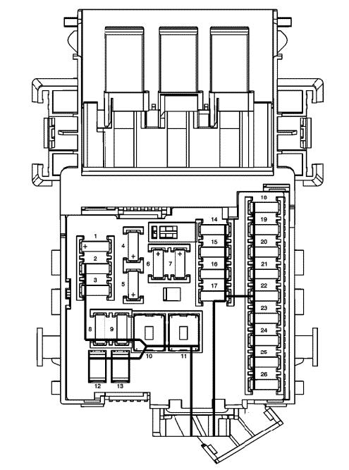

X51A Fuse Block - Instrument Panel Top View Fuses
Tip
Instrument Panel Fuse Blocks in vehicles built between 18-May-2010 and 29-June-2010 may have mixed up
fuse numbers on the block for fuses 15, 16, and 17. The numbering in the above graphic is correct for all
model year 2010 vehicles and should be used when trying to find the correct position of fuses 15, 16, or 17.
X51A Fuse Block - Instrument Panel Usage Fuses
Fuse Block Instrument Panel
[TR]
[TD]No.[/TD]
[TD]Device Label Name[/TD]
[TD]Device Assigned Name[/TD]
[TD]Rating[/TD]
[TD]Description[/TD]
[/TR]
[TR]
[TD]1[/TD]
[TD]----[/TD]
[TD]F1DA Fuse[/TD]
[TD]10A[/TD]
[TD]A22 Radio Control, K33 Driver Information Centre (DIC) Display[/TD]
[/TR]
[TR]
[TD]2[/TD]
[TD]----[/TD]
[TD]F2DA Fuse[/TD]
[TD]20A[/TD]
[TD]K9 Body Control Module[/TD]
[/TR]
[TR]
[TD]3[/TD]
[TD]----[/TD]
[TD]F3DA Fuse[/TD]
[TD]25A[/TD]
[/TR]
[TR]
[TD]4[/TD]
[TD]----[/TD]
[TD]F4DA Fuse[/TD]
[TD]20A[/TD]
[TD]A11 Radio, P5 Chime Alarm Control Module[/TD]
[/TR]
[TR]
[TD]5[/TD]
[TD]----[/TD]
[TD]F5DA Fuse[/TD]
[TD]7.5A[/TD]
[TD]A12 Digital Radio Receiver Control Module, K82 Mobile Telephone Control Module, T11 Multimedia Player Interface Module
[/TD]
[/TR]
[TR]
[TD]6[/TD]
[TD]----[/TD]
[TD]F6DA Fuse[/TD]
[TD]20A[/TD]
[TD]X80G Accessory Power Receptacle - Instrument Panel[/TD]
[/TR]
[TR]
[TD]7[/TD]
[TD]----[/TD]
[TD]F7DA Fuse[/TD]
[TD]20A[/TD]
[/TR]
[TR]
[TD]8[/TD]
[TD]----[/TD]
[TD]F8DA Fuse[/TD]
[TD]30A[/TD]
[/TR]
[TR]
[TD]9[/TD]
[TD]----[/TD]
[TD]F9DA Fuse[/TD]
[TD]30A[/TD]
[/TR]
[TR]
[TD]10[/TD]
[TD]----[/TD]
[TD]F10DA Fuse[/TD]
[TD]30A[/TD]
[/TR]
[TR]
[TD]11[/TD]
[TD]----[/TD]
[TD]F11DA Fuse[/TD]
[TD]40A[/TD]
[TD]K8 Blower Motor Control Module[/TD]
[/TR]
[TR]
[TD]12[/TD]
[TD]----[/TD]
[TD]F12DA Circuit Breaker[/TD]
[TD]25A[/TD]
[TD]64D Seat Adjuster Switch - Driver, S65D Seat Lumbar Support Switch - Driver[/TD]
[/TR]
[TR]
[TD]13[/TD]
[TD]----[/TD]
[TD]----[/TD]
[TD]----[/TD]
[TD]Not Used[/TD]
[/TR]
[TR]
[TD]14[/TD]
[TD]----[/TD]
[TD]F14DA Fuse[/TD]
[TD]7.5A[/TD]
[TD]X84 Data Link Connector[/TD]
[/TR]
[TR]
[TD]15[/TD]
[TD]----[/TD]
[TD]F15DA Fuse[/TD]
[TD]7.5A[/TD]
[TD]K36 Inflatable Restraint Sensing and Diagnostic Module[/TD]
[/TR]
[TR]
[TD]16[/TD]
[TD]----[/TD]
[TD]----[/TD]
[TD]----[/TD]
[TD]Not Used[/TD]
[/TR]
[TR]
[TD]17[/TD]
[TD]----[/TD]
[TD]F17DA Fuse[/TD]
[TD]10A[/TD]
[TD]A26 HVAC Control, K33 HVAC Control Module[/TD]
[/TR]
[TR]
[TD]18[/TD]
[TD]----[/TD]
[TD]F18DA Fuse[/TD]
[TD]30A[/TD]
[TD]KR104A Logistic Mode Relay 1[/TD]
[/TR]
[TR]
[TD]19[/TD]
[TD]----[/TD]
[TD]F19DA Fuse[/TD]
[TD]20A[/TD]
[/TR]
[TR]
[TD]20[/TD]
[TD]----[/TD]
[TD]F20DA Fuse[/TD]
[TD]5A[/TD]
[TD]K85 Passenger Presence Detection Module[/TD]
[/TR]
[TR]
[TD]21[/TD]
[TD]----[/TD]
[TD]F21DA Fuse[/TD]
[TD]10A[/TD]
[TD]P16 Instrument Cluster[/TD]
[/TR]
[TR]
[TD]22[/TD]
[TD]----[/TD]
[TD]F22DA Fuse[/TD]
[TD]5A[/TD]
[TD]S39 Ignition Switch[/TD]
[/TR]
[TR]
[TD]23[/TD]
[TD]----[/TD]
[TD]F23DA Fuse[/TD]
[TD]20A[/TD]
[/TR]
[TR]
[TD]24[/TD]
[TD]----[/TD]
[TD]F24DA Fuse[/TD]
[TD]20A[/TD]
[/TR]
[TR]
[TD]25[/TD]
[TD]----[/TD]
[TD]----[/TD]
[TD]----[/TD]
[TD]Not Used[/TD]
[/TR]
[TR]
[TD]26[/TD]
[TD]----[/TD]
[TD]F26DA Fuse[/TD]
[TD]20A[/TD]
[TD]Not Used[/TD]
[/TR]
[TR]
[TD]K1[/TD]
[TD]----[/TD]
[TD]----[/TD]
[TD]----[/TD]
[TD]Not Used[/TD]
[/TR]
[TR]
[TD]K2[/TD]
[TD]----[/TD]
[TD]Logistic Mode Relay 1 KR104A[/TD]
[TD][/TD]
[TD]F1DA, F4DA, F5DA[/TD]
[/TR]
[TR]
[TD]K3[/TD]
[TD]----[/TD]
[TD]Auxiliary Power Relay KR70[/TD]
[TD][/TD]
[TD]F6DA, F7DA[/TD]
[/TR]
