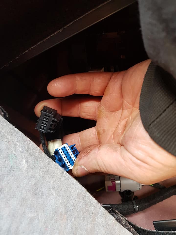

Considering the Cascada is really an Astra you would be looking at the same as the Astra. Body wiring will be there for the mirrors but door wiring will be missing.
In terms of front parking sensors look in the boot (by the rear fuse board location and see if there is a blue plug lose in there (I'm assuming you already have rear sensors?) if you have the blue plug the front parking sensor wiring will run to a connector under the battery.
In terms of which sensors my advise is use only genuine sensor's the amount of times I've had customers supply aftermarket sensors which don't work & I've then had to replace them for genuine one's.
[Image: Parking%20sensors%20plugs..jpg]

Hi rusty thanks for your assistance with this i will look in the boot for the blue plug and take it from there.
