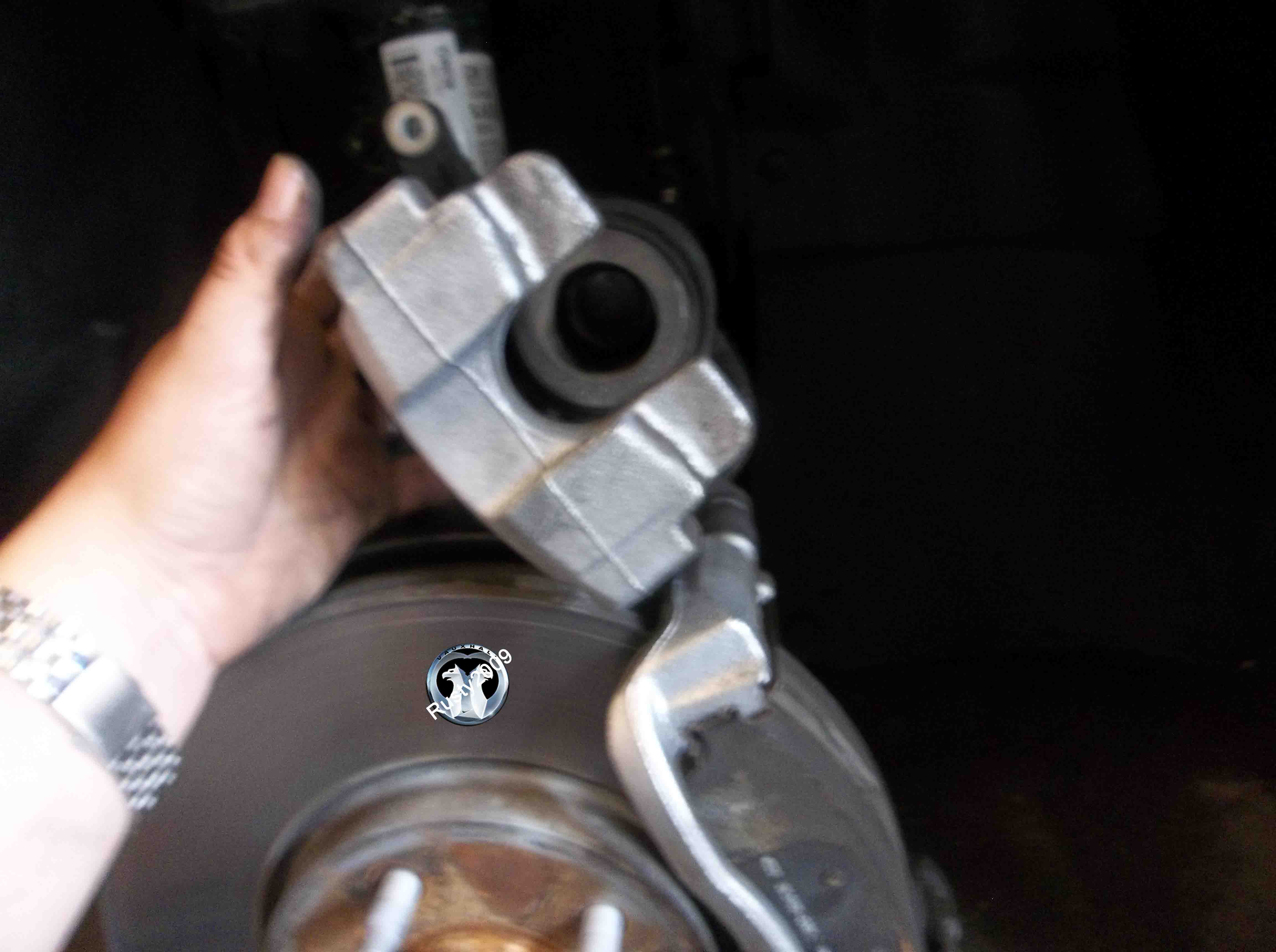

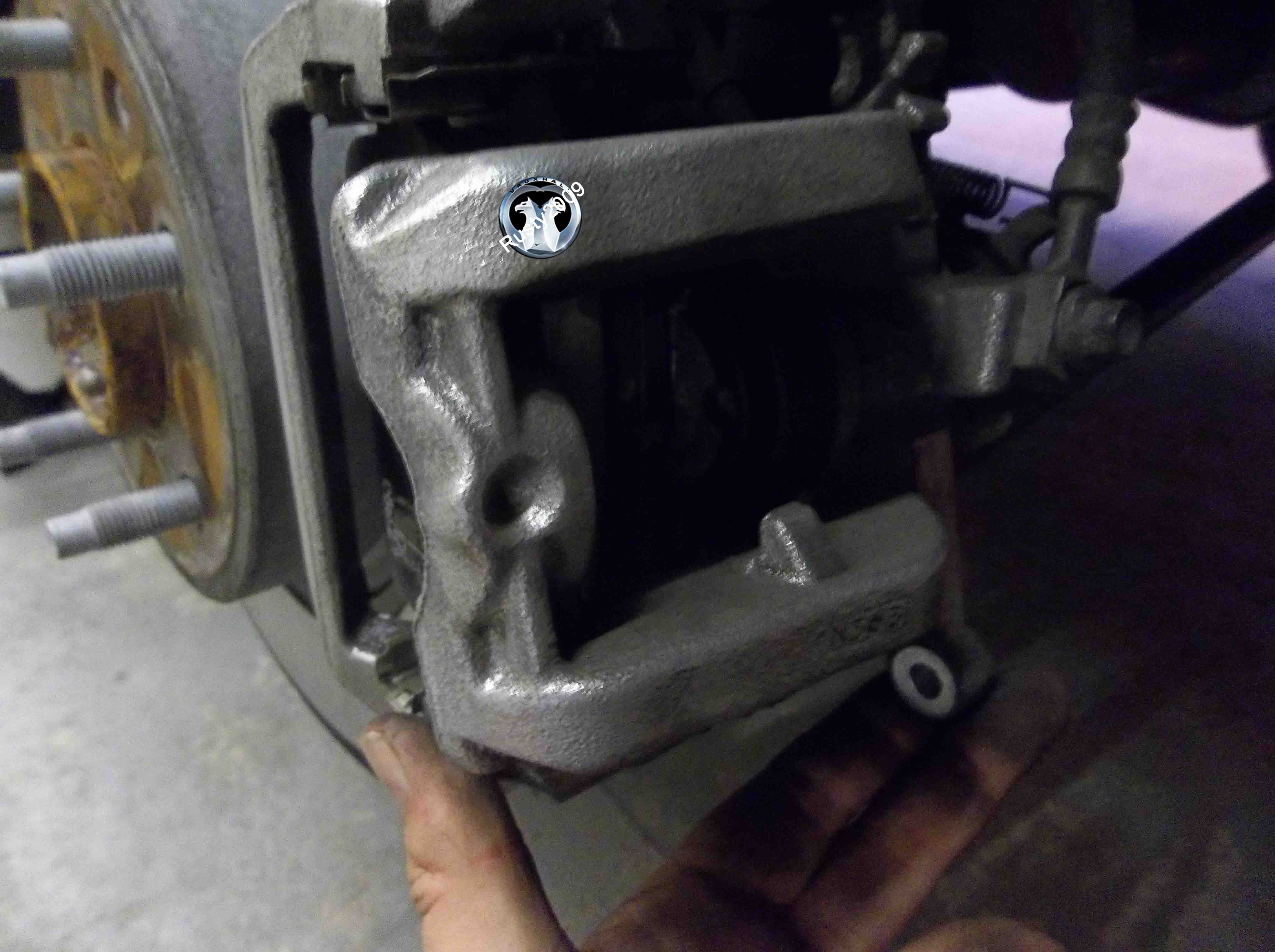

Jack up and remove wheel from the car to gain access to brake.

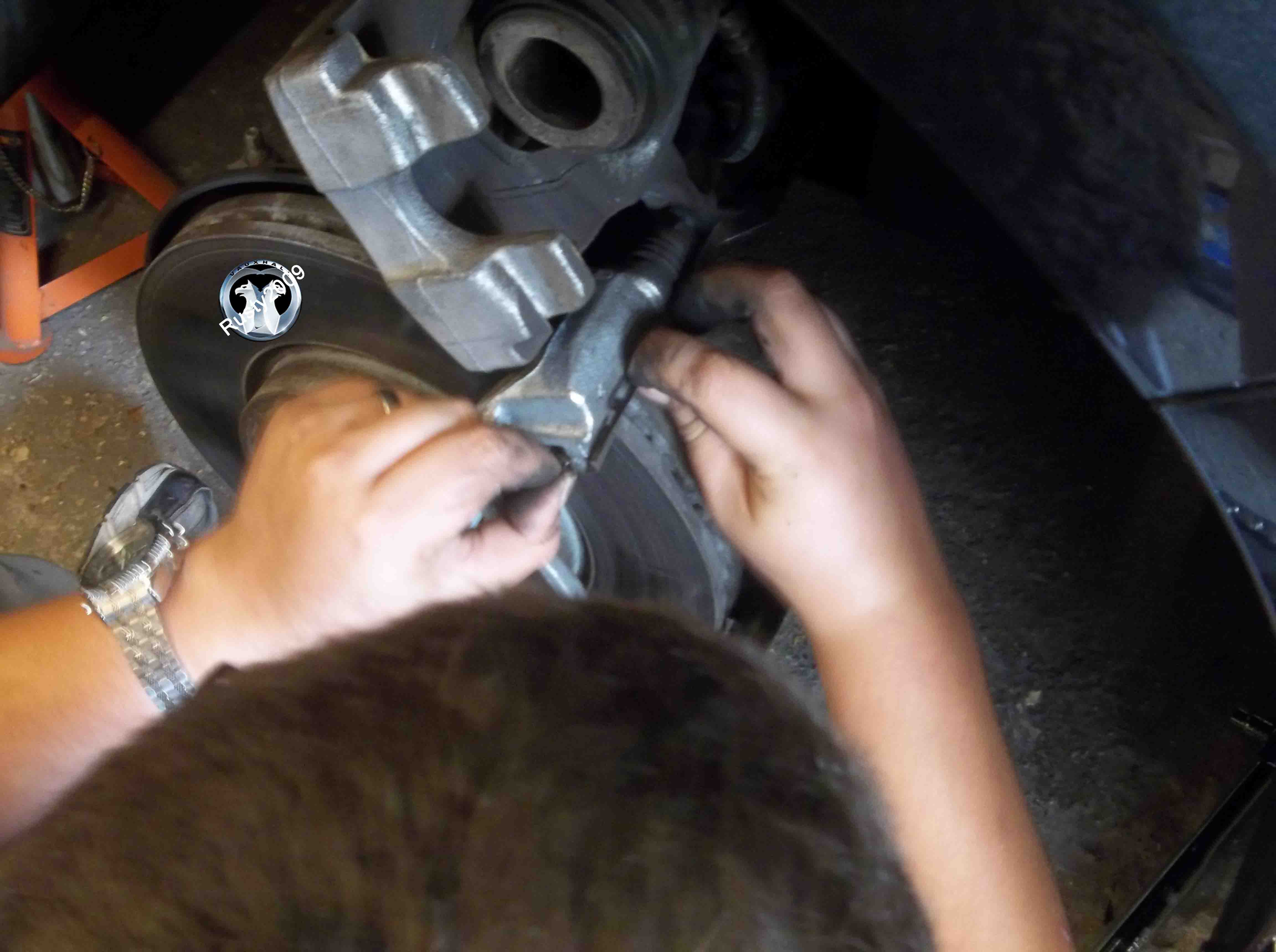

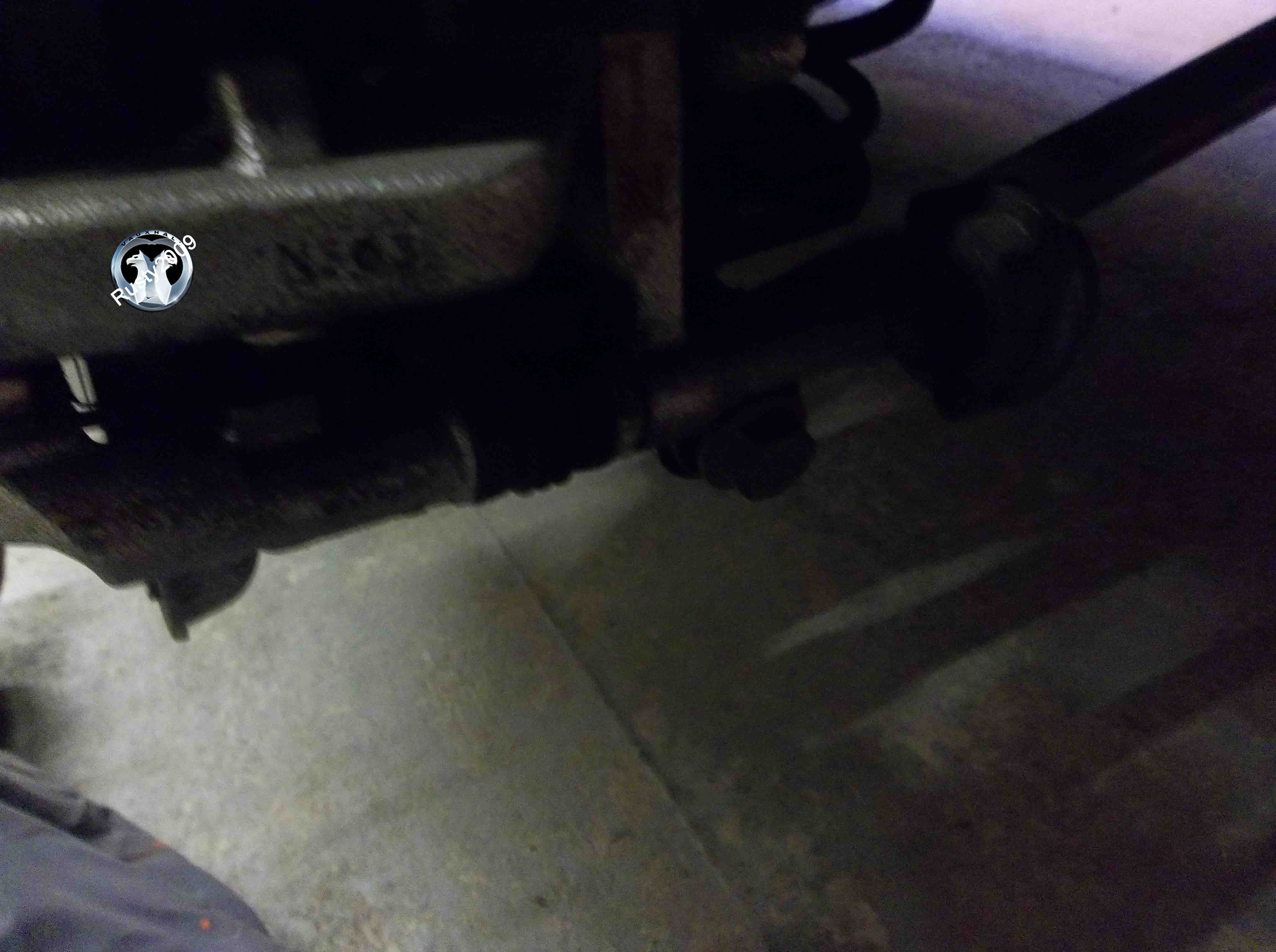

Next take out the guide bolt from the bottom 10mm
you may need to slacken the top guide bolt no need to fully remove it
then pull the housing out and up
Tie the housing to something (although I didn't)

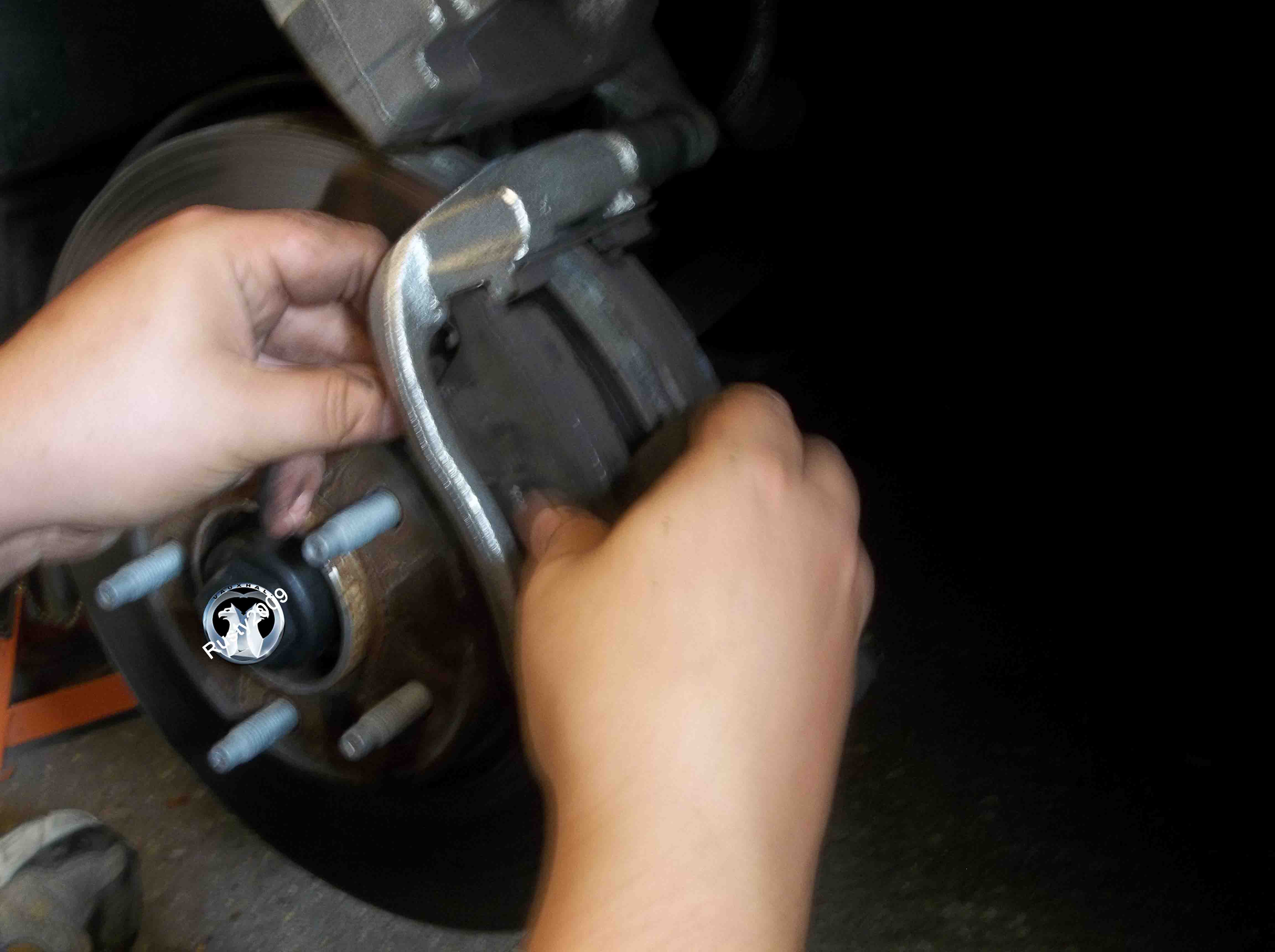

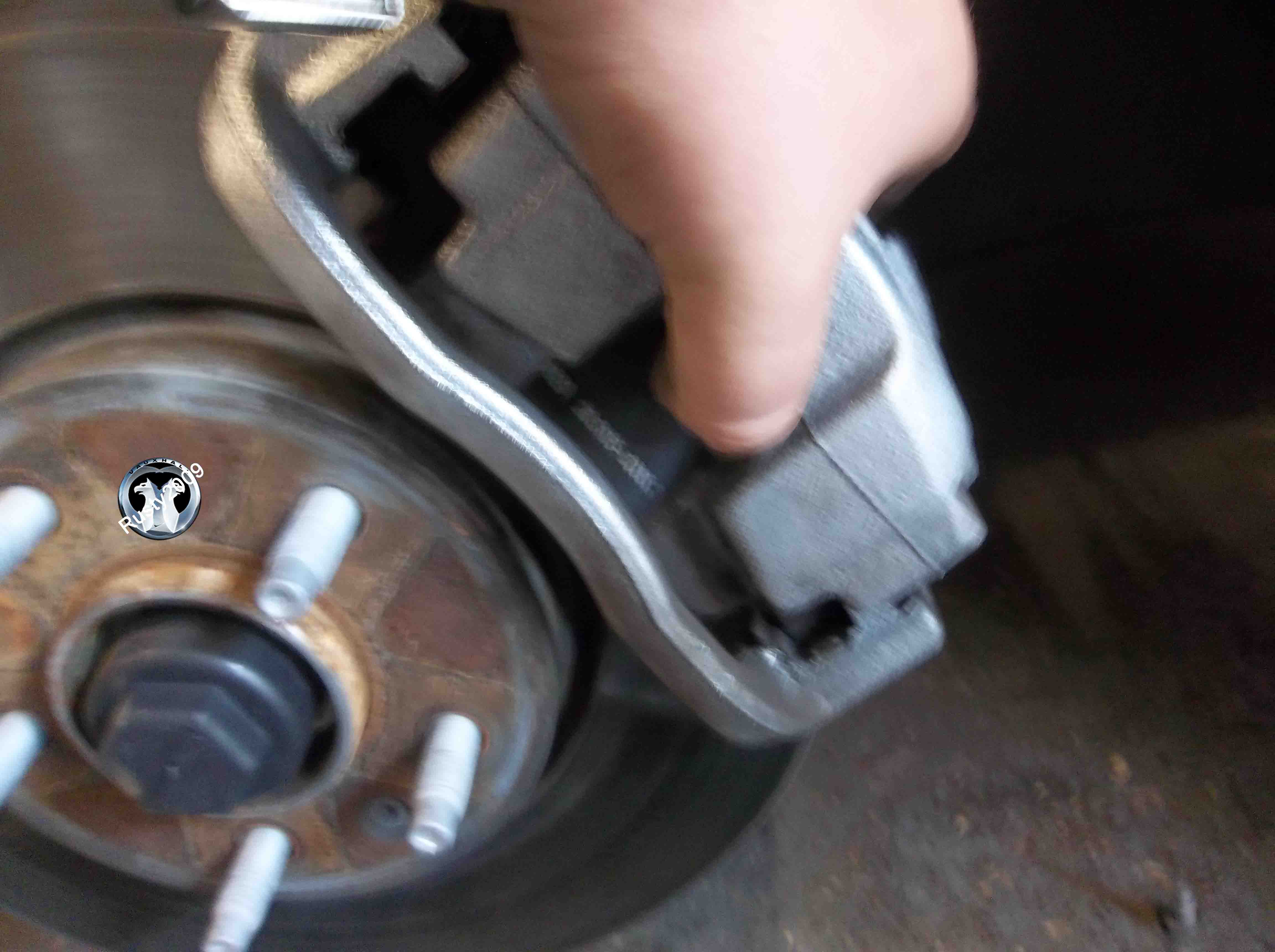

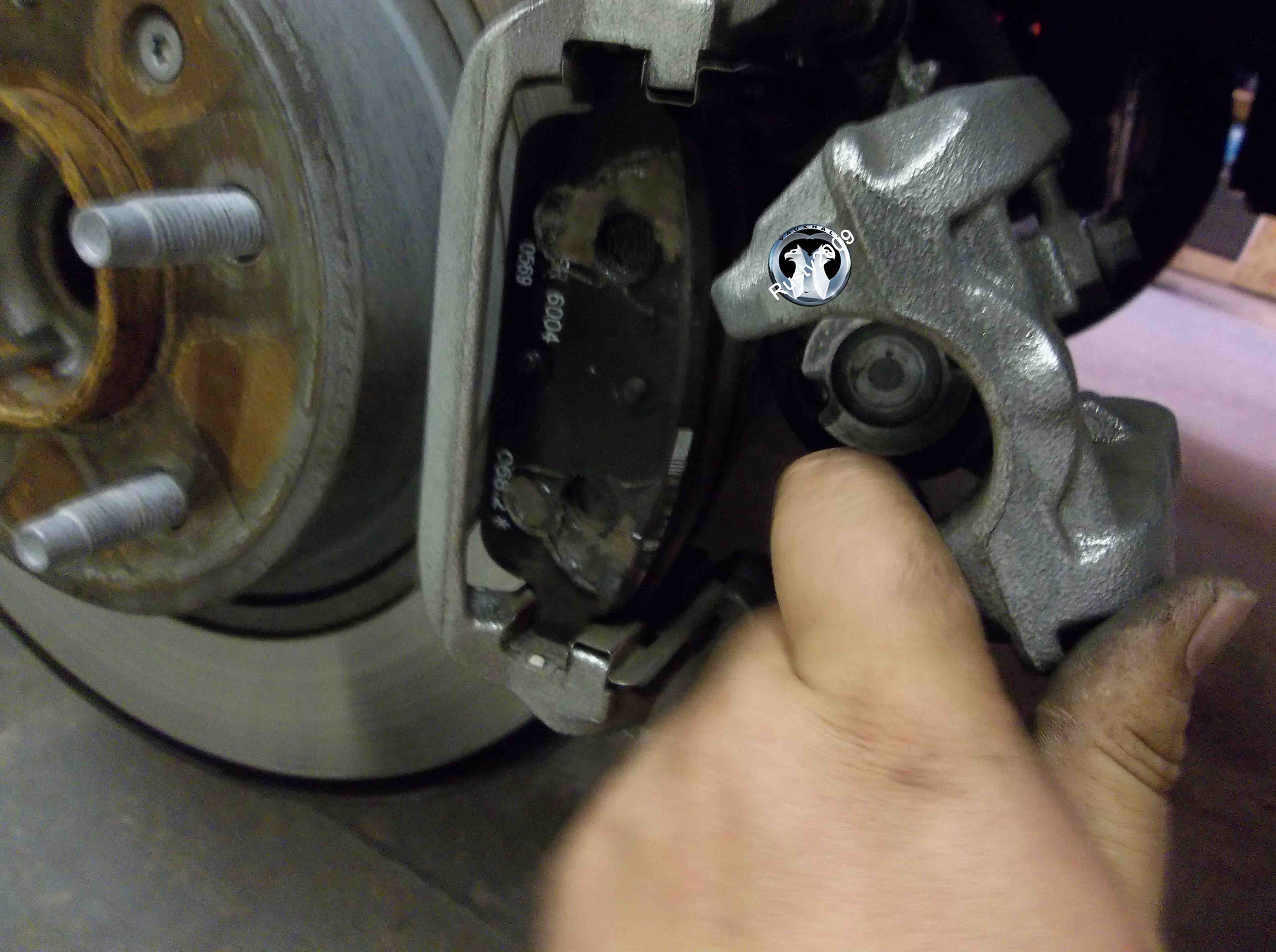

To remove the brake pad just pull it out towards you the back one pulls out away from you
remove the brake pad retaining springs they just pull down or up (give them a clean).
Refitting is the reversal of removal the guide bolts need to be torqued up to 28 N.M (21 lb ft).

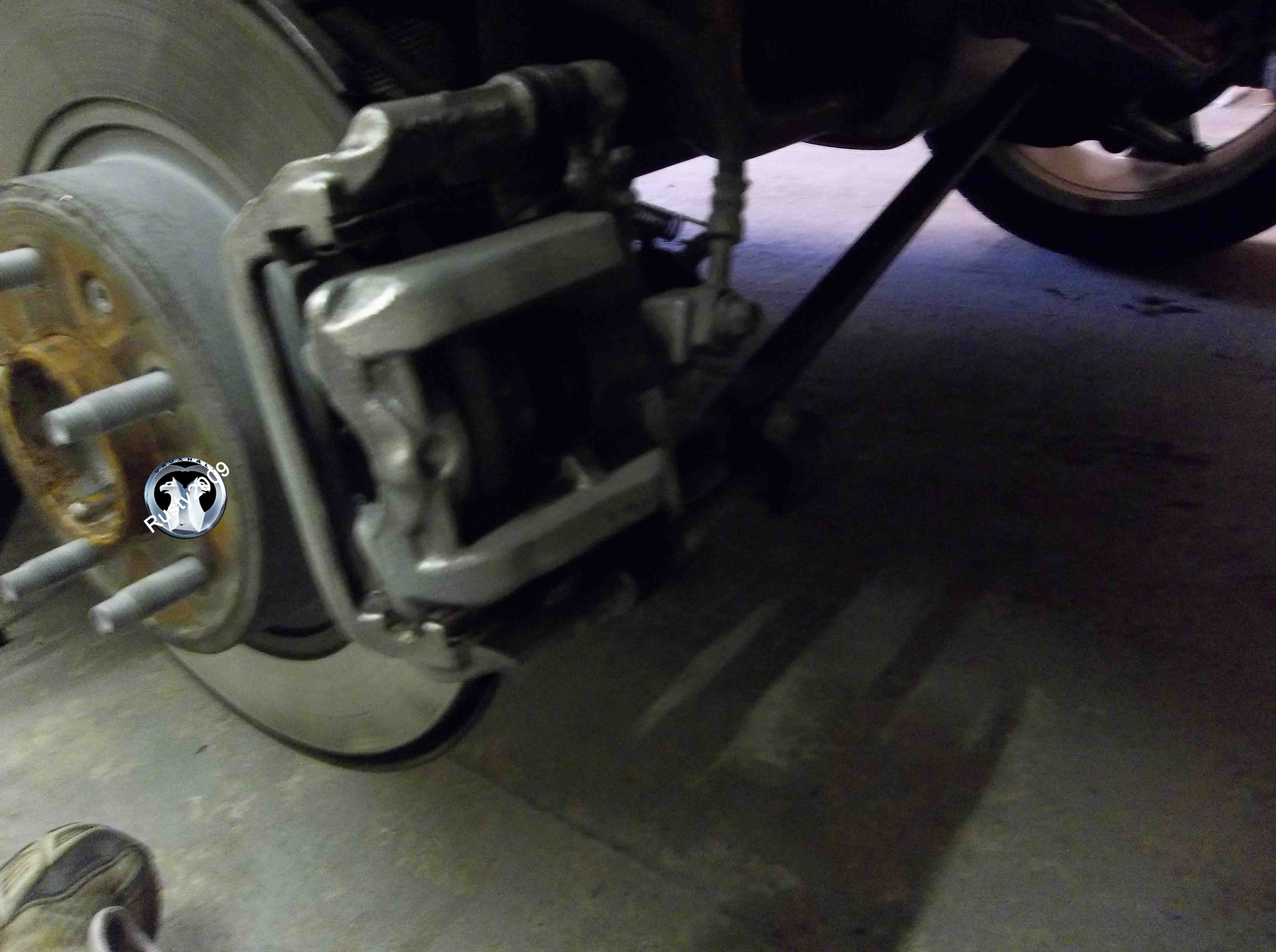

Now for the rear
again jack up and remove wheel

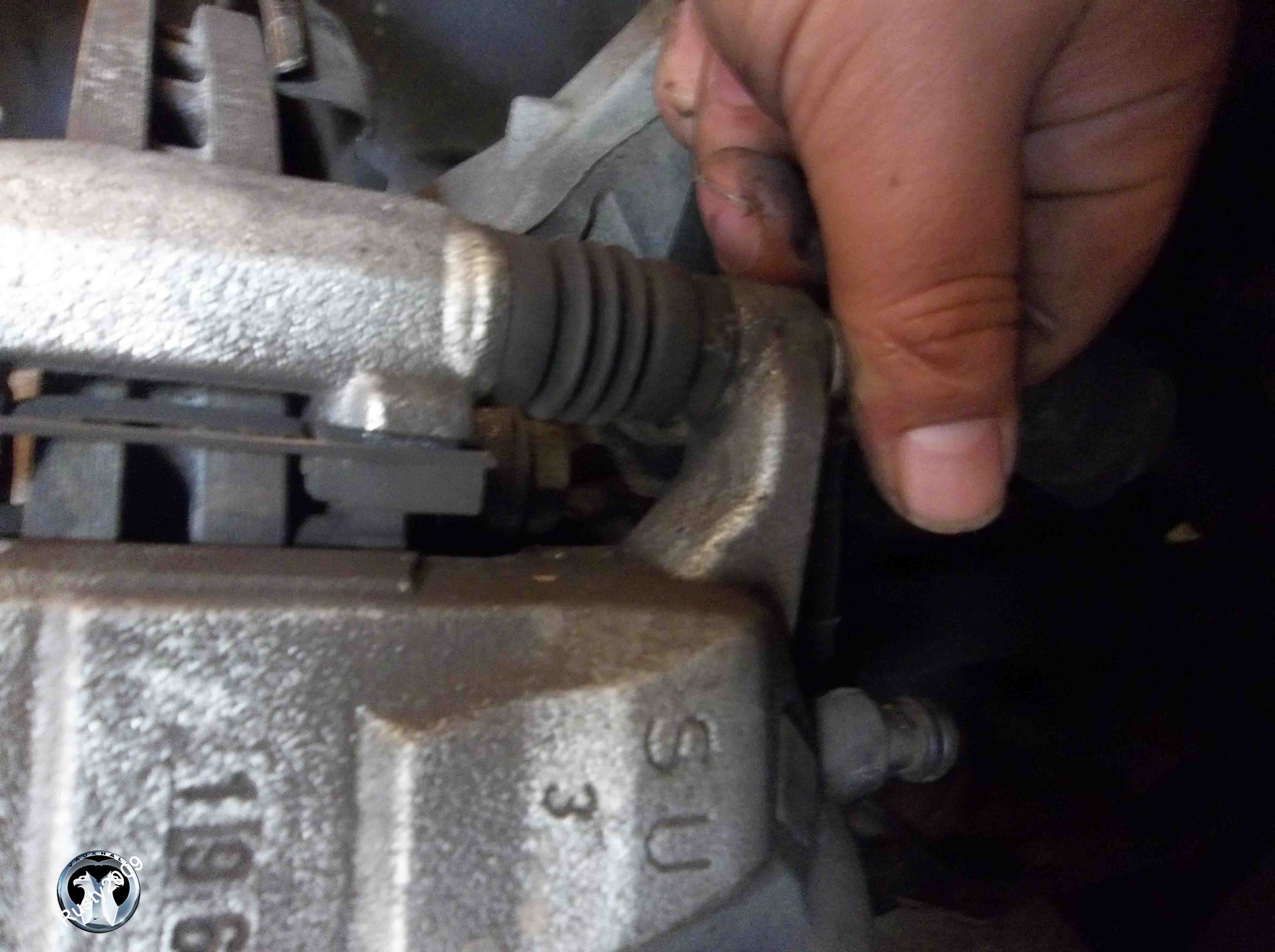

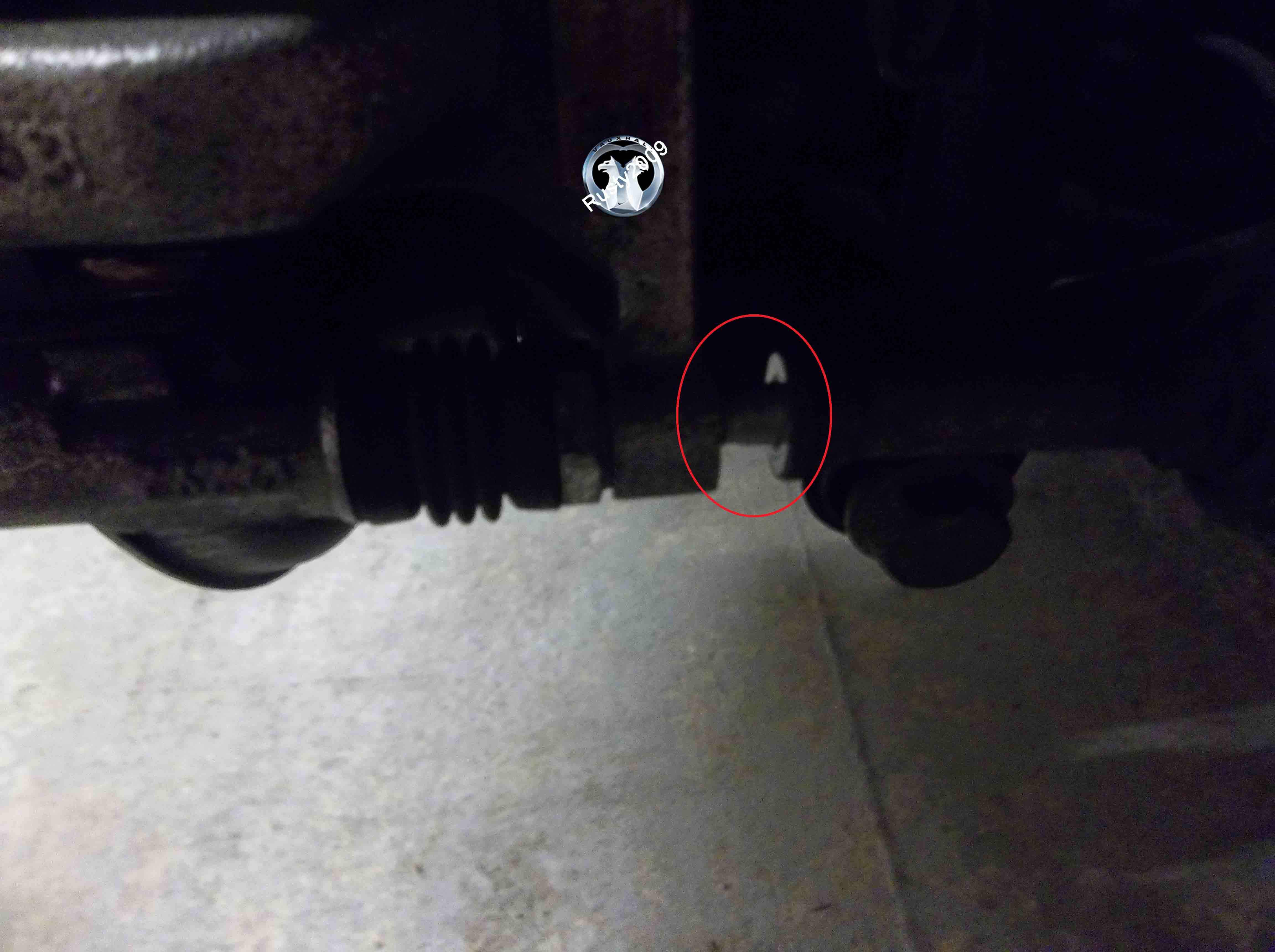

fully remove the calliper vibration dampener 13mm spanner
again pull the housing out and up
there is not a lot of room here hence no pics but the pads pull out the same as the front as do the retaining springs.

This is what I was struggling to remove number 2.
The nut which is up against the calliper wouldn't budge
Might be worth adding if possible that you can undo the rubber vibration dampener by opening the cap on the end and using torx30 to undo it (unscrews in the dead centre as hard to get a look on it). This way u can slide a ring spanner over the nut instead of doing what I did and round the nut off using the open end spanner. Now I need to buy a new one and replace when I get 10mins. Made the second brakes a 5min job knowing this
