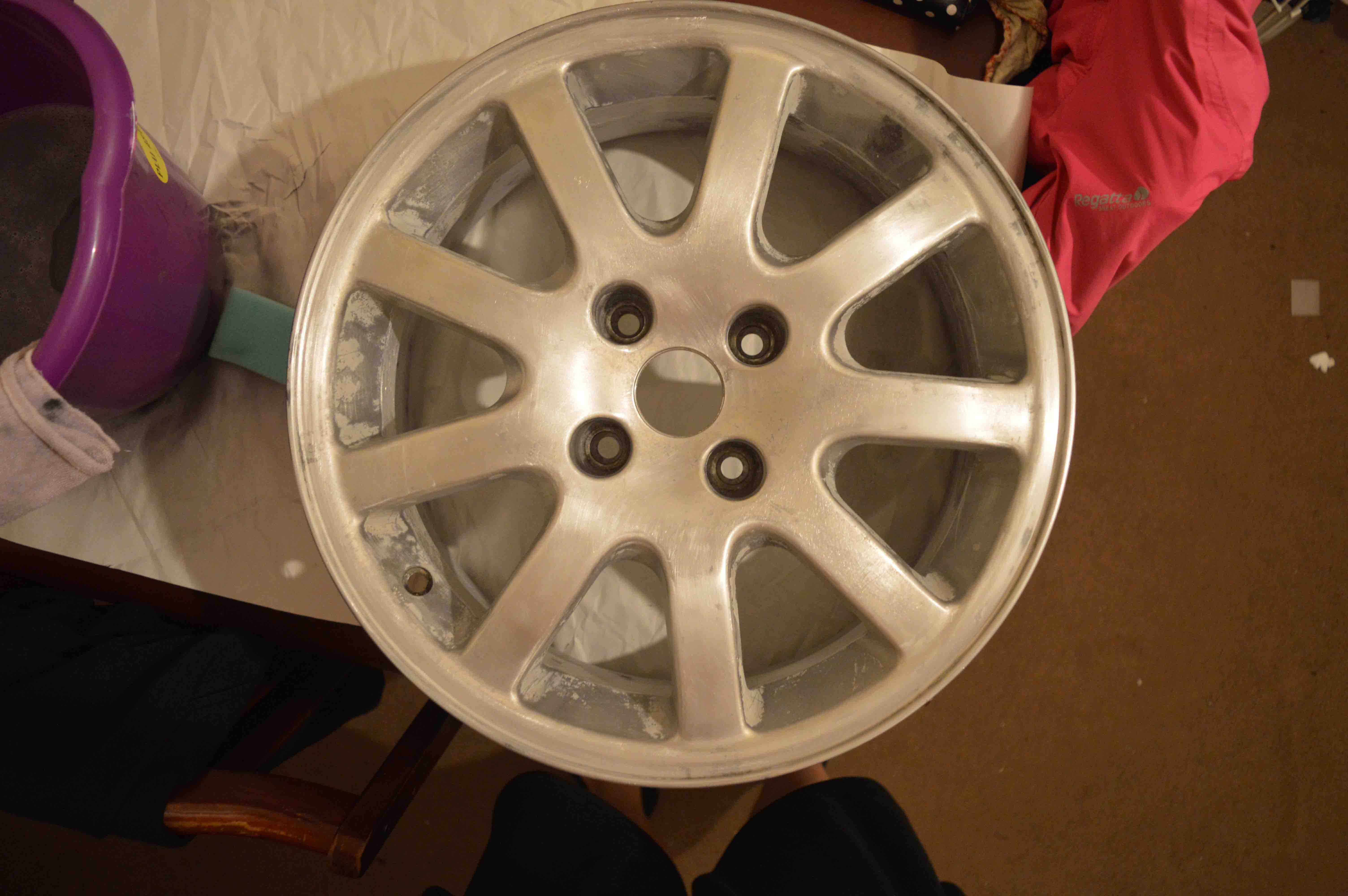

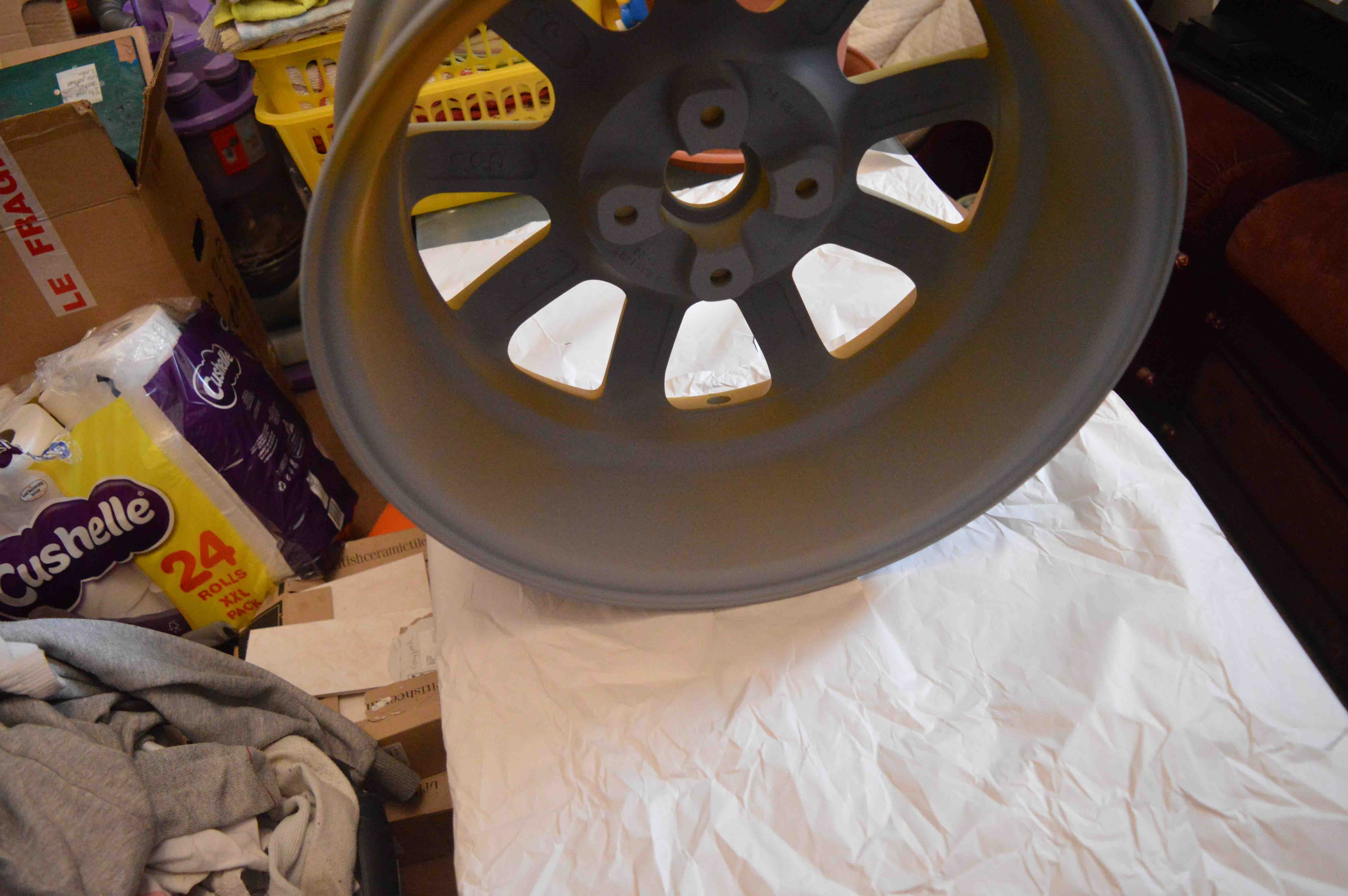

After sanding & using alloy putty to fix any damage got me to this after a nice soppy wash.
[Image: 2d.JPG]

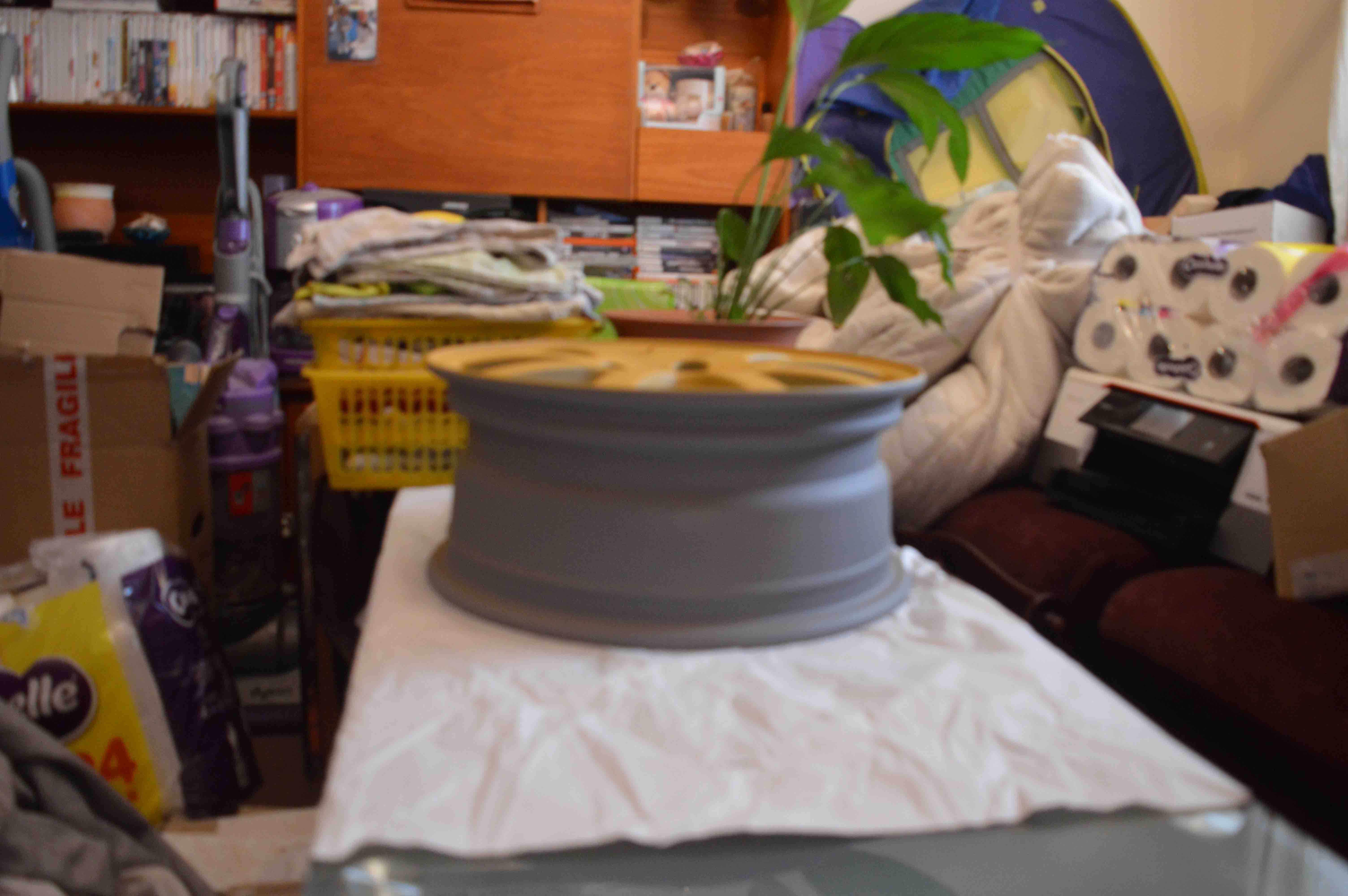

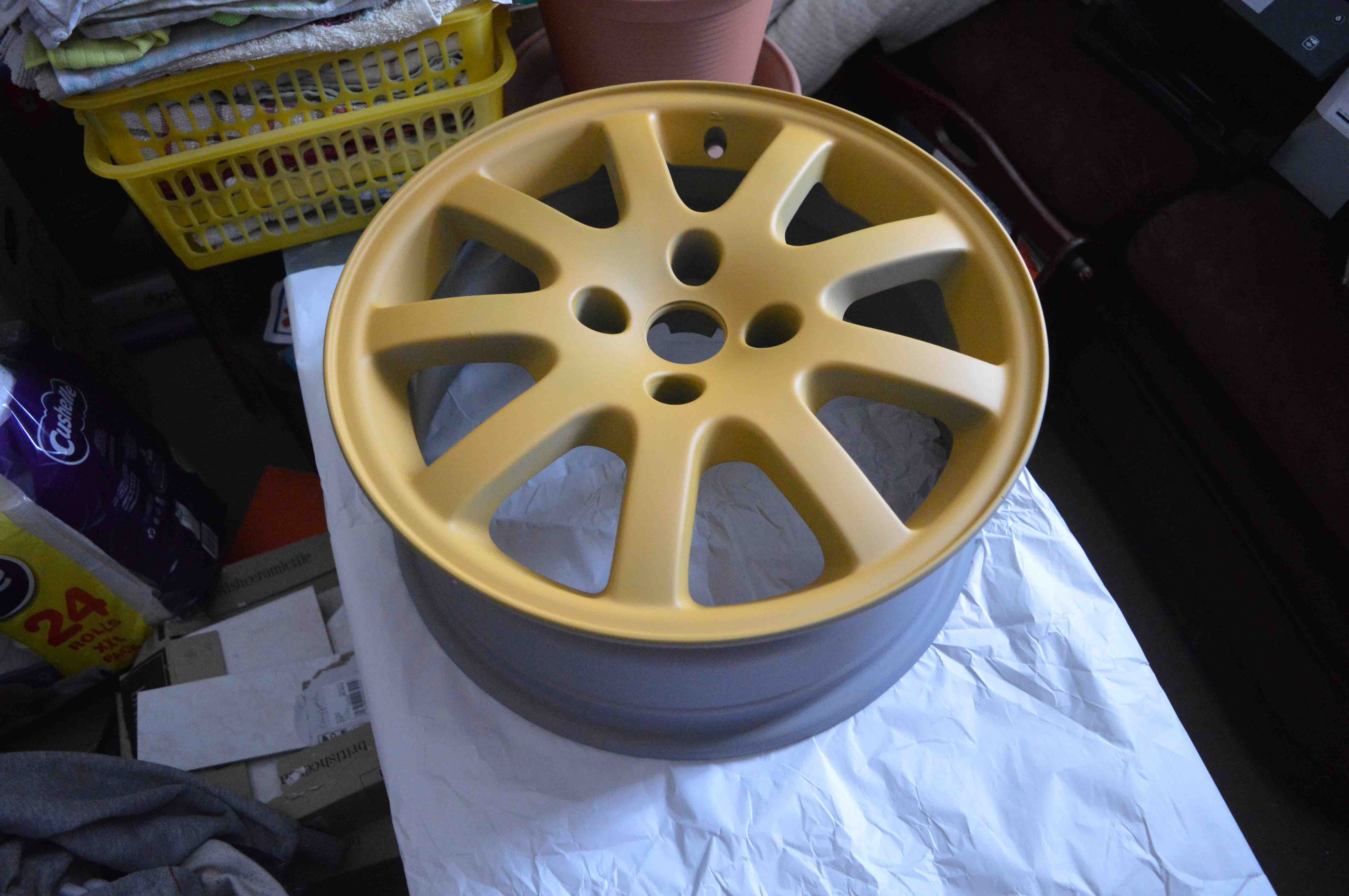

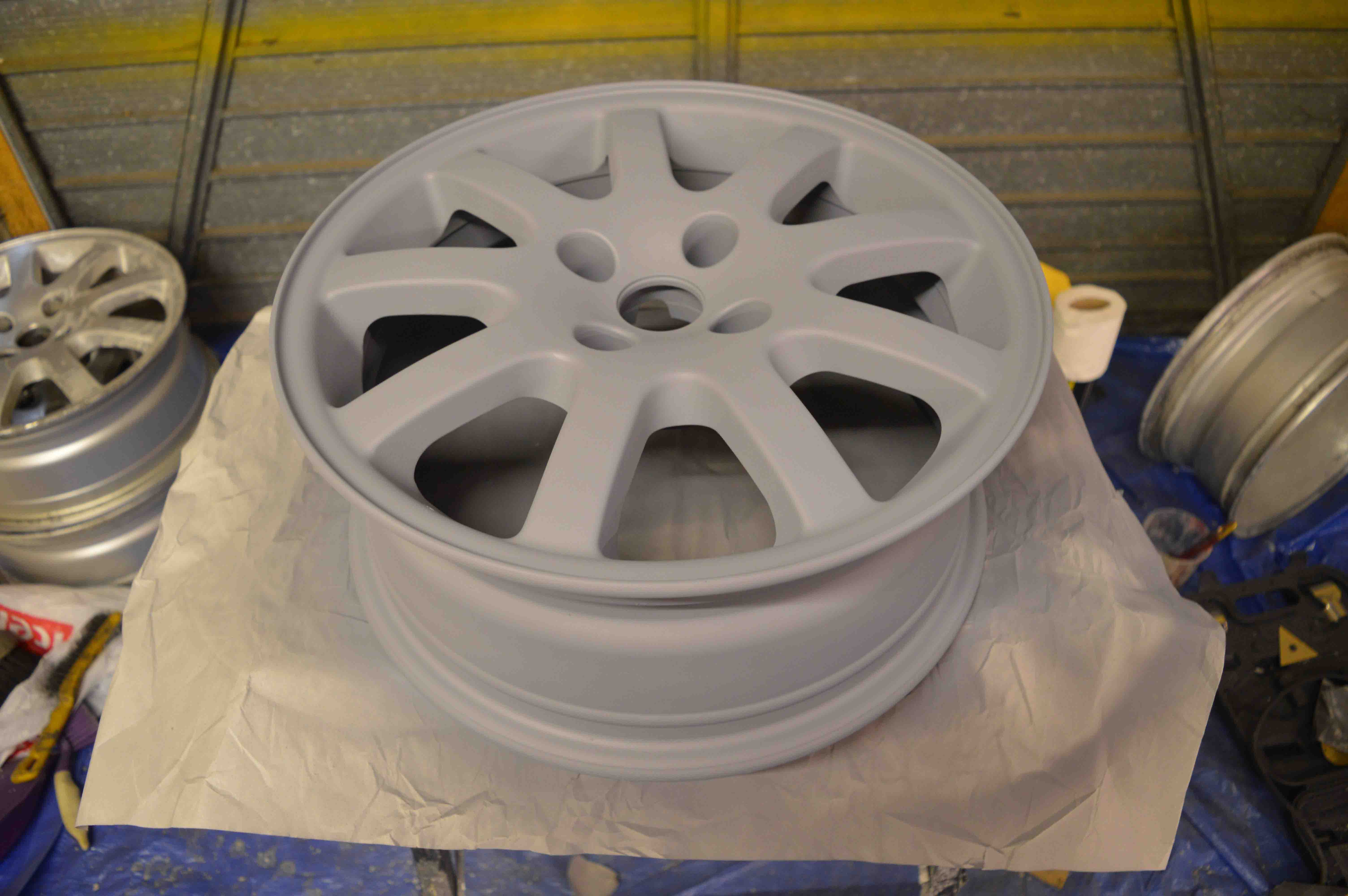

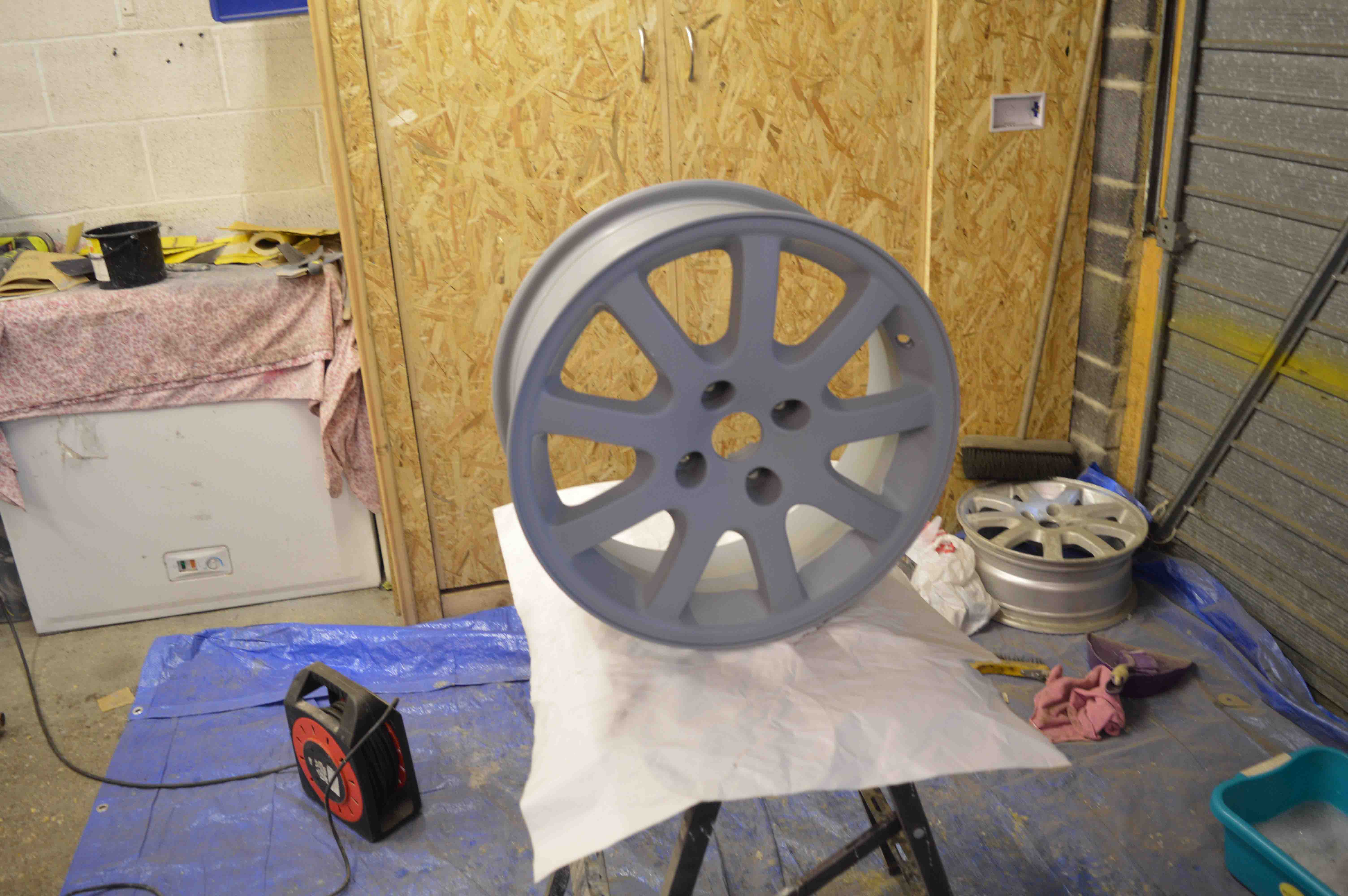

Then some etch primer, primer & a coat of filler primer has got me to this.
[Image: 2e.JPG]
[Image: 2f.JPG]
[Image: 2g.JPG]
[Image: 2h.JPG]
Now just letting it cure before a light rub down and one more coat of primer.
As its cold I've brought it inside.
I did keep the wheel inside overnight to get it to room temp.

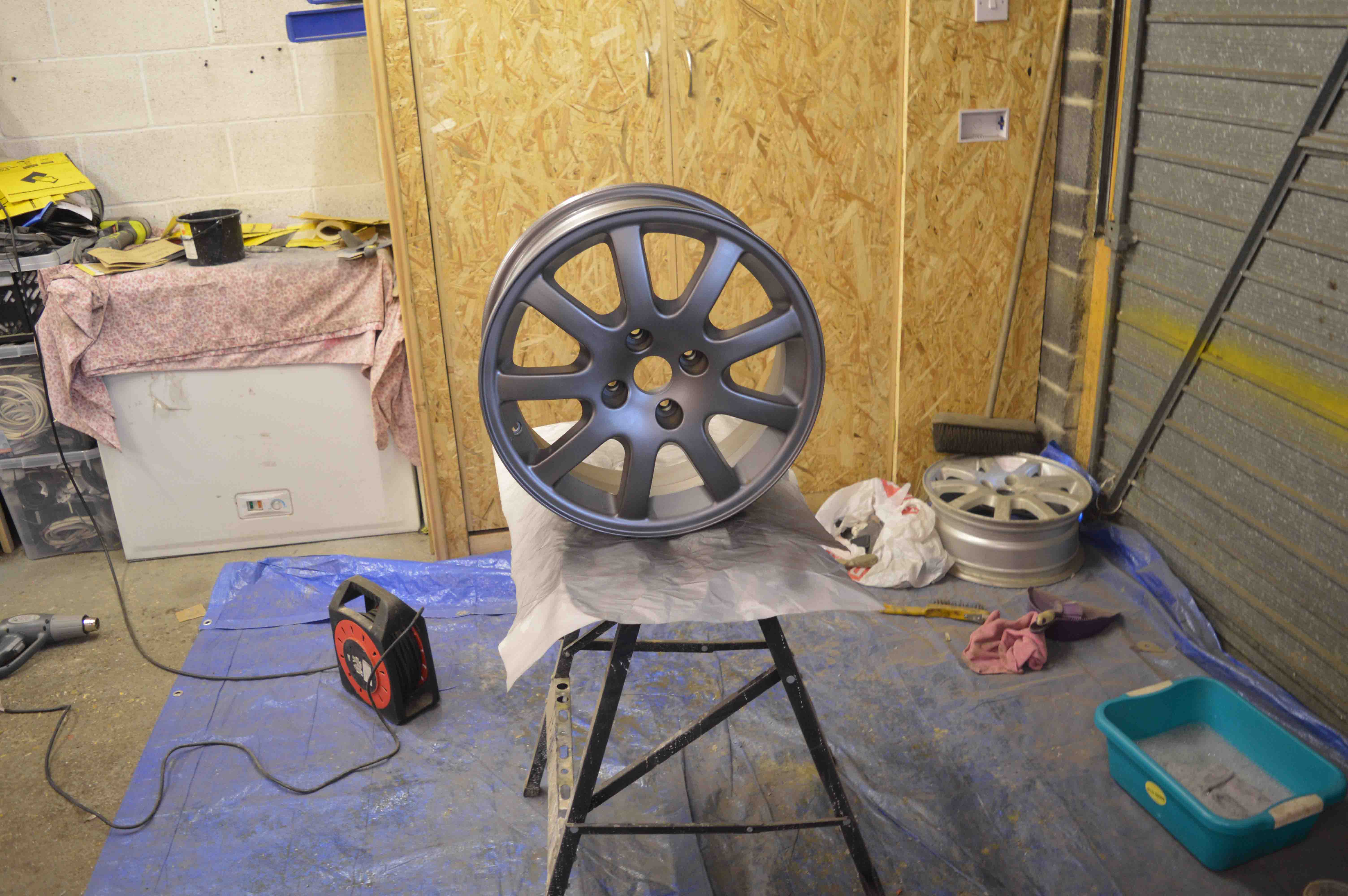

So after a rub down and another coat primer I allowed the wheel to dry and then flatted off
[Image: 2i.JPG]
Then I applied the top coat.
[Image: 2j.JPG]
Just letting it dry for 24hours before a clear coat.
A few little defects in it but over all I'm impressed with the result so far as is the wife.
