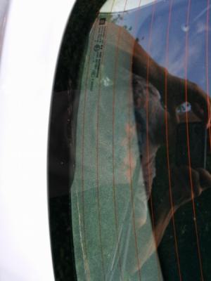

so the left side looks like this
[ATTACH=CONFIG]207[/ATTACH]
[ATTACH=CONFIG]208[/ATTACH]
the right side is poor
[ATTACH=CONFIG]209[/ATTACH]
its done with foam that sticks on one side and looks a bit like this
[ATTACH=CONFIG]210[/ATTACH]

Got mine back and it's still playing up. Will give this a try. So it's the trim on the boot by the boot catch? Will try some sponge tonight to see if it works the. Get some foam if it works.
#61
WhelanUK Wrote:Got mine back and it's still playing up. Will give this a try. So it's the trim on the boot by the boot catch? Will try some sponge tonight to see if it works the. Get some foam if it works.
yes, it solved it with mine
