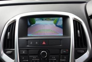

I've recently installed a reverse camera on my Astra J 5 door. I wanted to get the genuine one but it was going to work out 3 times the price and I still had to install it myself. I'm in Australia and the dealers were not promising they could get the VCI code from Opel but I found one who would at least try. I decided to go the interface box route instead. I used the same brand of box as Rusty2009 posted. The brand is FOSP but I bought it elsewhere cheaper. It intercepts the GVIF cable between the stereo and the screen rather than some which need you to pull the screen apart. It was a lot of messing around (first box arrived faulty and second one had a faulty part that needed a mod) but I'm really happy with the result. I found a camera that fitted into the hatch handle and looks like the genuine VX. The GTC will have to use the number plate light but that's OK.

At risk of breaking the rules, I've put a how to thread on the Australian forum. I have to give credit to Rusty2009 for his post on pulling the dash apart which I was pretty nervous about but his post described it brilliantly and gave me the confidence to have a go at pulling my brand new car apart. I might try to copy it to this forum also.
I'm not sure about the Nav 500 but it might need the RGB version. Downside is you need to pull the screen apart (not that big a deal I suppose) but the upside is its much cheaper.
Ask the sales guys though if it is the right one and they will confirm it.
Here are a couple of photos showing the end result...

Yes just the nut and a washer - which I think is enough. I had to put a rubber wedge under it to get the right angle - it could use a little more wedge as you can see the white panel in the bottom of the image. Even though the camera is sealed I put some silicone around the end of the nut and to keep it from moving.

I have one of those fitted on my 5 door hatch, rigged up to one of Rustys fave stereos. Works fine, but if it shows the guide lines, remember they will be wrong. Distance wise it is spot on, but position wise, nearside to offside, then it is off due the fact the camera is offset. So don't try reversing close to high pavement thinking your spot on, only to hear that lovely crunching noise! (and no, I haven't done that!)
I will be changing mine at some point to one like our man from down under has used. That way it can be put dead centre on the bumper.
