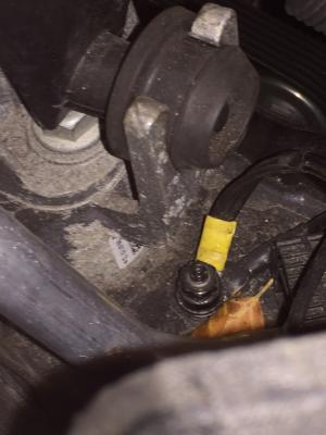

i also have grounding wires coming off the ballasts do these need to be connected?
Ground wires need to be hooked up mate
(2:nd-Jan-2016, 19:43:21)Rusty2009 Wrote: Ground wires need to be hooked up mate
Two what though mate i don't even know what a freaking ground wire is lol.... its just a black cable with a silver hook at the end, I left it because i read somewhere that the lights already have grounding.
Didn't realise you had seperate earthing wires yes connect them to earth. I never had separate earths no my ballasts
You should have an earth stud near the headlight
(2:nd-Jan-2016, 19:45:48)cornishtaz Wrote: Didn't realise you had seperate earthing wires yes connect them to earth. I never had separate earths no my ballasts
whats that mate? also how do i connect it? i have one of those wires on both ballasts. also its not just about finding where to mount the ballast as I have like 2 little power packs as well? its ridiculous how big all the stuff is and theres no space to put them all :-/
Ballasts would be best fitted under the headlamp and the same for power packs.
As for grounds there is one by the air box for drivers side
For passenger side there should be one I front of the battery just under the slam panel
I just got sopping wet legs getting you them :-p
You could put the ballasts between the inner wing and fusebox on passengers side and inner wing and airbox on drivers side

Really you should put a ring term on.
These are the the size for the studs I showed you
http://www.halfords.com/webapp/wcs/store...reId=10001
(2:nd-Jan-2016, 21:33:27)Rusty2009 Wrote: Really you should put a ring term on.
That's what they already are at the end mate. If you look at my first pic you can just make it out. So I just undo the nut and add that on to the other 2 right?
I went out and found both ones u said and will do it in the morning. I turned the lights on and they both came on so it's not the bulbs so hopefully it really is just the grounding.
Tell you what tho the driers side bulb was solid to get in without removing the airbox
Yes mate undo bolts and put them on. Your see in my pics that's what I've done (had to add all the grounds for AFL).
(2:nd-Jan-2016, 22:44:55)Rusty2009 Wrote: Yes mate undo bolts and put them on. Your see in my pics that's what I've done (had to add all the grounds for AFL).
Sweet at last something easy haha!! Do you think this could be why they seem to only have half power and be flickering etc?
Could well be be mate or as Baz says could be faulty ballasts or a lose wire.
1st thing is to hook the grounds up and see what happens then if still faulty start trouble shooting.
(2:nd-Jan-2016, 22:49:29)Rusty2009 Wrote: Could well be be mate or as Baz says could be faulty ballasts or a lose wire.
OK will do. thanks for everything mate.
