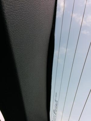

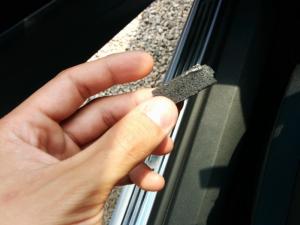

so the left side looks like this
[ATTACH=CONFIG]207[/ATTACH]
[ATTACH=CONFIG]208[/ATTACH]
the right side is poor
[ATTACH=CONFIG]209[/ATTACH]
its done with foam that sticks on one side and looks a bit like this
[ATTACH=CONFIG]210[/ATTACH]
