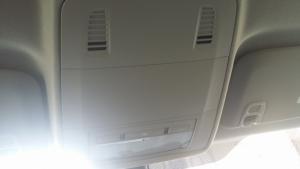

You will be able to tell if you have an alarm as there with be the ultra sonic sensors in the roof near the interior light.
good point john
[MENTION=339]Alienbv[/MENTION] do you have the sensors like this in the middle.

[MENTION=28]JohnL[/MENTION] [MENTION=2]tucpal[/MENTION] Thanks guys for the help, here is a picture of that area .
[ATTACH=CONFIG]388[/ATTACH]
No alarm fitted then mate.
[MENTION=1]Rusty2009[/MENTION] Buried Was hoping for one. But what are those for ?

Alienbv Wrote:[MENTION=1]Rusty2009[/MENTION] Buried Was hoping for one. But what are those for ?
movement sensors form the alarm

No the grilled bits you have on yours will be where the microphone sit's if you have factory fitted Bluetooth.
[MENTION=28]JohnL[/MENTION] Yep I have the factory Bluetooth. Ok then after a few months ill be fitting the VIPER alarm system. What is your opinion guys on this system ?
