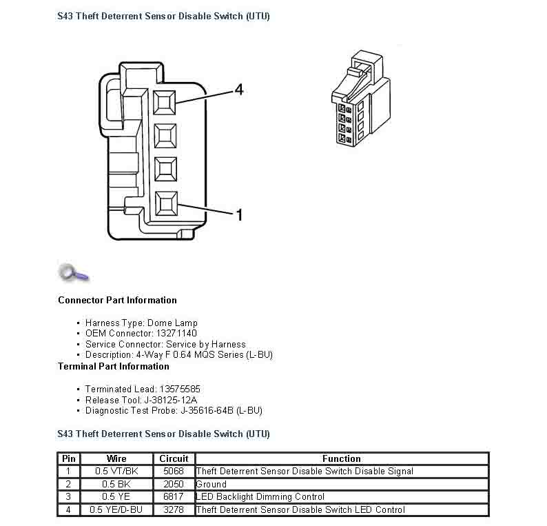

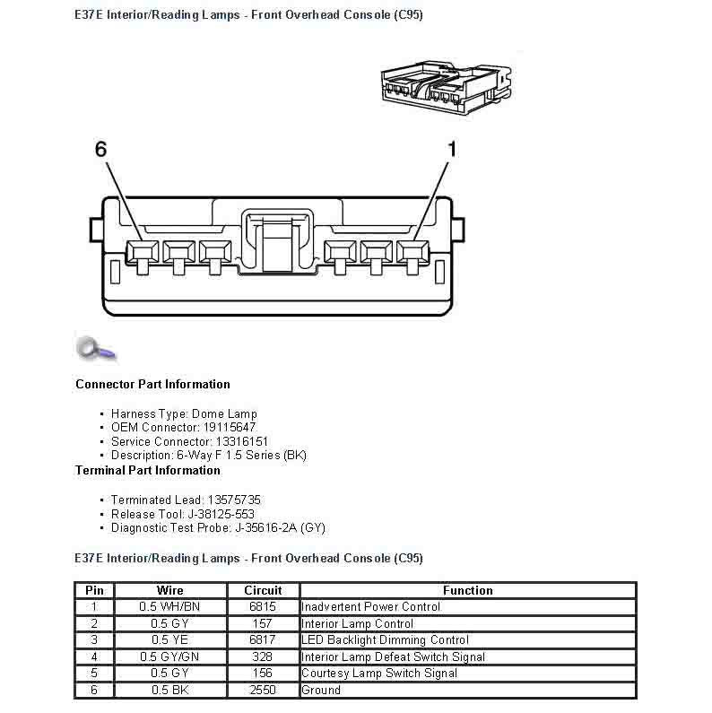

I am looking for the pin out of the motion sensor button and the front roof lights.
Could you help me?
Could you help me?

Opps Sorry I forgot here you go mate.
Thanks!
