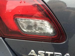

Wanting some of advise got astra J 2012 and happened to noticed this morning that the front corners of the headlights have condensation in them at both sides. Also walked round the back of the car and the rear reverse bit of the light on the boot lid also has condensation in on both sides, first time I've noticed it. Anything possible to do to stop this from happening? Anyone else have this problem? Really annoying!!! ?

        do you think if i removed it a hair dryer would sort the problem? With it only been that little square bit thats got it in, can i get to that bit or is excess blocked inside?
Where rev and fog go is a bit of plastic which you can't get of the unit. so you have the outer plastic then other bit of plastic.
I took them off and dried it with hair dryer, been ok for two days just looked again now its evan worst lol, when i pulled the plastic cap from the boot lid, there was some water in there that dripped out, not allot.. all carpet is dry in boot could there be a faulty seal?
i would say so a faulty light seal
or missing seal someone may have change a bulb and lost it
