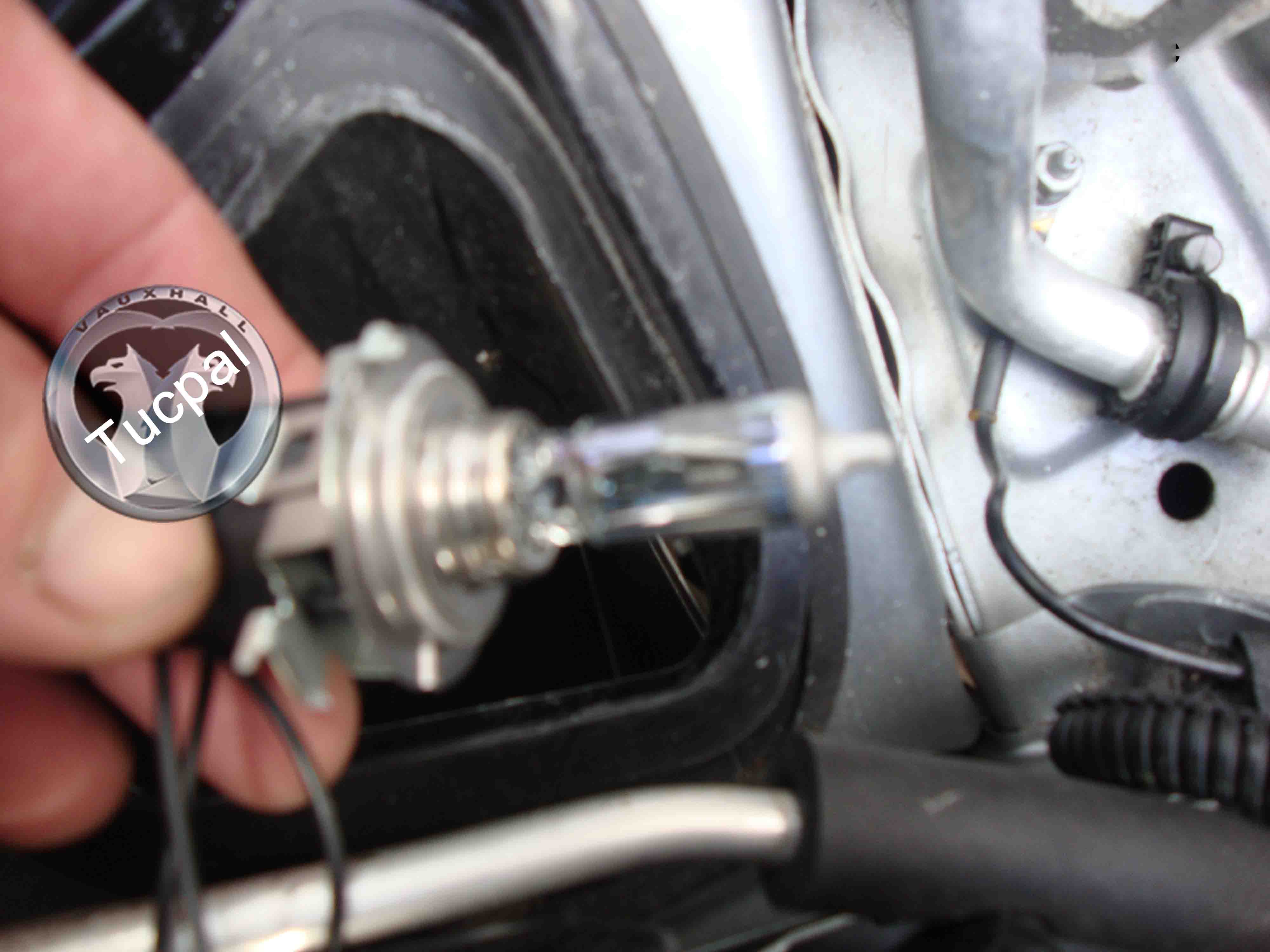

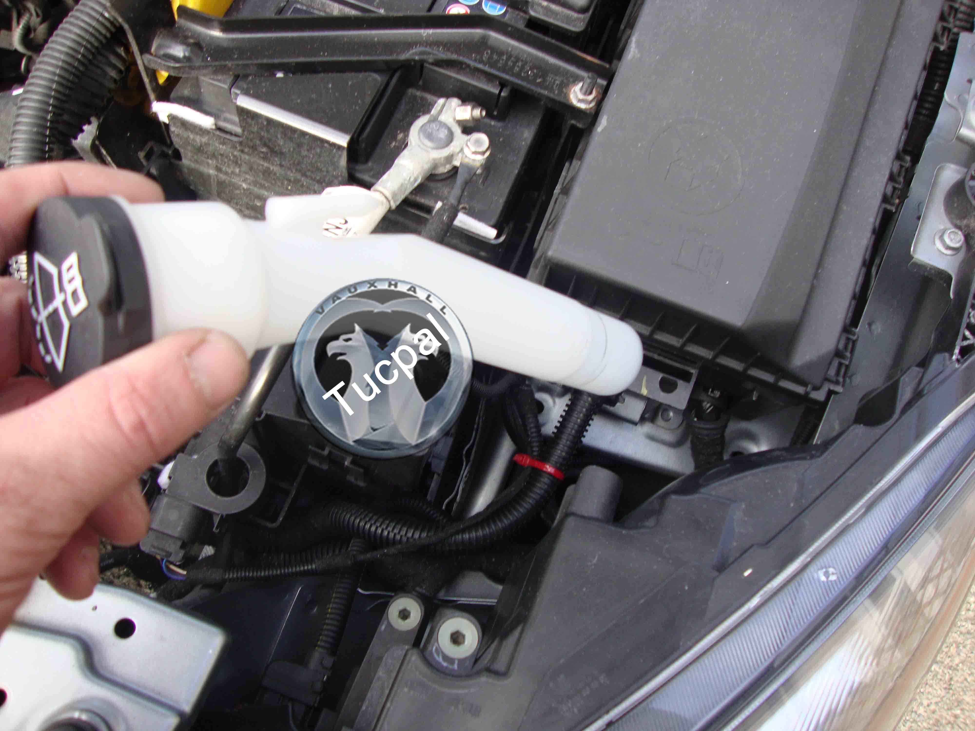

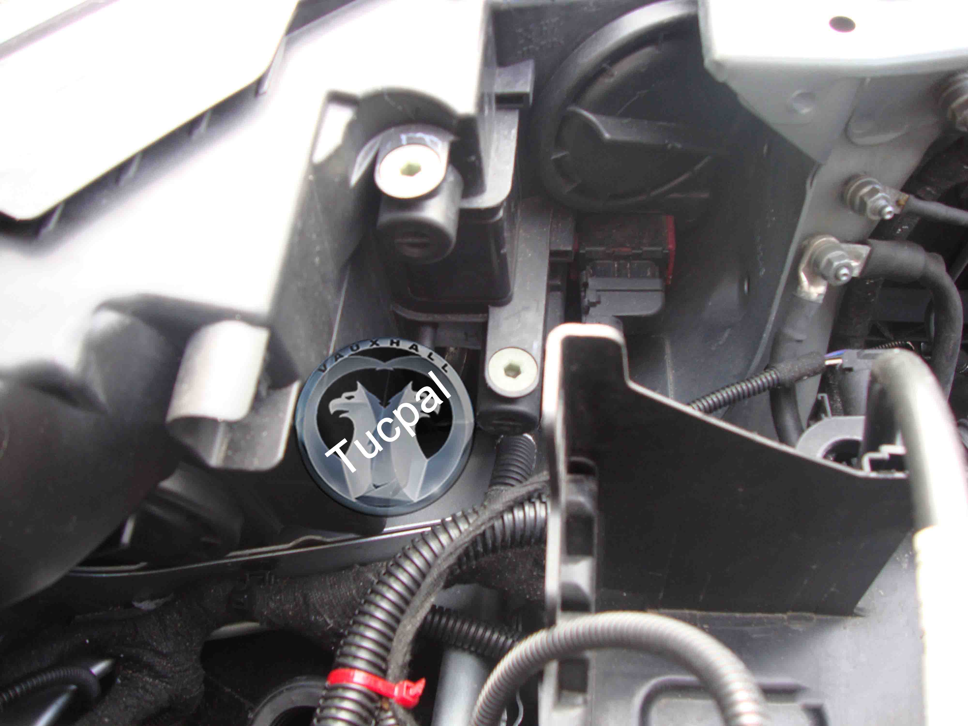

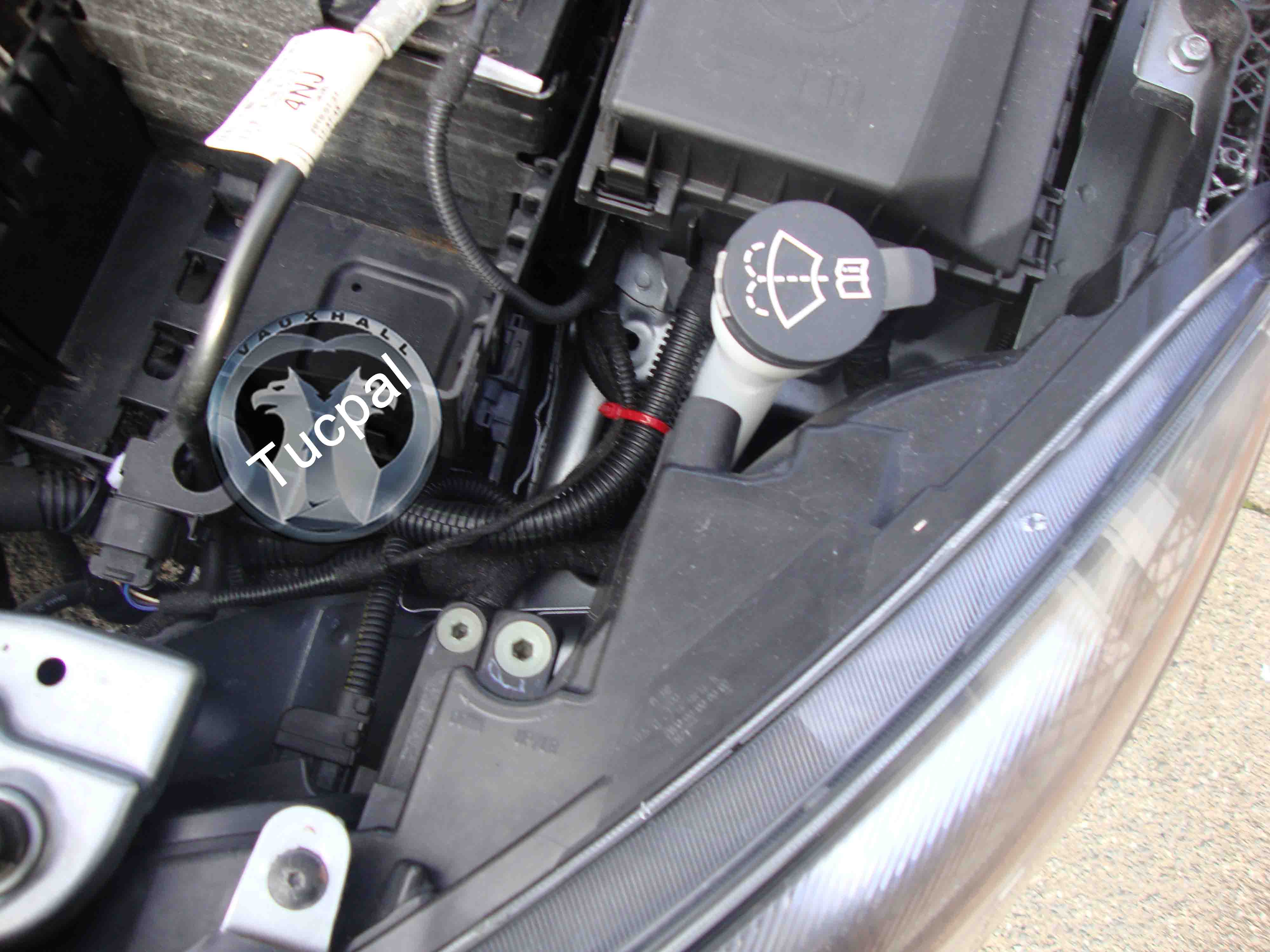

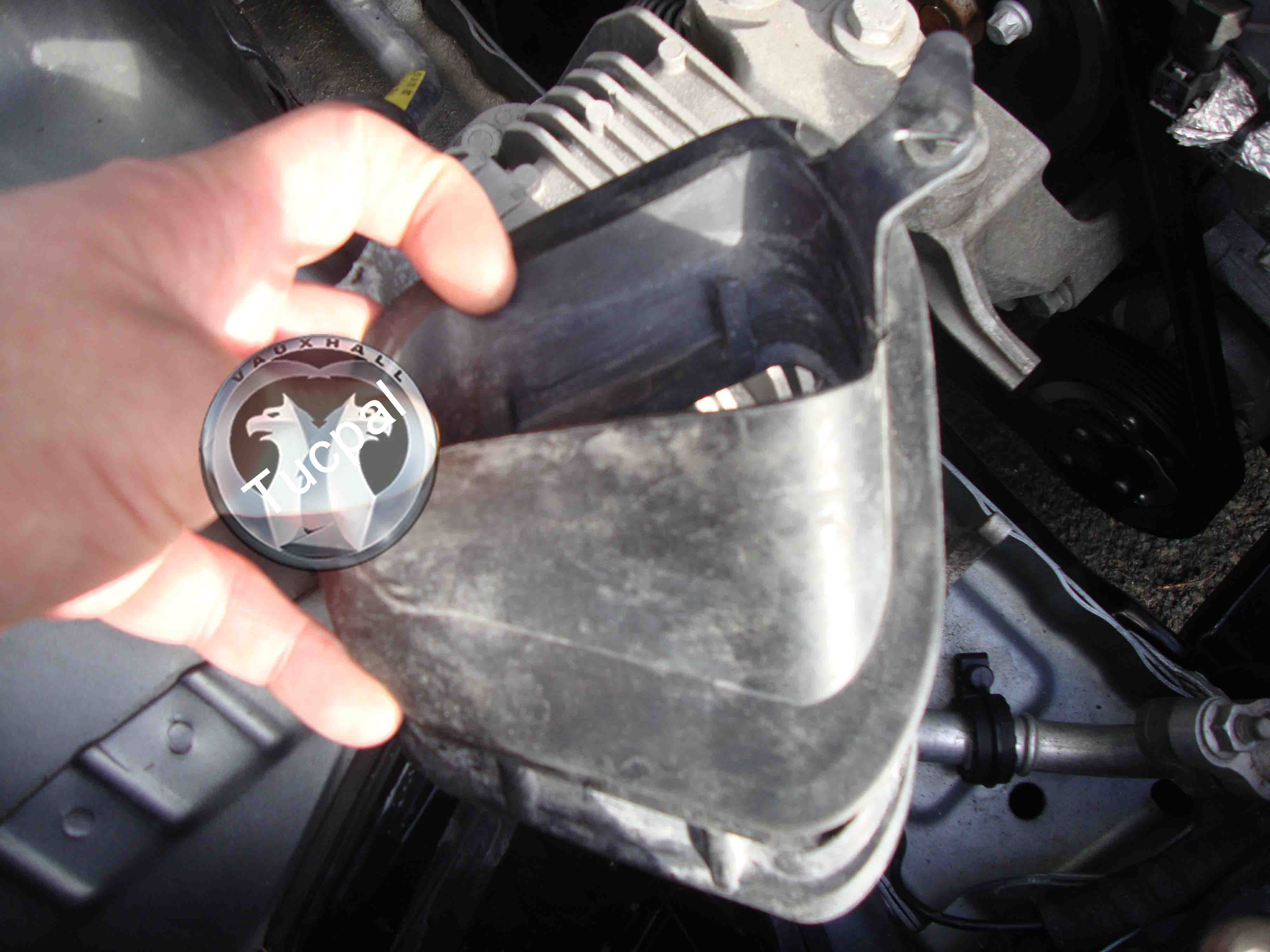

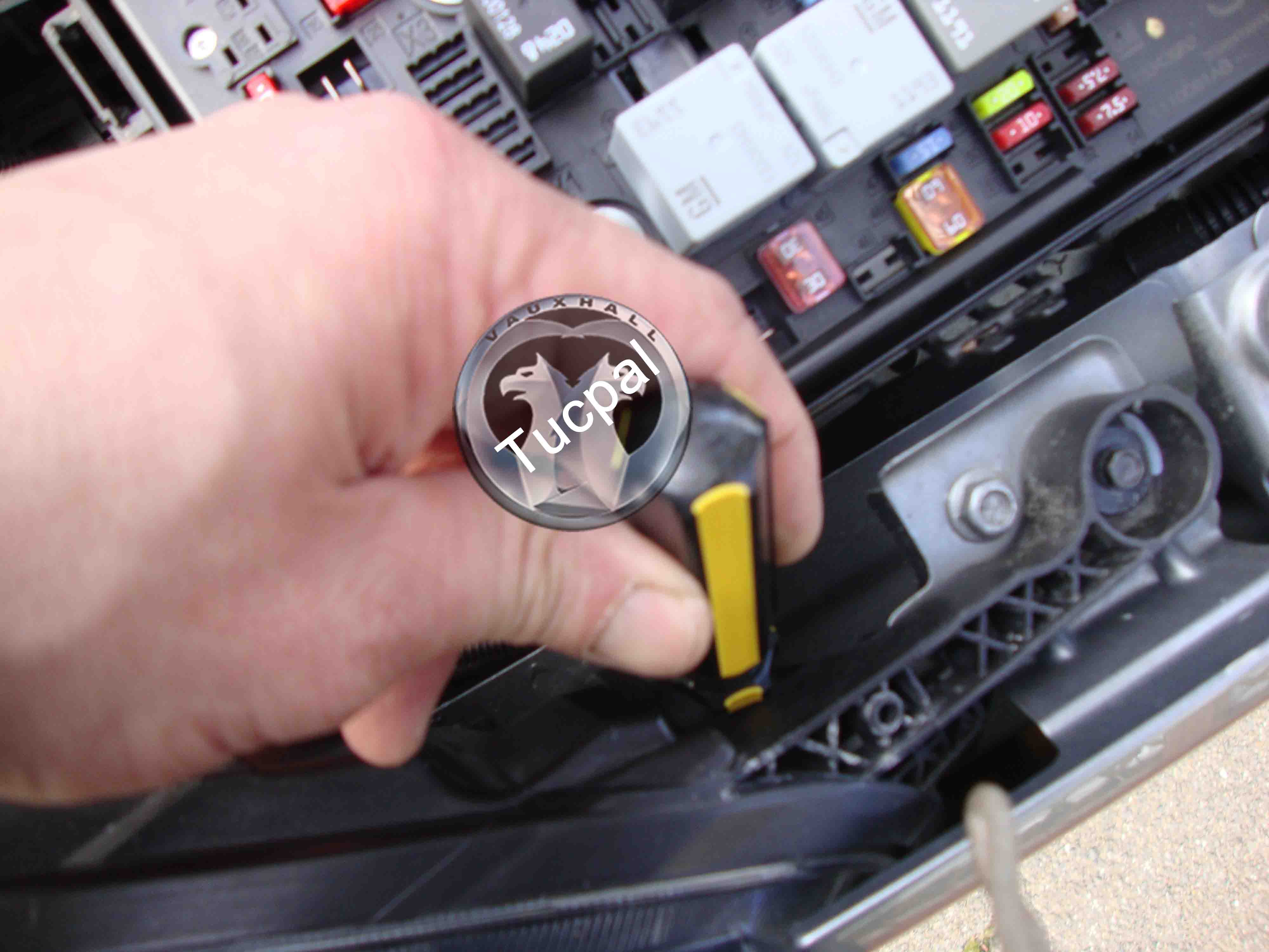

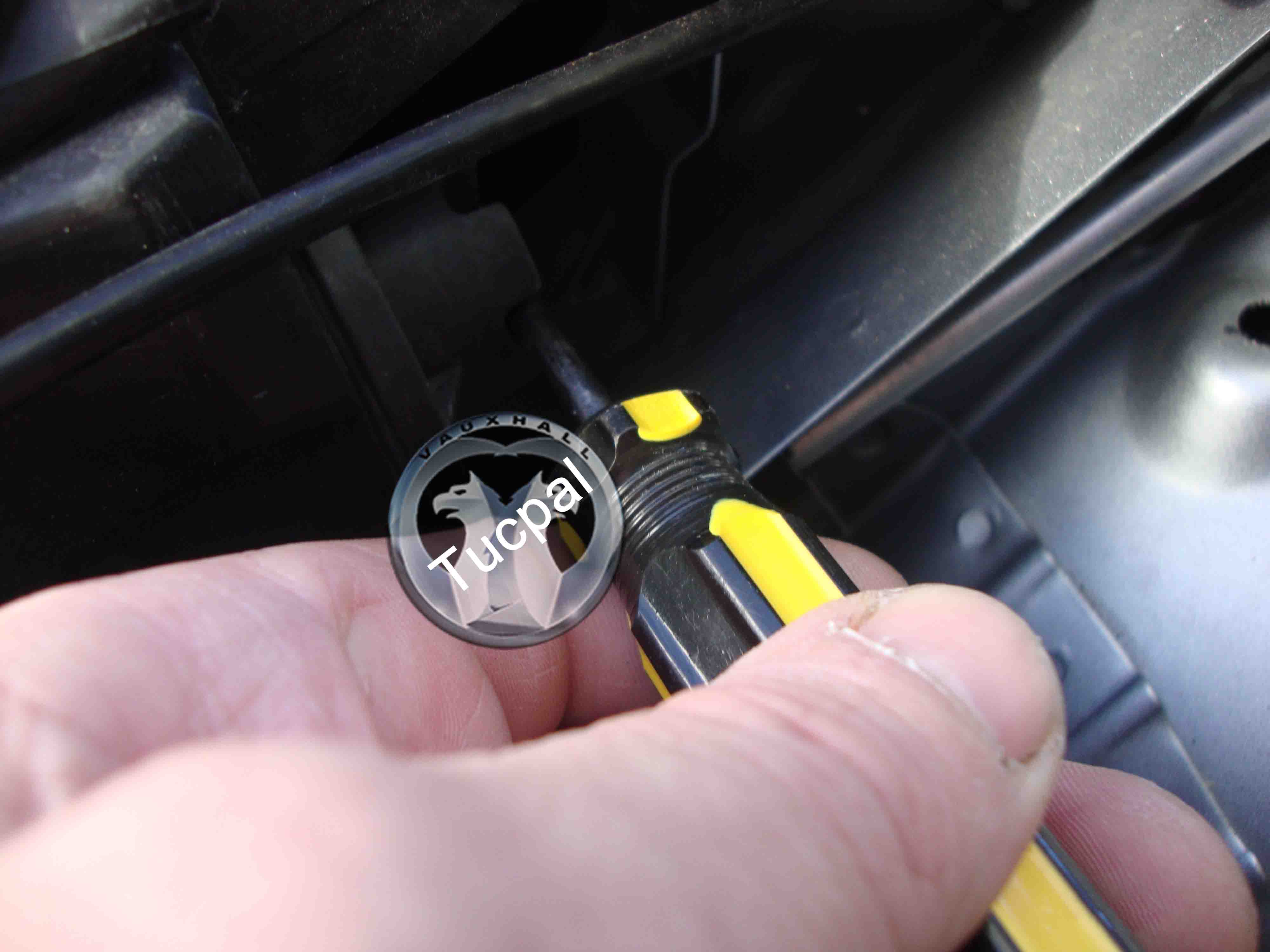

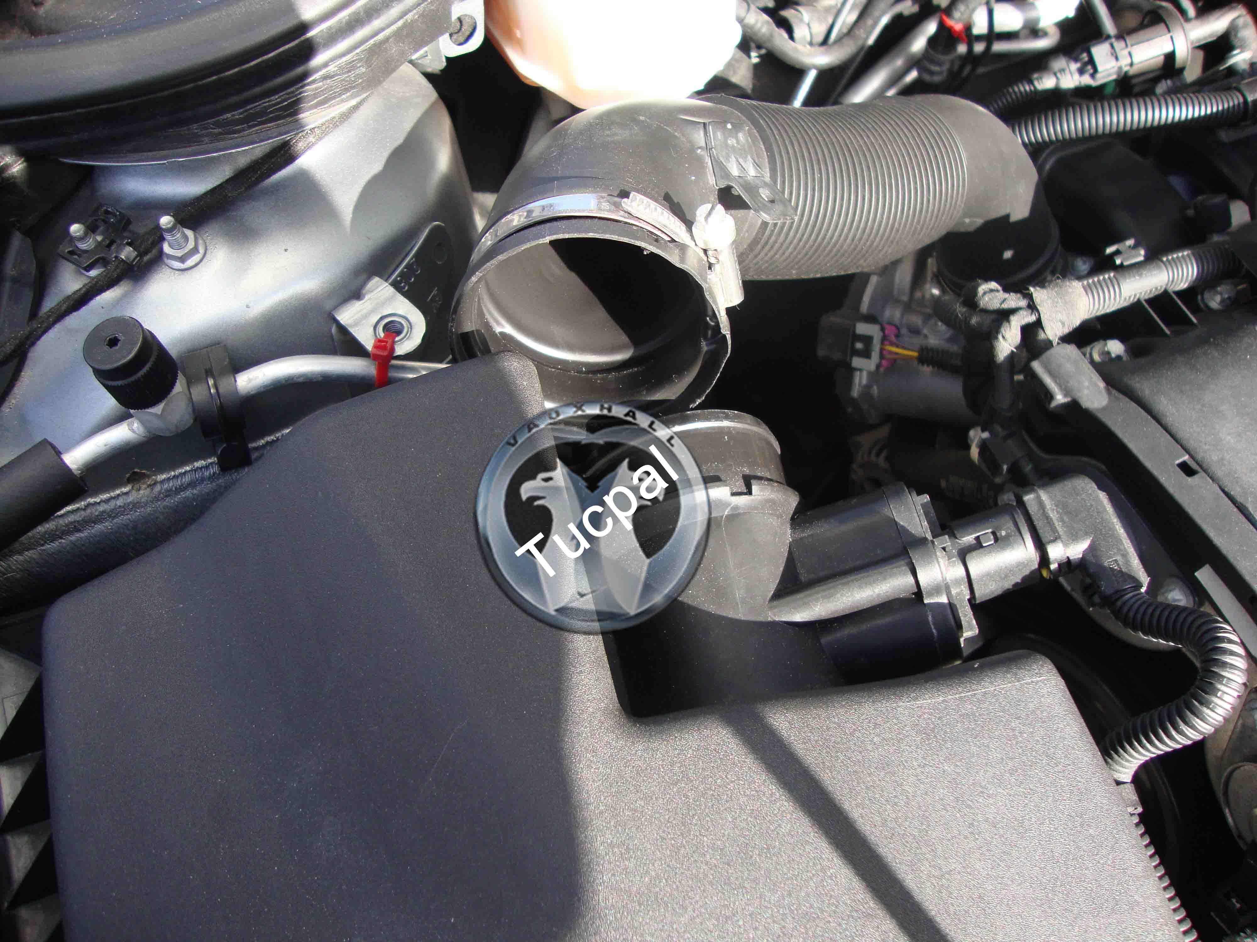

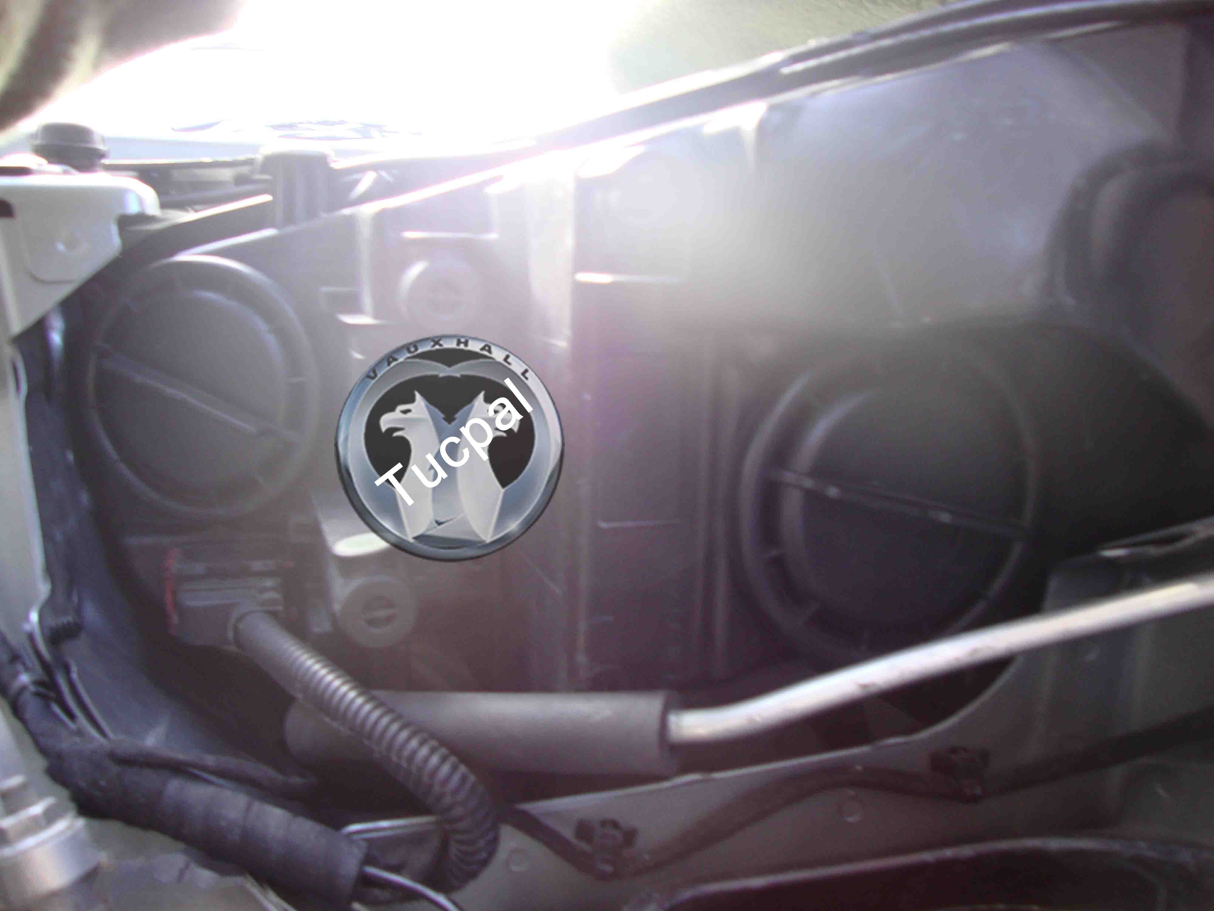

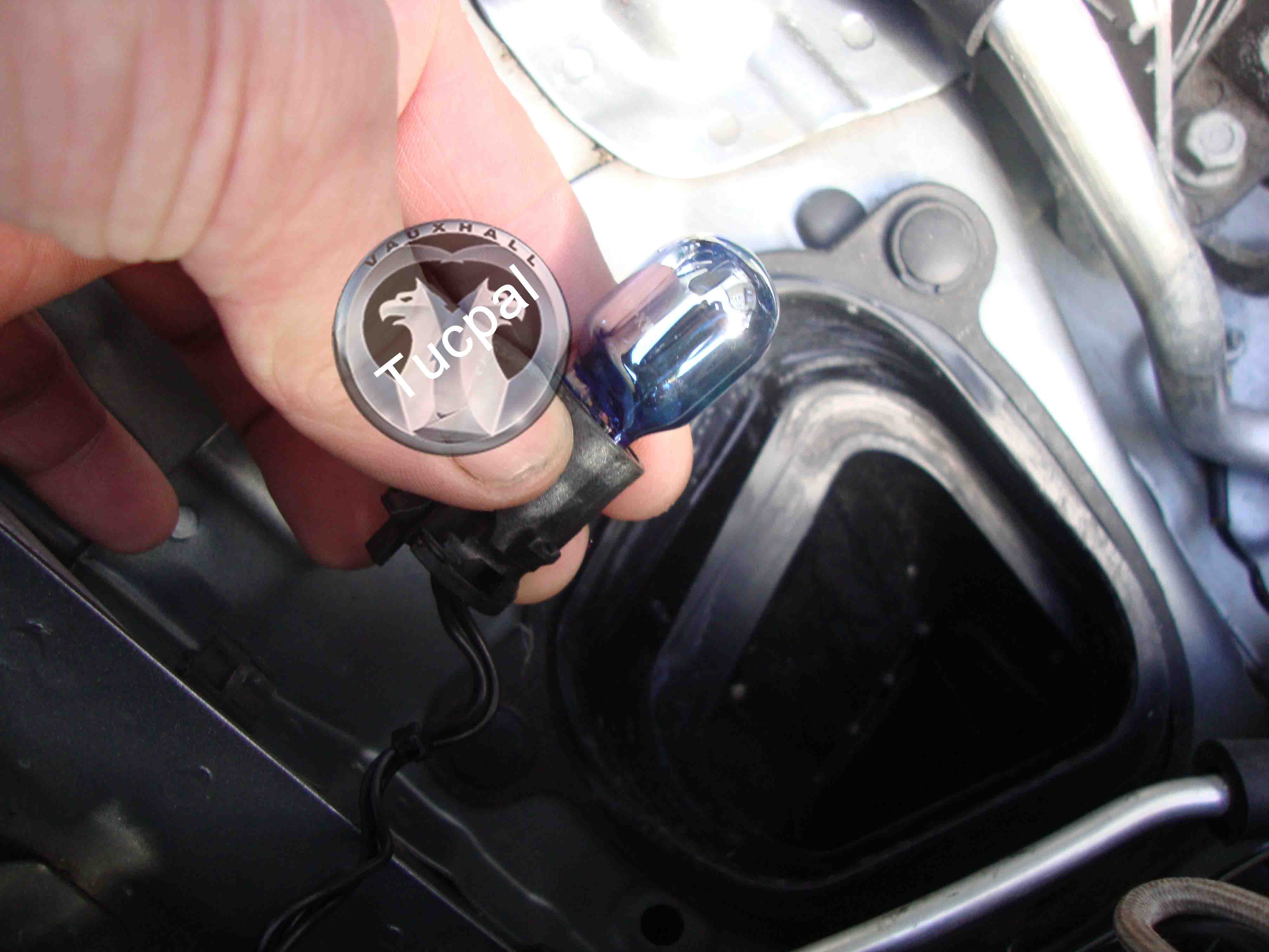

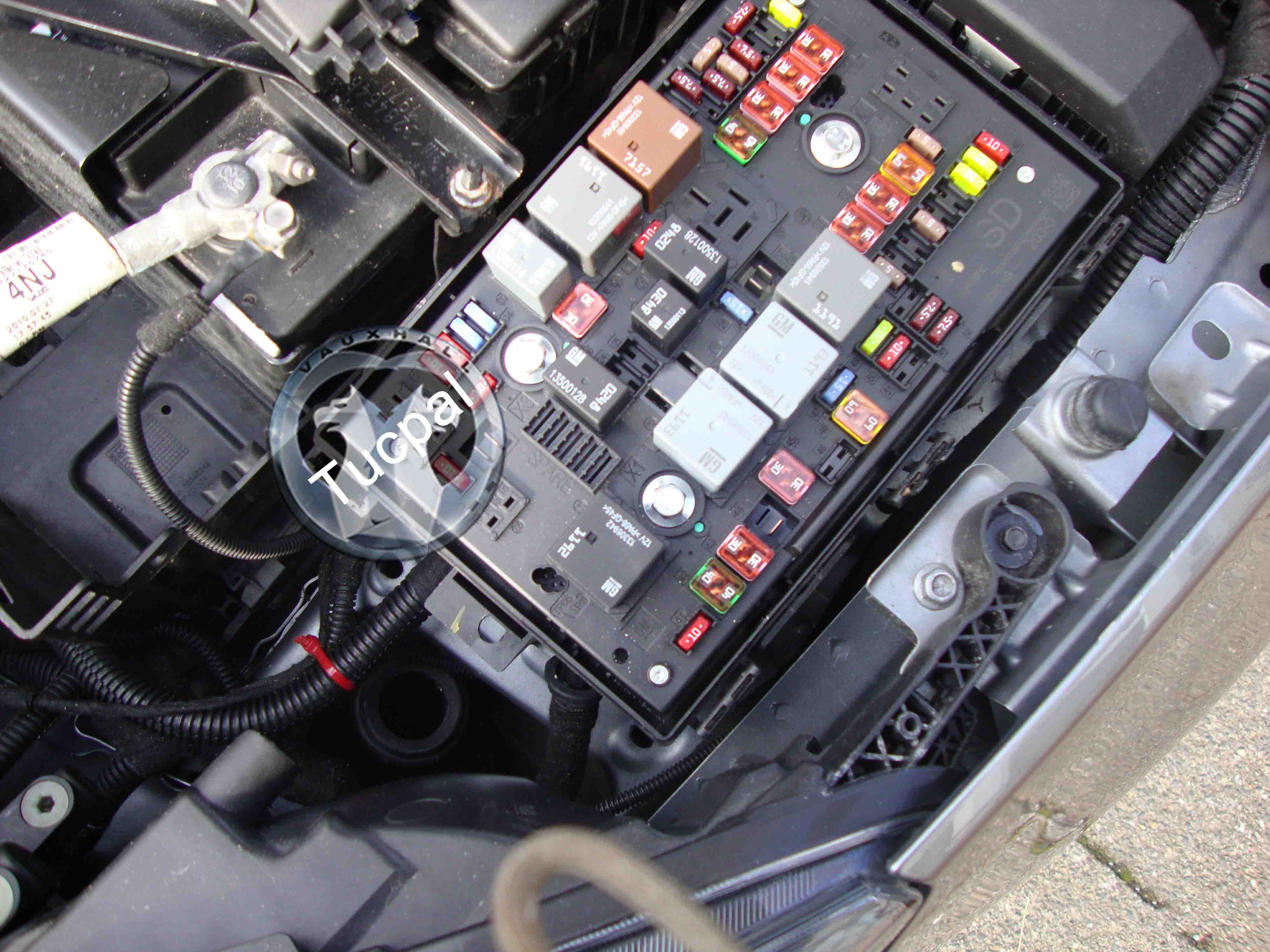

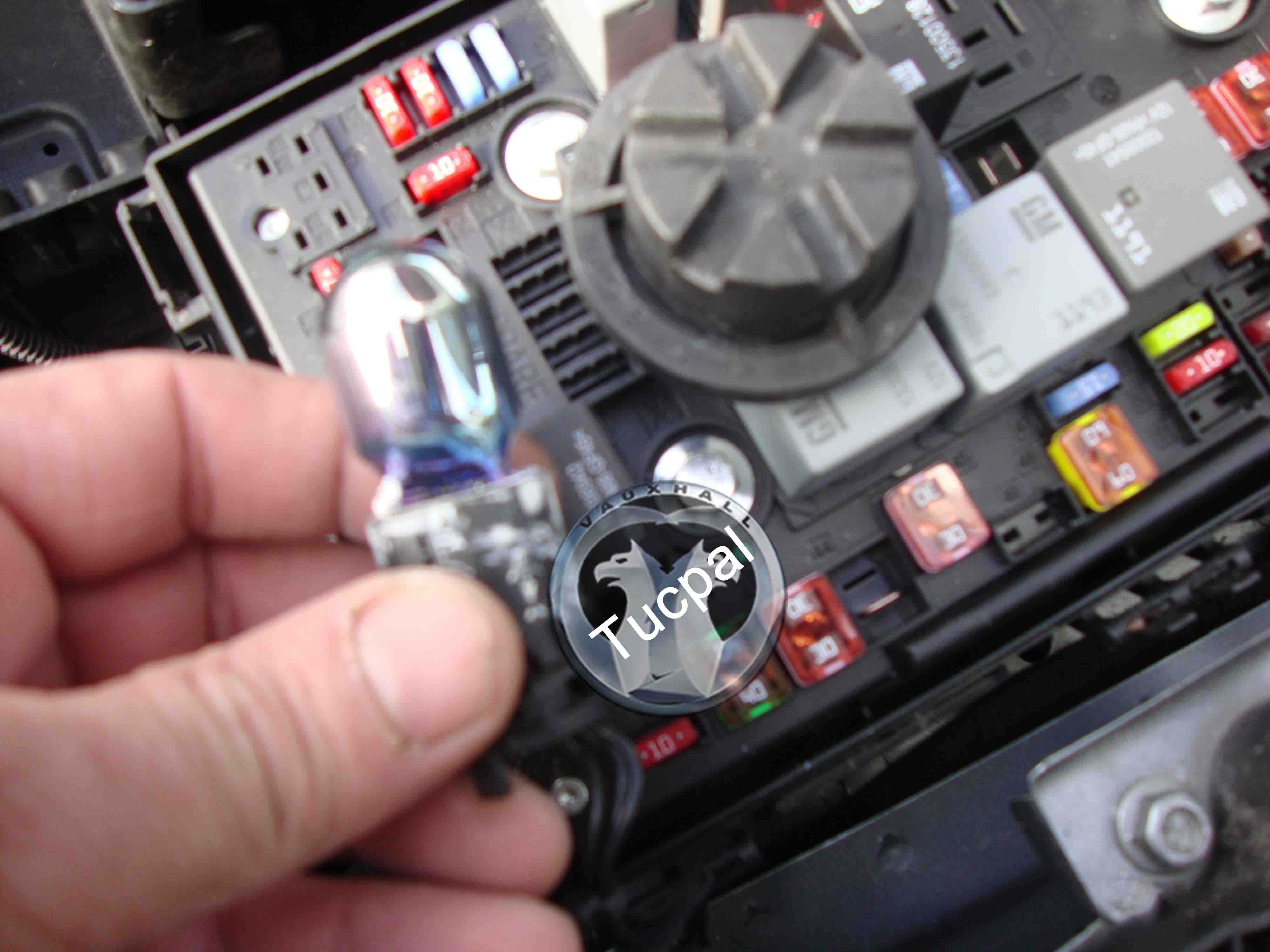

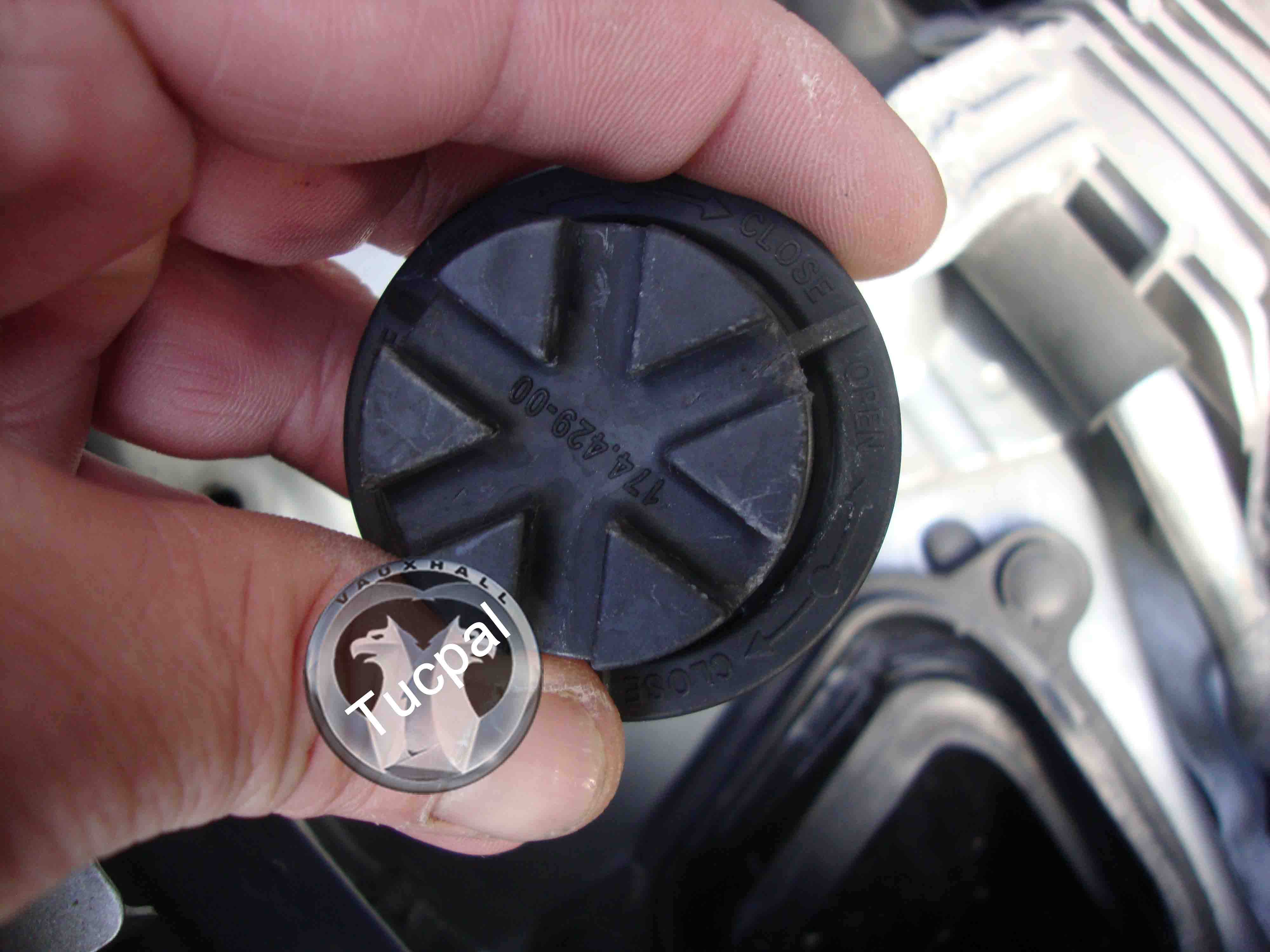

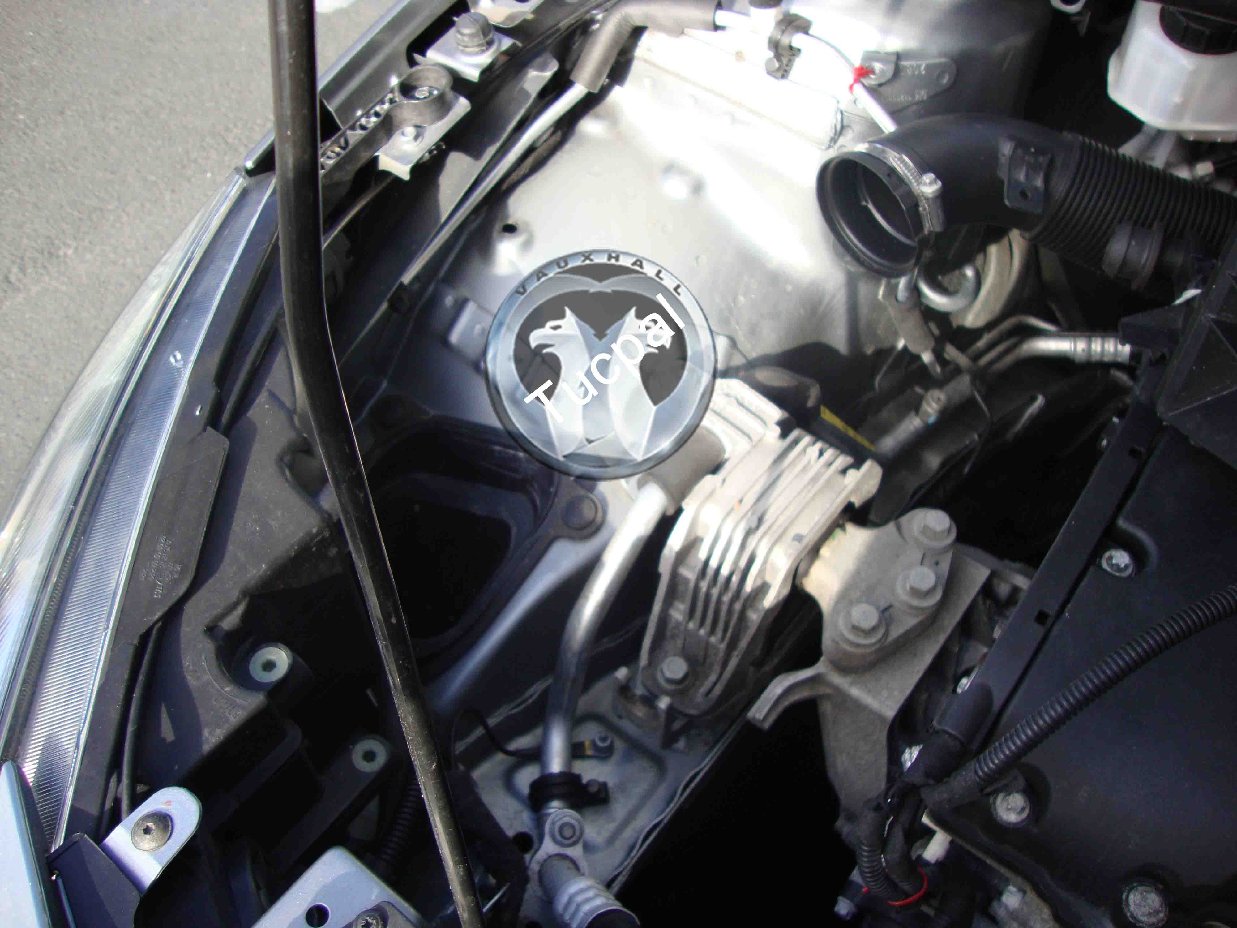

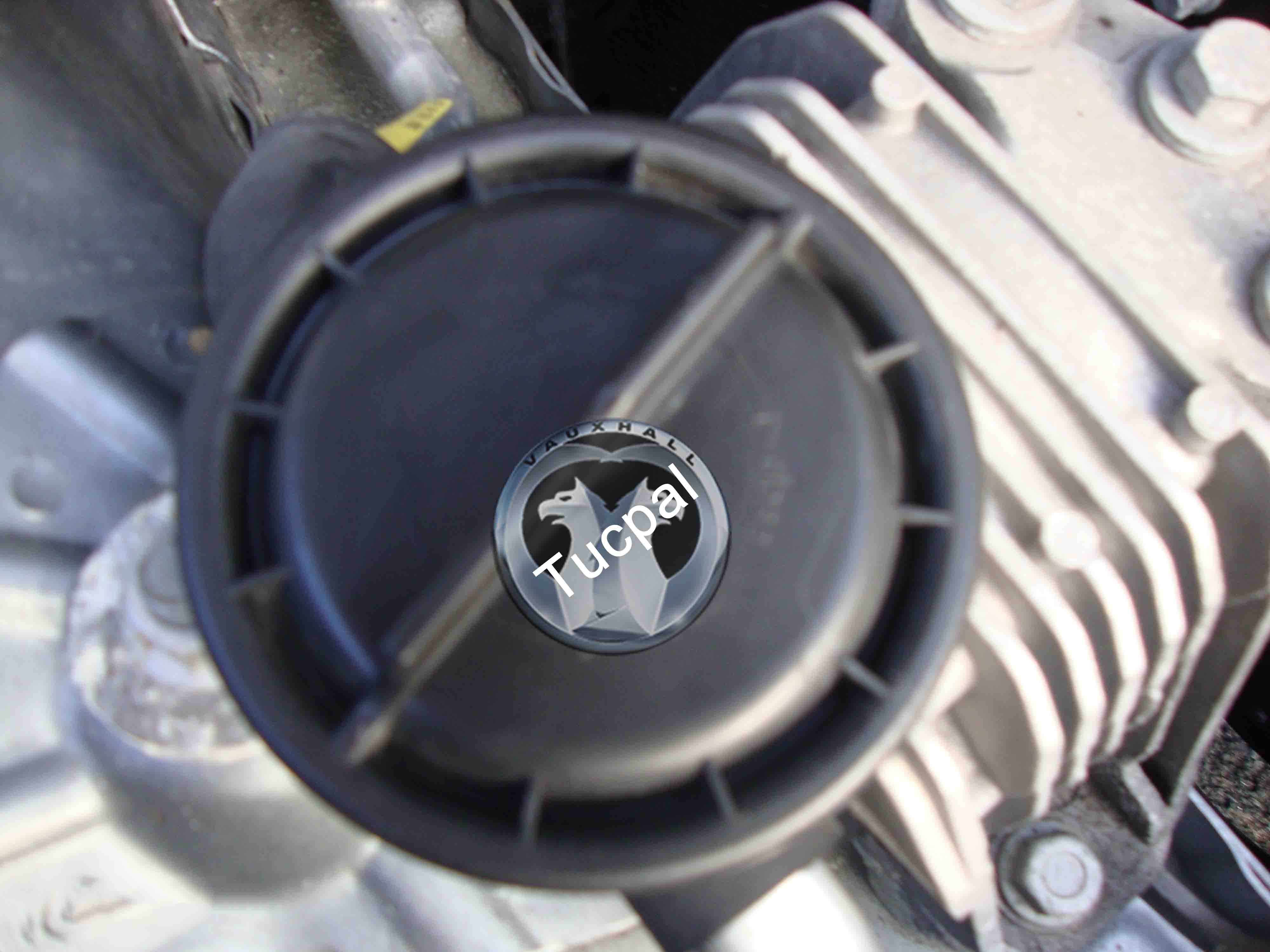

How to change drl and h7 bulbs - tucpal - 1:st-Mar-2014 ![]() This How to will Cover How to change the DRL BULB AND THE H7 BULBS. Most will know How to Do this but it will Help those that Don't. FIRST STEP....... Left Hand side Remove the Hose from the Air Filter then Pull the Air Filter Box out and Place it some were Safe out of the way your Air Hose may be at the Other end of the Air Filter but do the Same and Remove the Air Filter Box out of the way Place a Rag or something over the Hole for the Air Filter so Nothing can fall Down there. Now you will have Access to the DRL and the H7 Bulb Holders Place a Screw Driver in the Slot on the Cover and twist it then Remove the Cover by hand. Now squeeze the Black Tabs on the DRL Holder and Gently take it out just be Real Careful when you Install the New DRL Bulb that it is Fixed in the Holder Properly if it Falls in to the Headlight it is a Nightmare to Get it back Out i Recommend the PIAA DRL as they fit Perfect. Now you can Remove the Two Caps for the H7 Bulbs just Twist them off by Hand. The Bulbs are held in by Two T15 Torx Screws just give them a Half Turn Do not take the Screws Out just Slacken them a bit Then Twist the H7 Bulb out. When you put the Bulbs back in Remember too Tighten up the Two Torx Screws on the h7 Bulbs too Refit the Air Filter Box put the Rubber Boot it Position first this will make it alot Easier to get the Air Box back in to Position. NEXT STEP...... The Right Hand Side. Pull out the Washer Bottle tube and Remove the Fuse Box cover. You can also Remove the 10mm Bolt from the Headlight fixing arm if you want again Place a Screw Driver in the slots and Twist there Really is not alot of Space on this Side it is Really Tight so take your time. Getting the DRL back into this Side is Harder it is much more of a Tight space to work some Members have Removed the Whole Fuse Box to do this but it is Possible to do this with out Removing it. The H7 Covers are the Same it is a very Tight space again so you will need a Really Small Screw Driver to slacken the Two screws and Remove the H7 Bulb. Hope this has helped Someone out there.. Real easy to do but just take you Time on the Right Hand side as it is a Tight place to work. Please note if changing the DRL bulbs for the cheaper Blue DRL bulbs like these NOTE.......... On some cars you may get and Error about Position lamp, Check the DRL is Working if it is Check the Rear Lights as this will Also bring up the Errors on the DRL if a Taillight has Blown. ![]() How to change drl and h7 bulbs - Lewis6317 - 2:nd-Mar-2014 in total its 4 h7 bulbs isnt it? reason i ask as looking for replacements on ebay and most have h7 and h1 and unsure if all four main bulbs are what How to change drl and h7 bulbs - Rusty2009 - 2:nd-Mar-2014 Yes mate all are H7 Check out this thread for the info on bulbs How to change drl and h7 bulbs - Lewis6317 - 2:nd-Mar-2014 rusty, how did i miss that out lol nice mate
