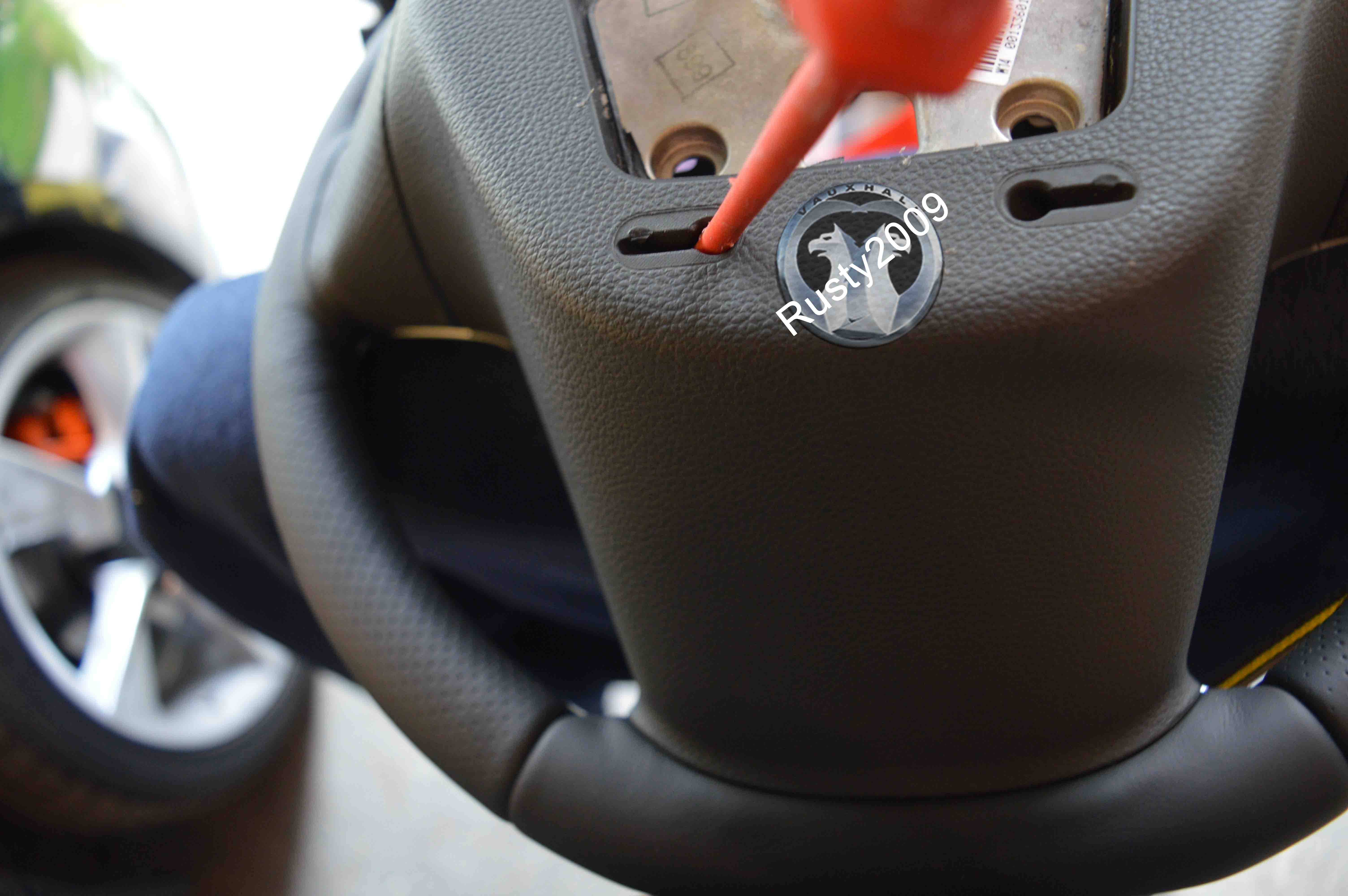

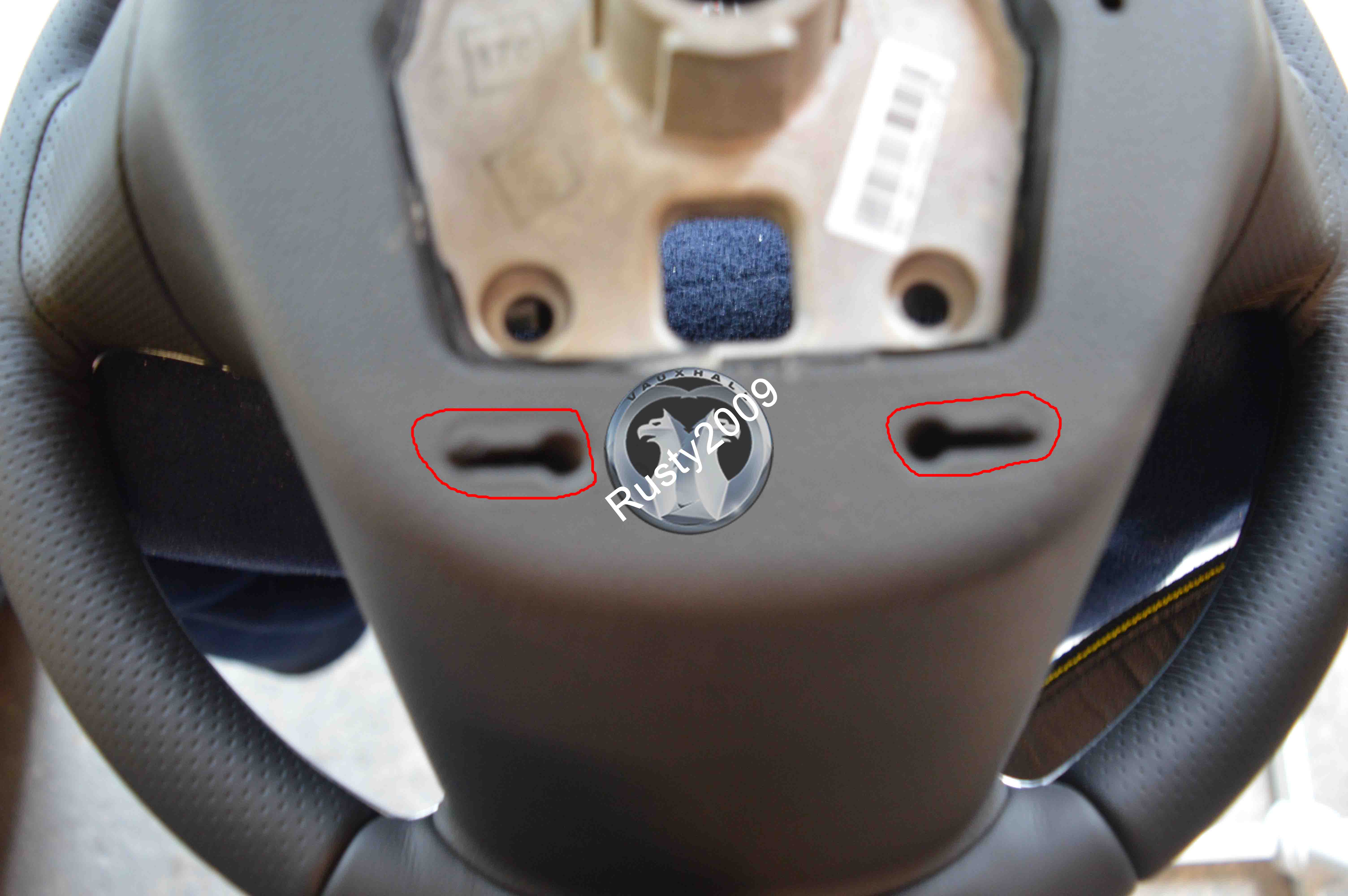

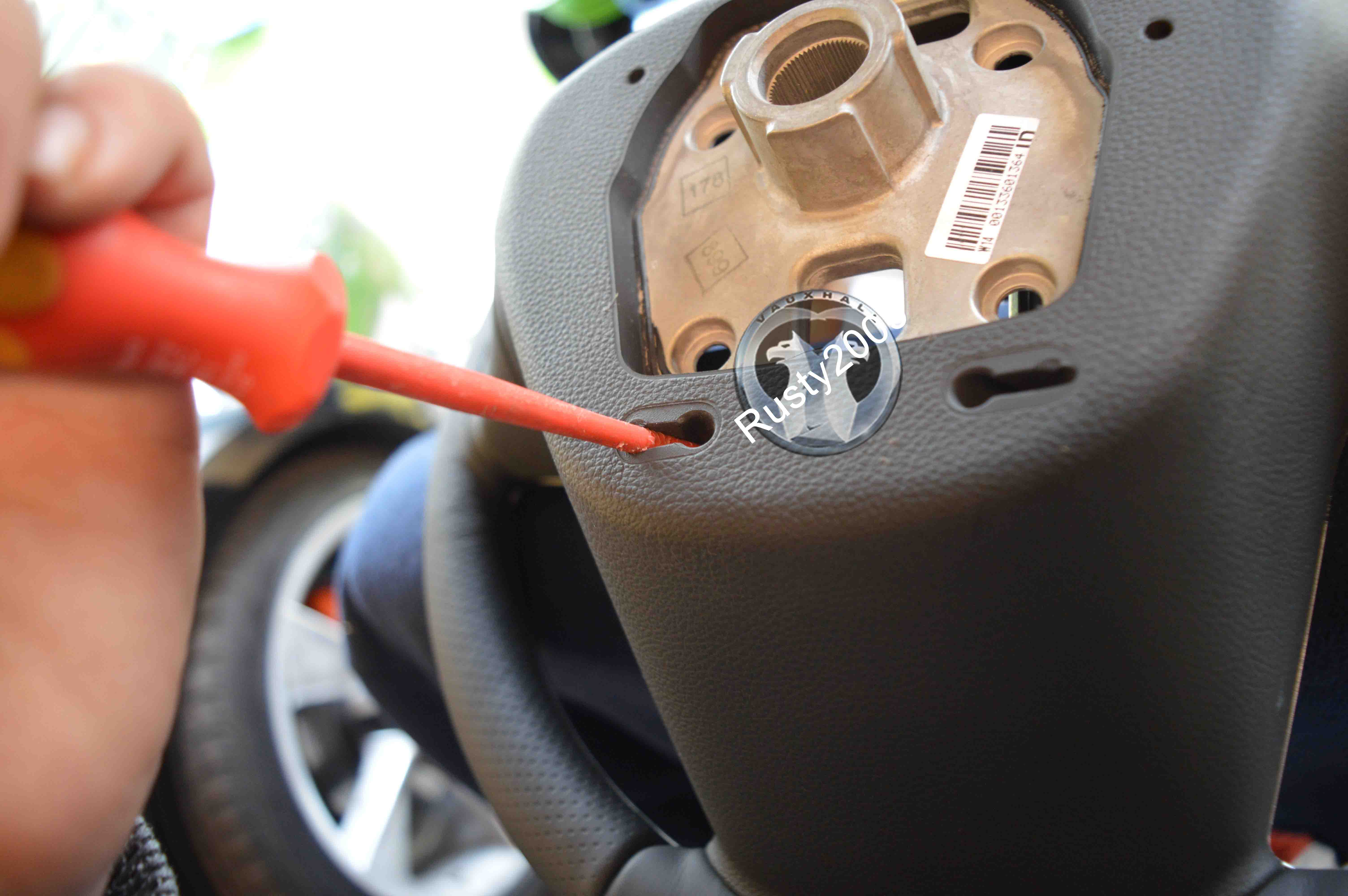

You need to get to the holes behind
[Image: 5.JPG]
then using a small screw driver or nail punch or allen key go in the round end and then pull to the side
[Image: 6.JPG]
[Image: 7.JPG]
This will move the metal poles that are holding the airbag in and pull the airbag carefully out towards you (if doing one side at time don't pull to much until you have released the second side)

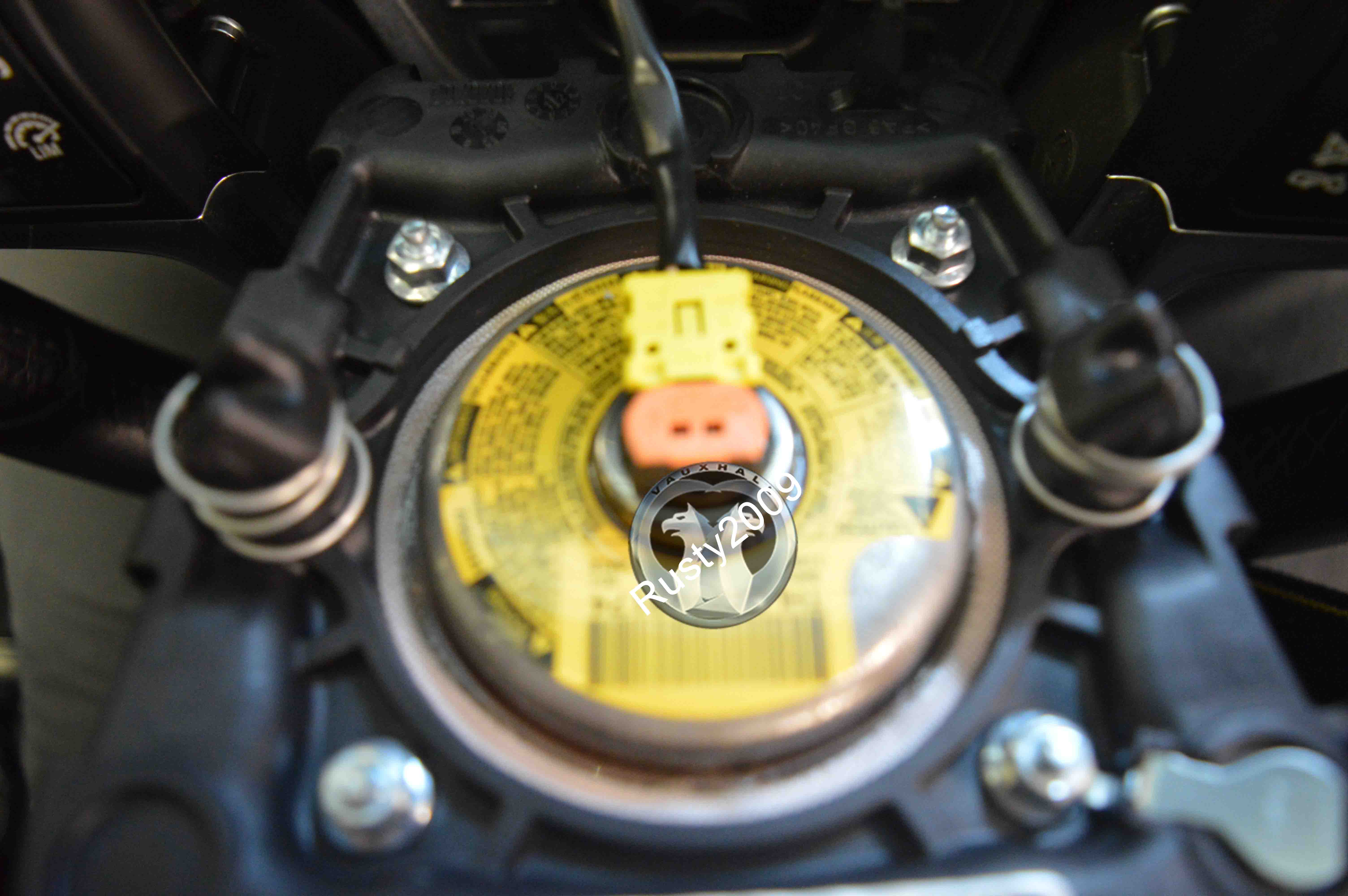

With the Airbag off you then need remove the wire it just pulls up but be very careful as it is really stiff, If you wanted you could un-clip it from the connector at the top of the wheel just follow the wire up.
[Image: 9.JPG]
[Image: 10.JPG]
To remove the steering wheel first make sure the wheels are in the straight ahead position then un-cilp the connector plug undo the bolt (do not fully undo it) then pull the wheel towards you, once released remove the bolt fully and pull the wheel off.

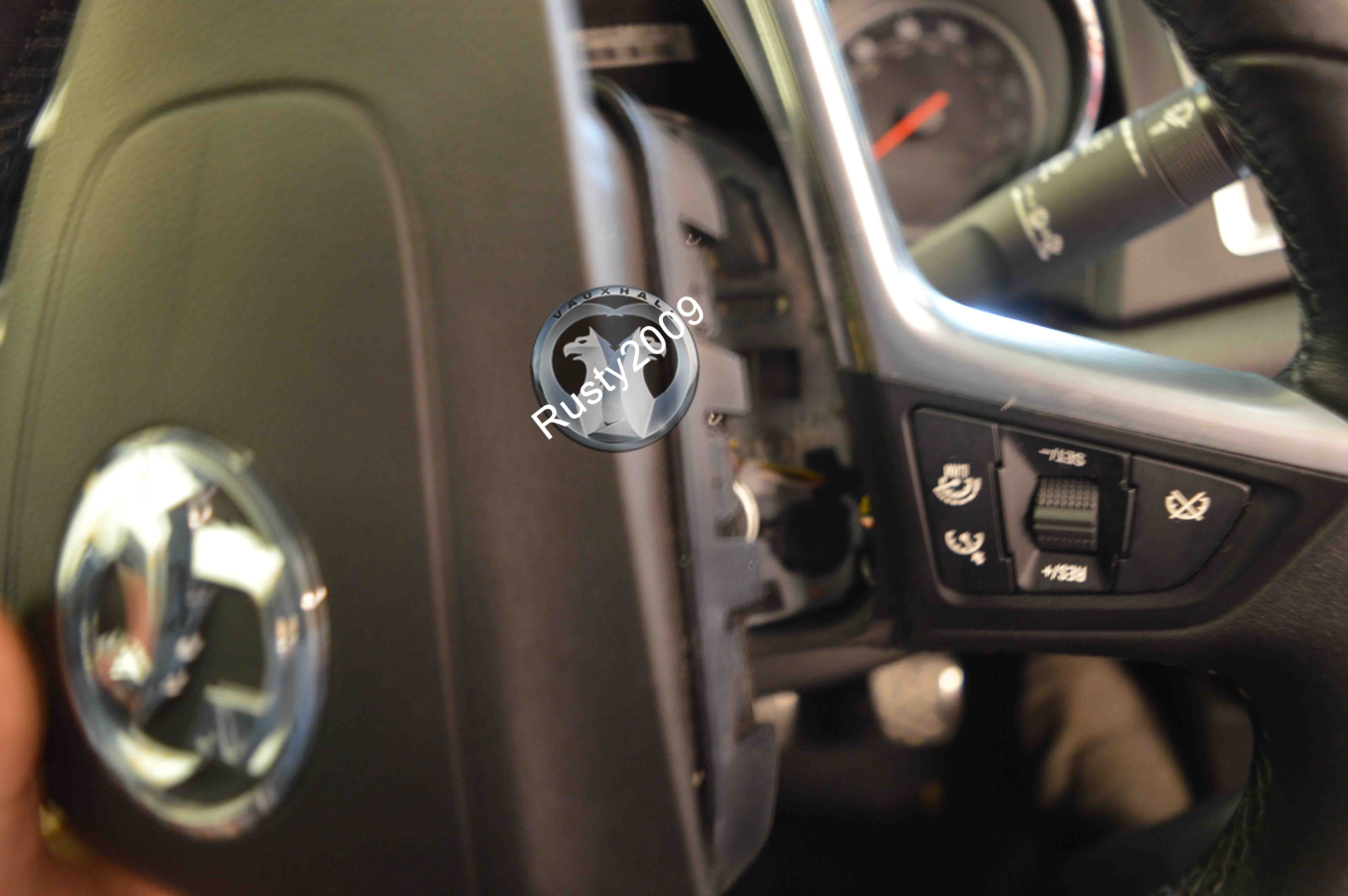

If you want to remove the buttons from the steering wheel (This does not include the VXR steering wheel) then follow the steps for removing the airbag.
Once the airbag is off you need to remove the trim that runs around the wheel and buttons.

First off unplug the connectors to the buttons the push tab is on the bottom of the connector
[Image: 2.JPG]
[Image: 3.JPG]

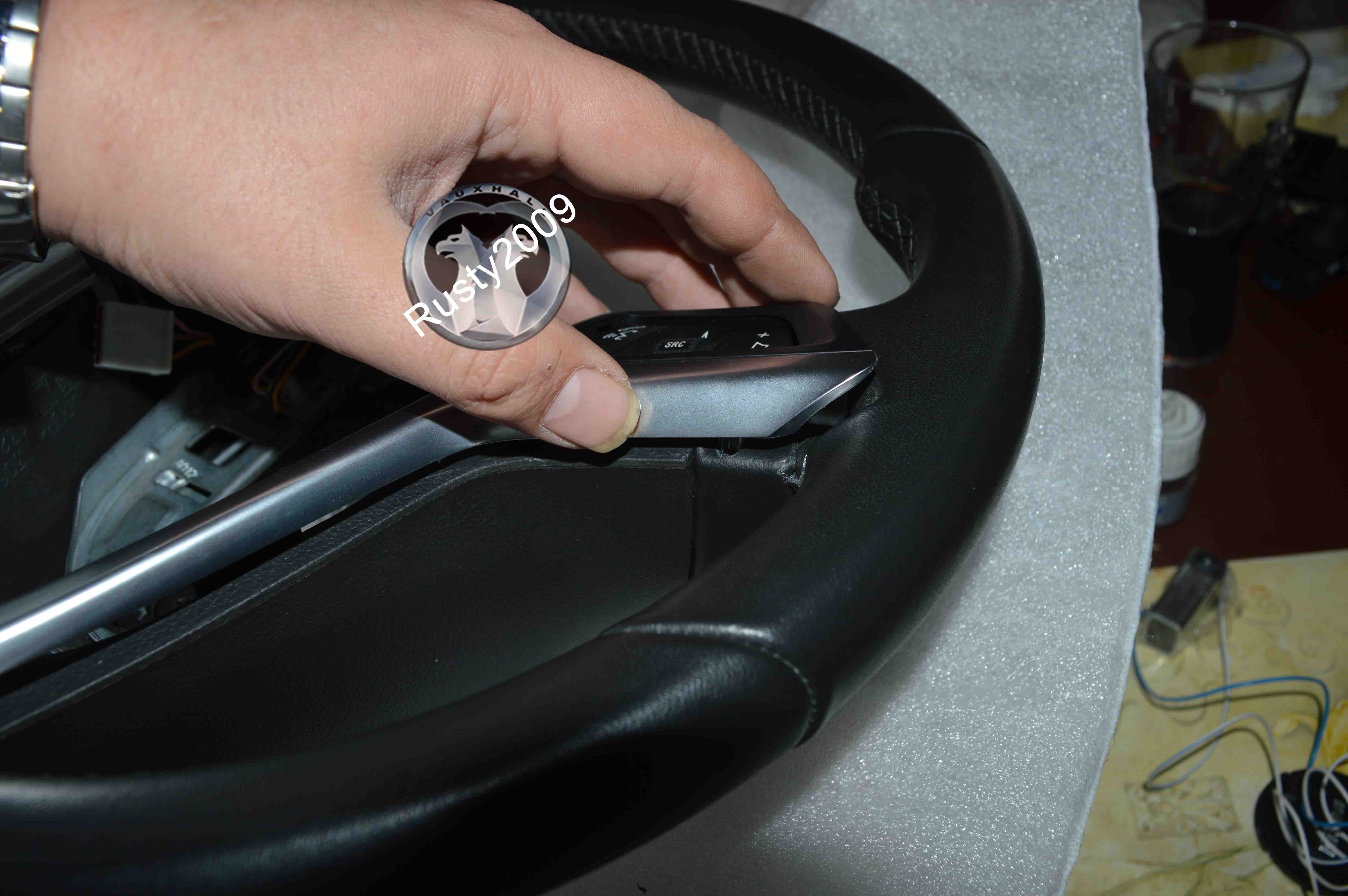

Then starting at the bottom and working your way round pries the trim up not too much then start again until the trim is off
[Image: 4.JPG]
[Image: 5.JPG]
[Image: 6.JPG]
[Image: 7.JPG]
Then to remove the buttons simply get hold of both sides and pull up and wiggle out again these will be tight.

How can i get my airbag off without having those 2 small holes in this picture?
Infact underneath my steering wheel is all smooth no holes at all. I have like a hole with a bolt but thats like on the steering column?
Turn the wheel upside down, you don't have two holes?
