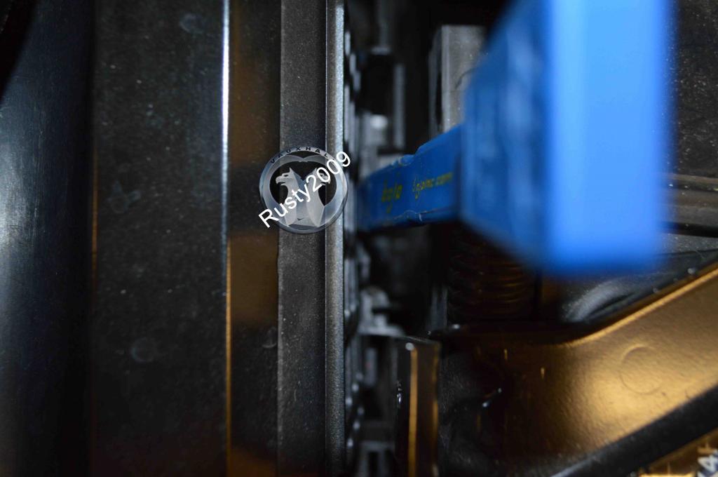

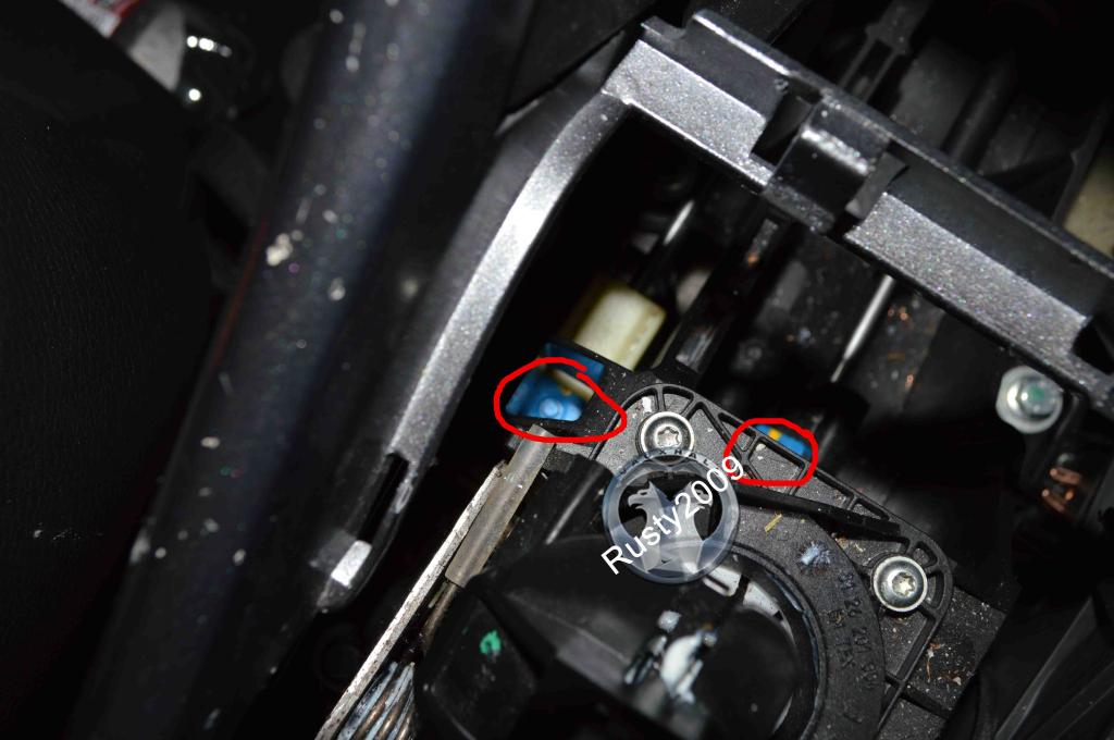

2, Then you need to release the gear linkage there are two but could only get a good pic of 1 of them, use a screw driver and pull the black ring black (once fully done you see the blue square button rise fully up)
![[Image: 4.JPG]](https://www.vxoc.org.uk/Images/rusty/post%20images/F40%20Gear%20linkage/4.JPG)

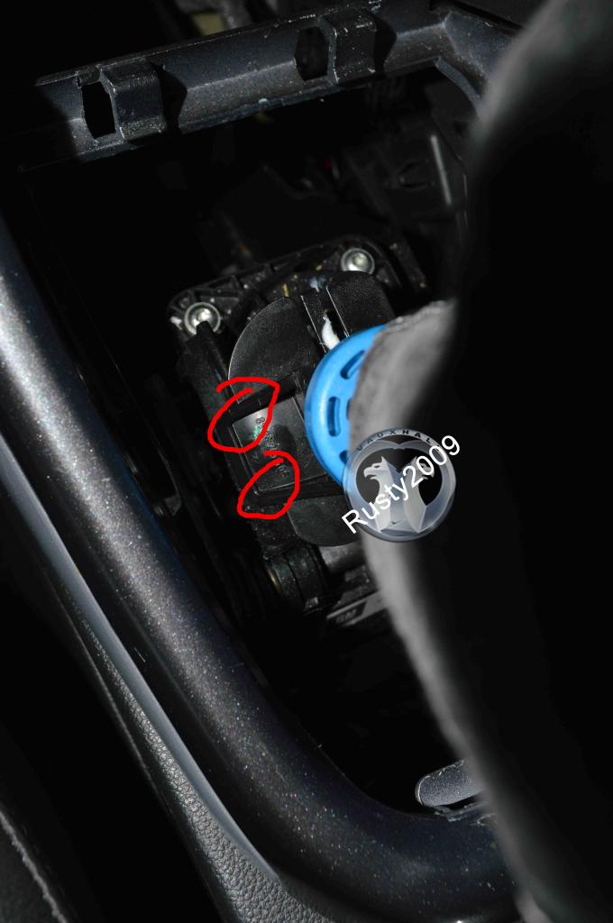

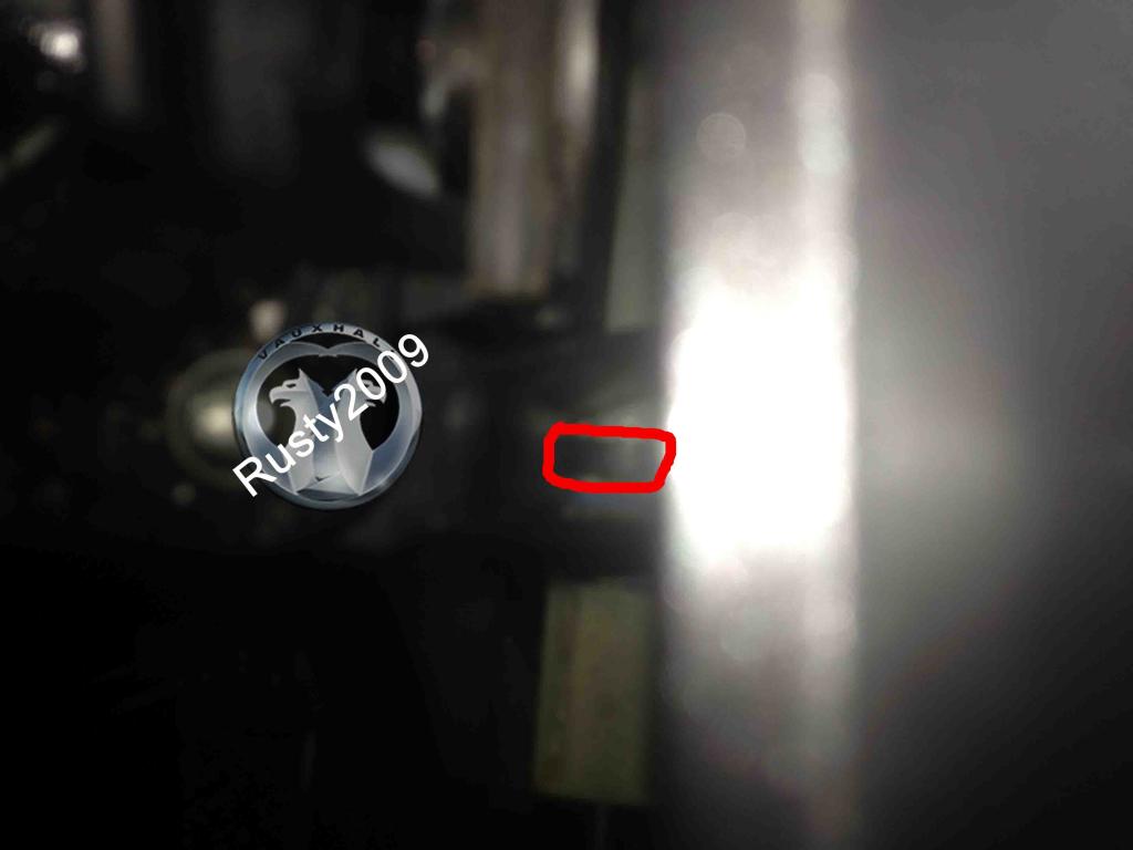

3, Next you need to unclip the gear knob there two tabs one each side just push them in and pull the blue ring up and fully remove the gear knob
![[Image: 5.JPG]](https://www.vxoc.org.uk/Images/rusty/post%20images/F40%20Gear%20linkage/5.JPG)

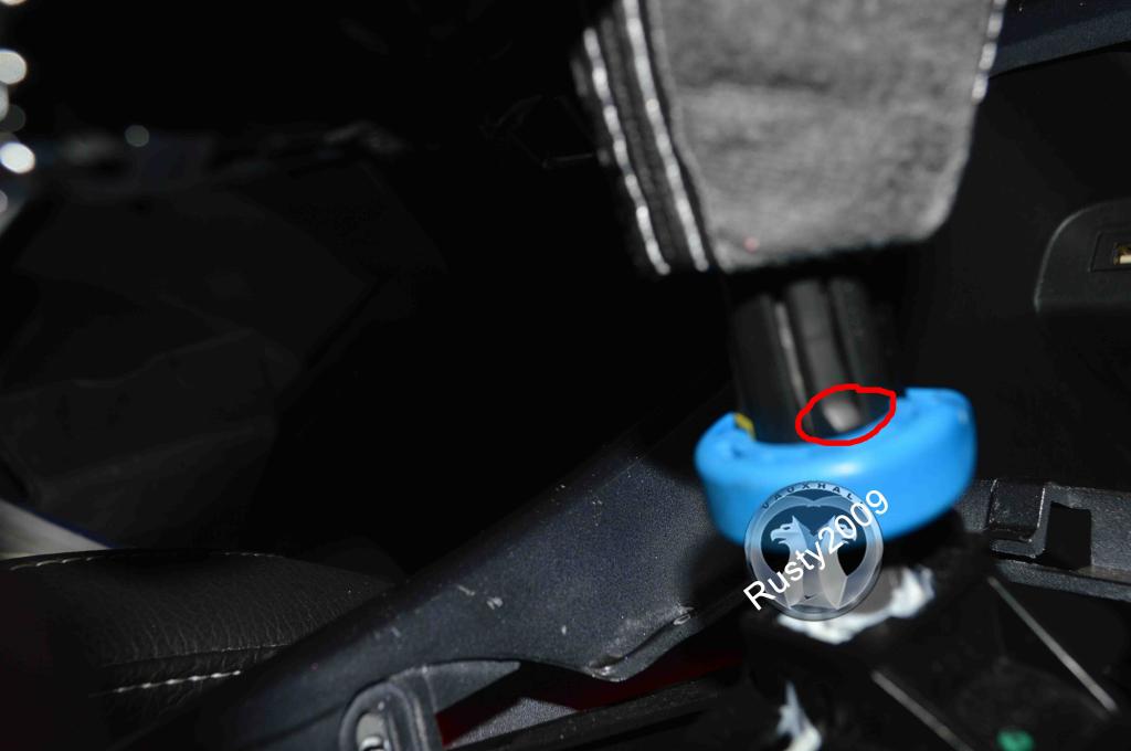

4, Turn the gear knob 180 degrees and put it back on the stick (no need to lock the blue ring down)
![[Image: 6.JPG]](https://www.vxoc.org.uk/Images/rusty/post%20images/F40%20Gear%20linkage/6.JPG)
There are two holes for it it slot in (I've marked where they should be)
![[Image: 6a.JPG]](https://www.vxoc.org.uk/Images/rusty/post%20images/F40%20Gear%20linkage/6a.JPG)

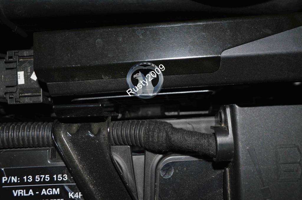

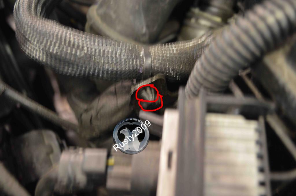

5, Un-clip the ECU wiring from the battery tray (there are two)
![[Image: 7.JPG]](https://www.vxoc.org.uk/Images/rusty/post%20images/F40%20Gear%20linkage/7.JPG)
6, Un-clip the ECU from the battery tray and carefully place to one side.

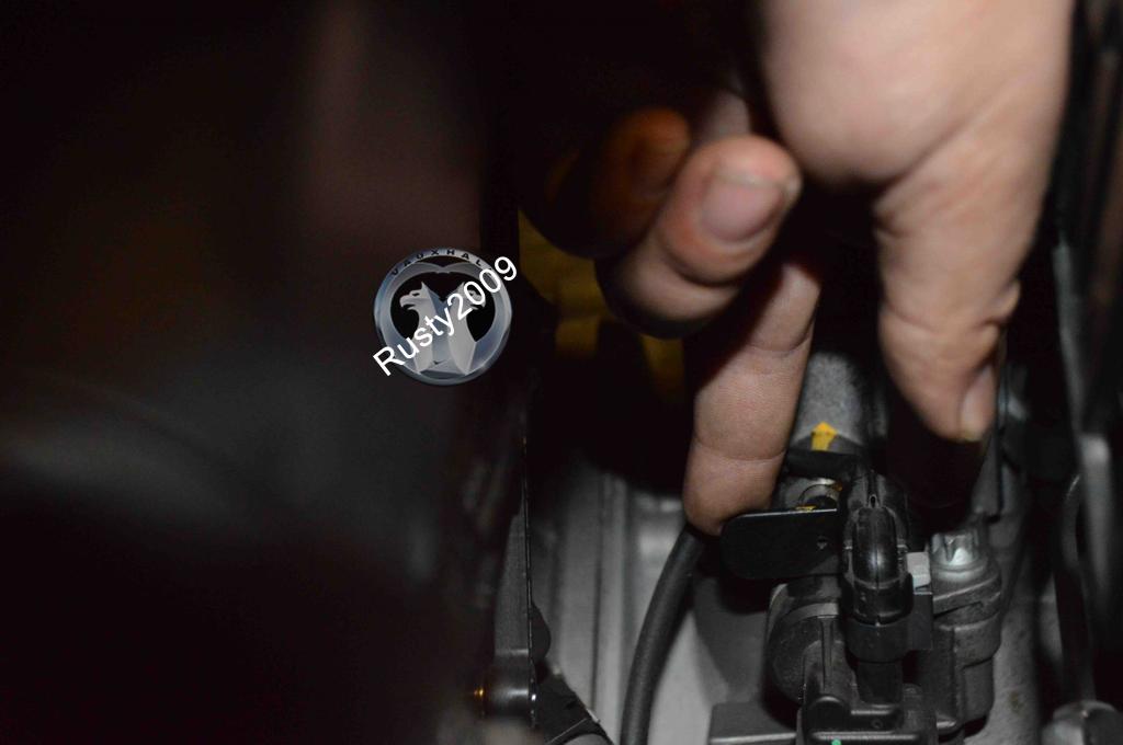

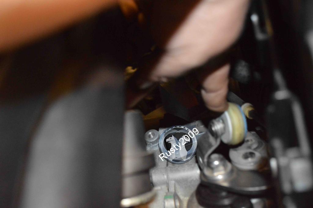

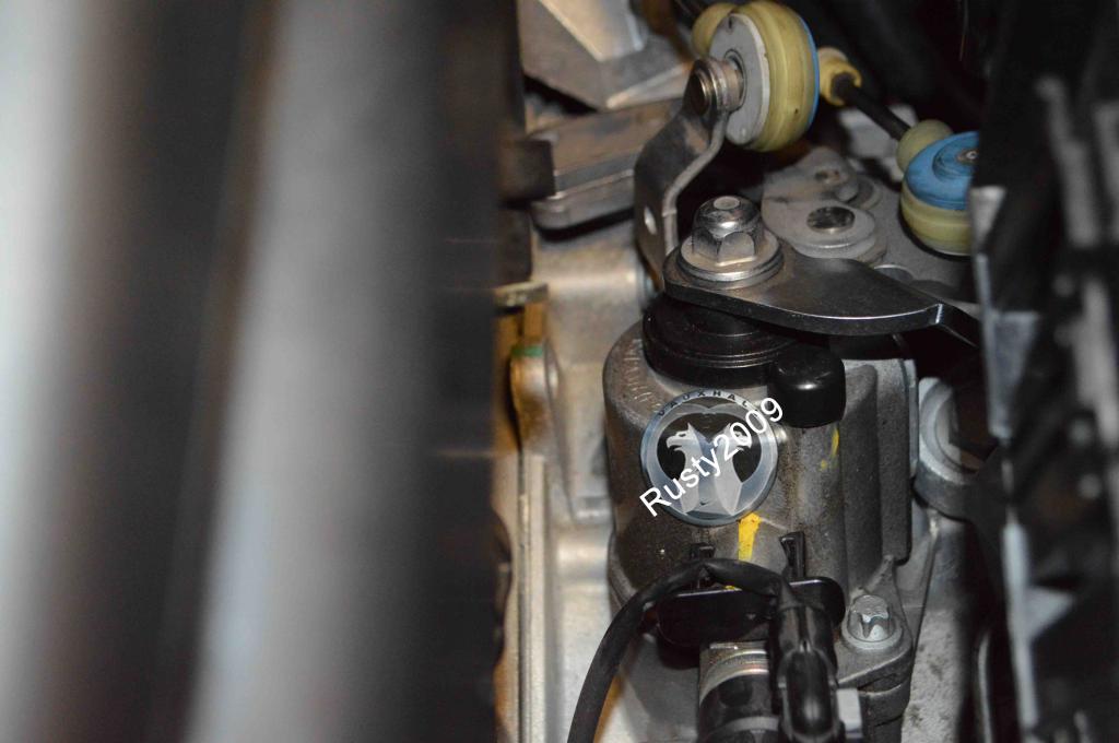

7, The tab my finger is on and the linkage my finger is pointing to are the ones we need to move now.
![[Image: 9.JPG]](https://www.vxoc.org.uk/Images/rusty/post%20images/F40%20Gear%20linkage/9.JPG)
![[Image: 9a.JPG]](https://www.vxoc.org.uk/Images/rusty/post%20images/F40%20Gear%20linkage/9a.JPG)
You need to push the linkage back while pushing the black tab in (you need to make sure the black tab goes back fully like so)
![[Image: 10.JPG]](https://www.vxoc.org.uk/Images/rusty/post%20images/F40%20Gear%20linkage/10.JPG)
