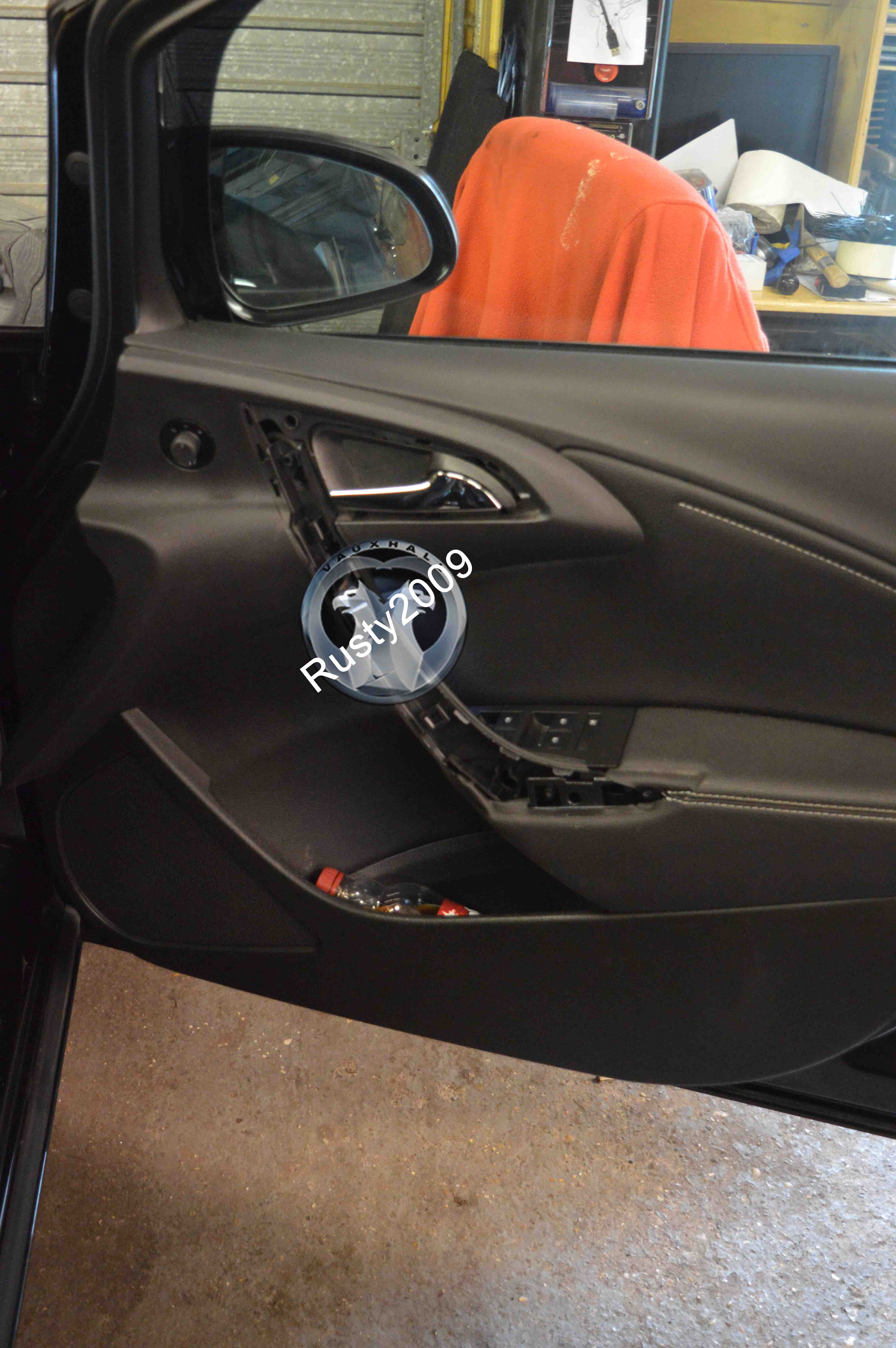

How-to Remove Door Trim.

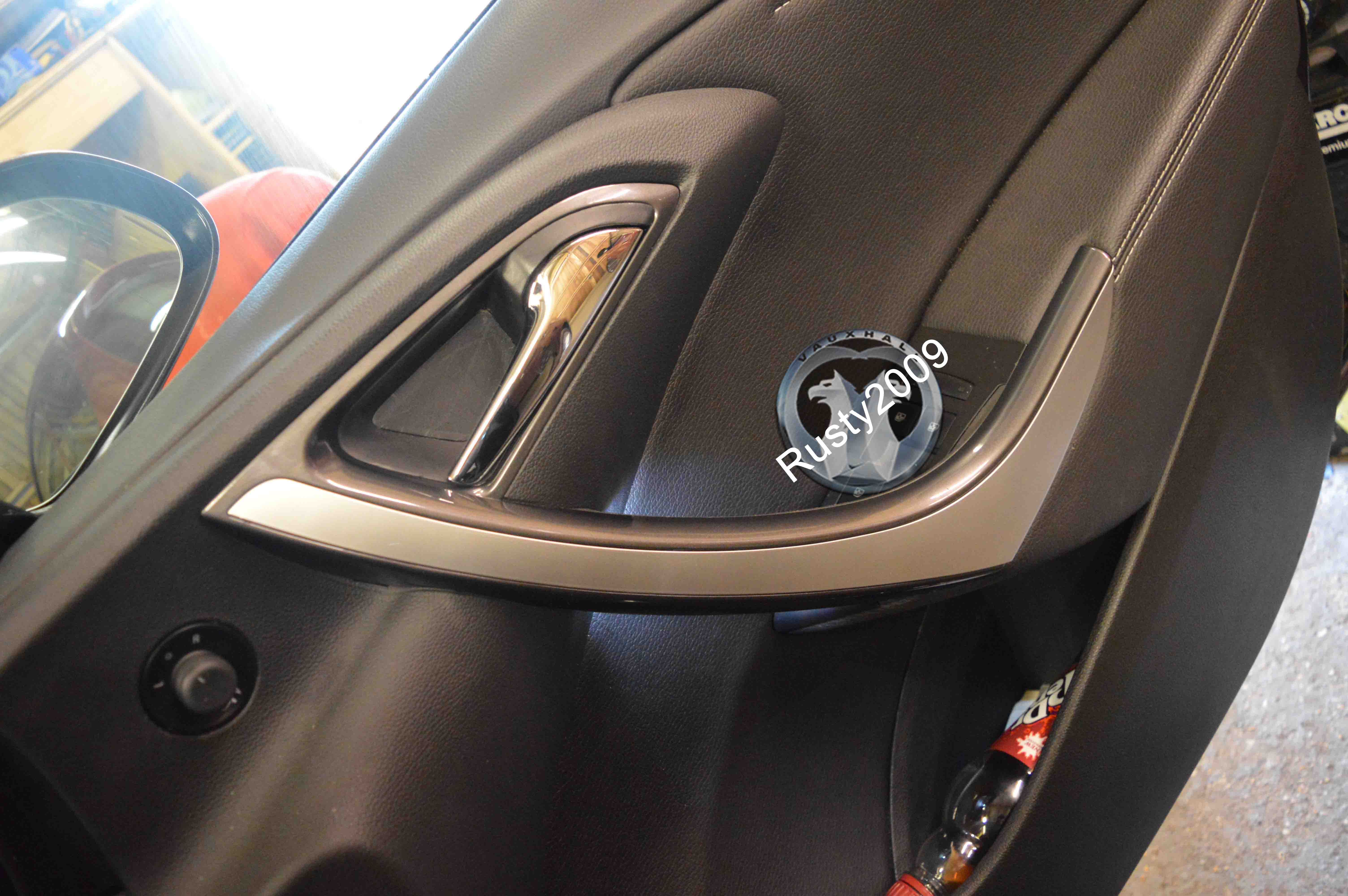

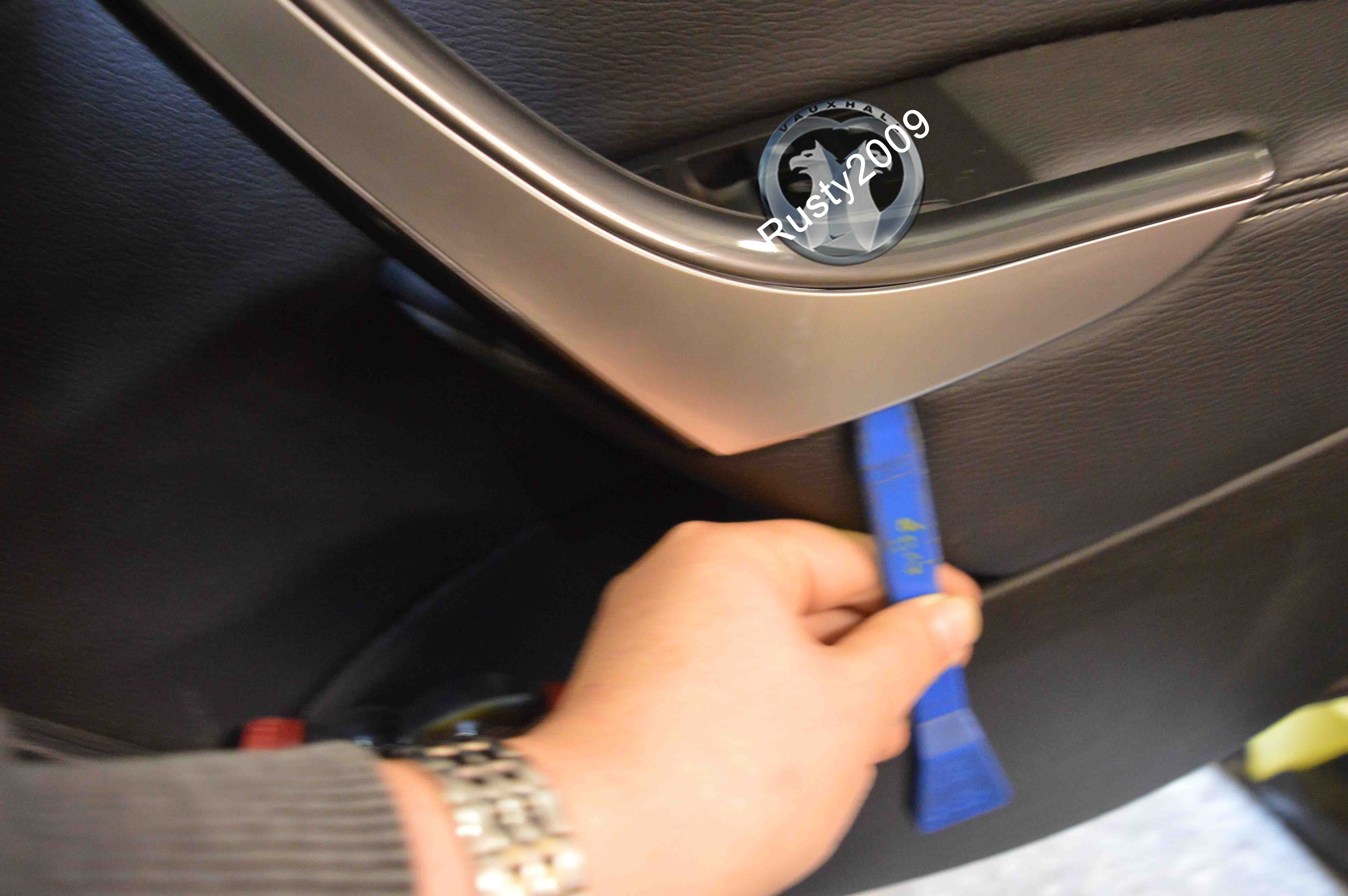

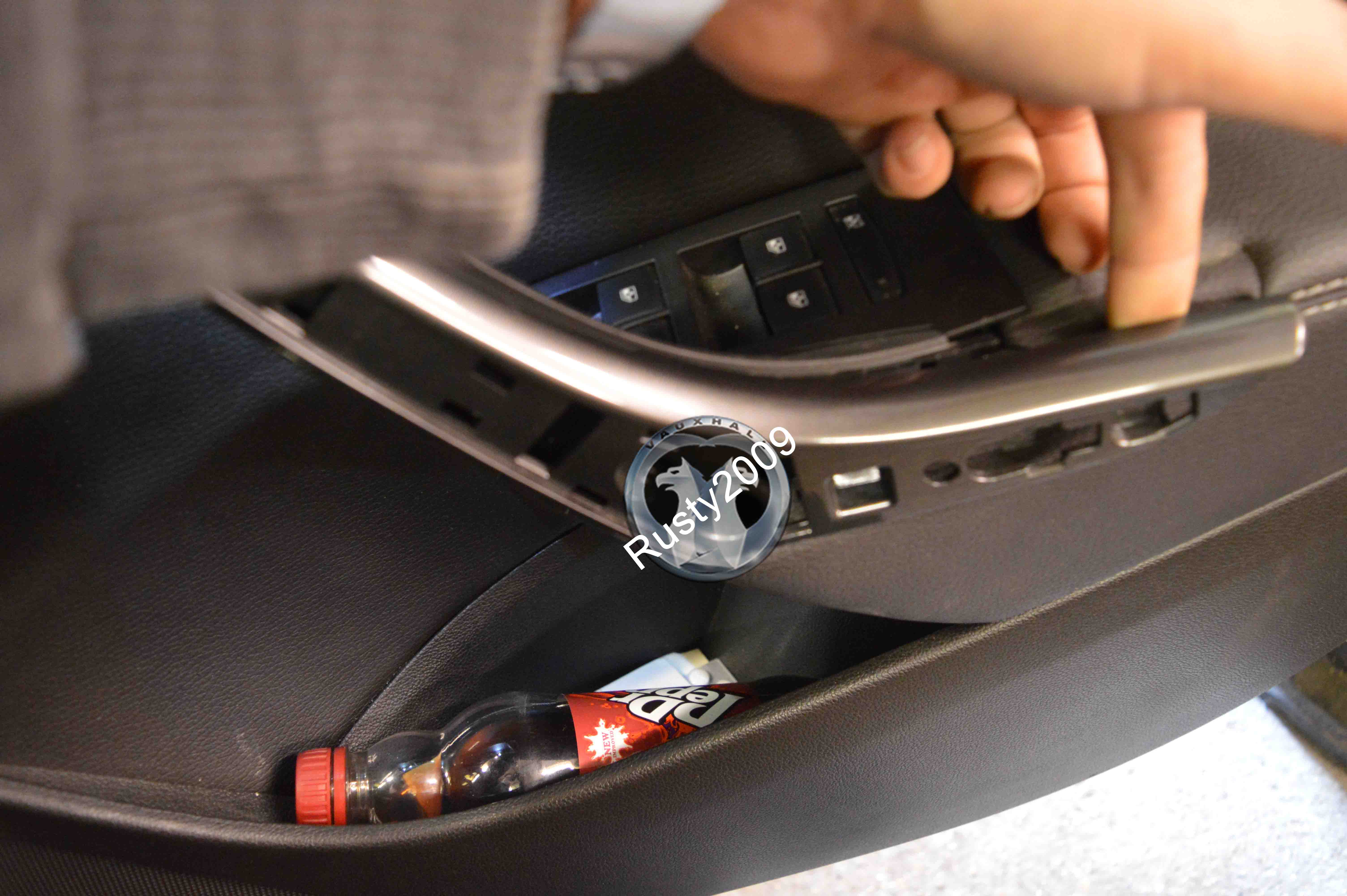

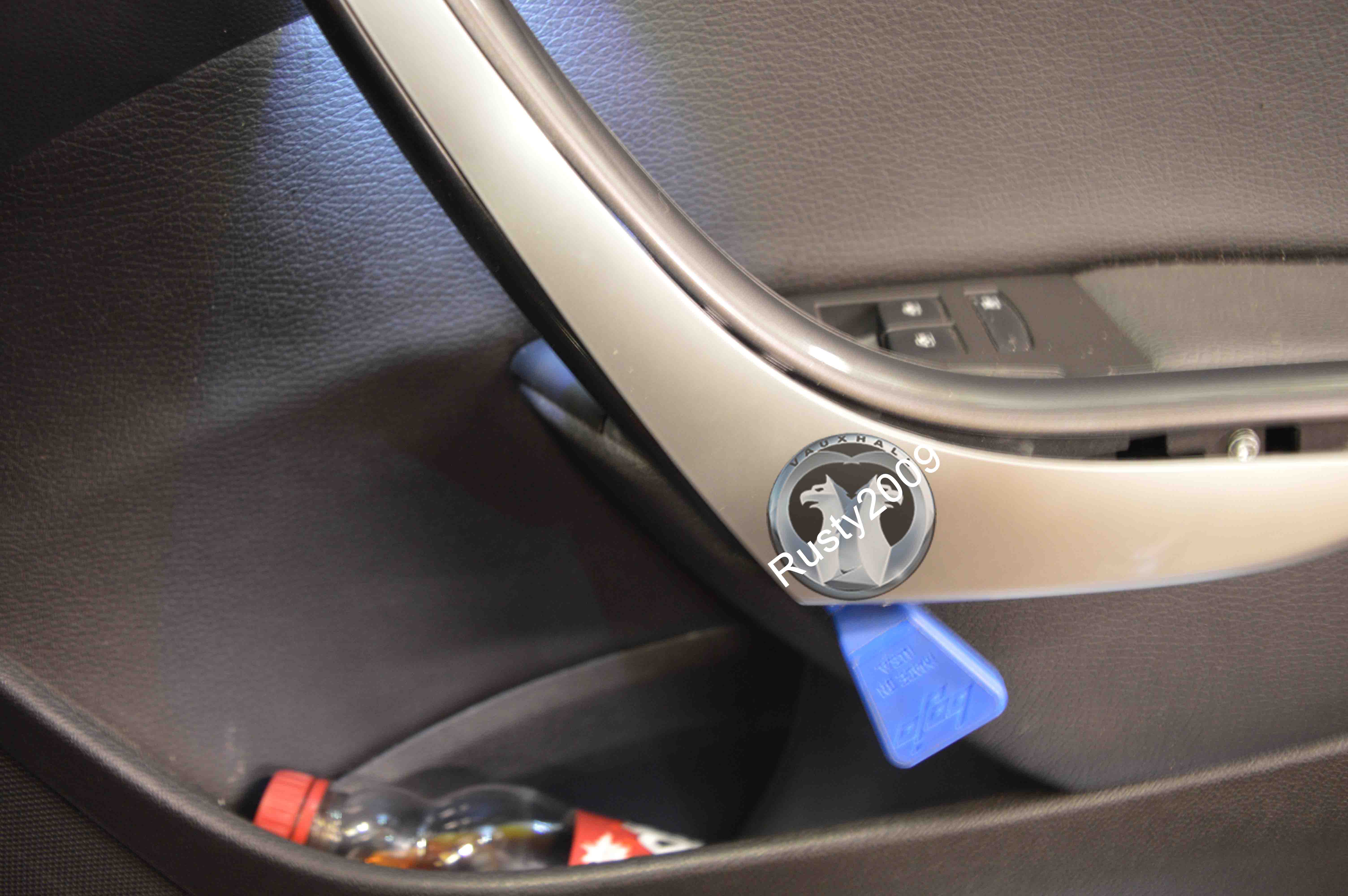

So first start by getting a trim tool and go about half way along the bottom.

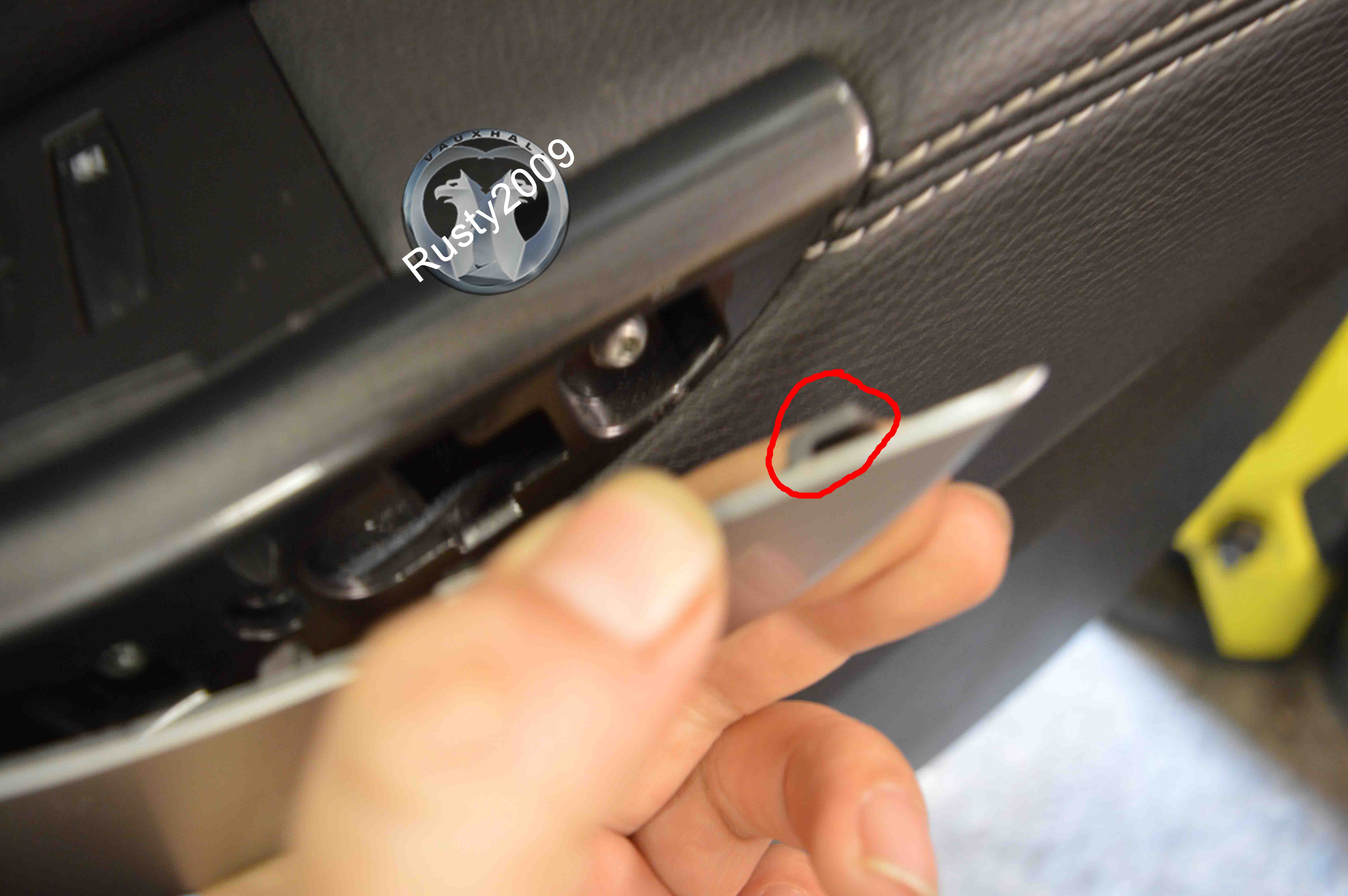

Then work to left abit then to the right just use a twist method on the trim tool (be careful on the right side as there is a hook that can brake)

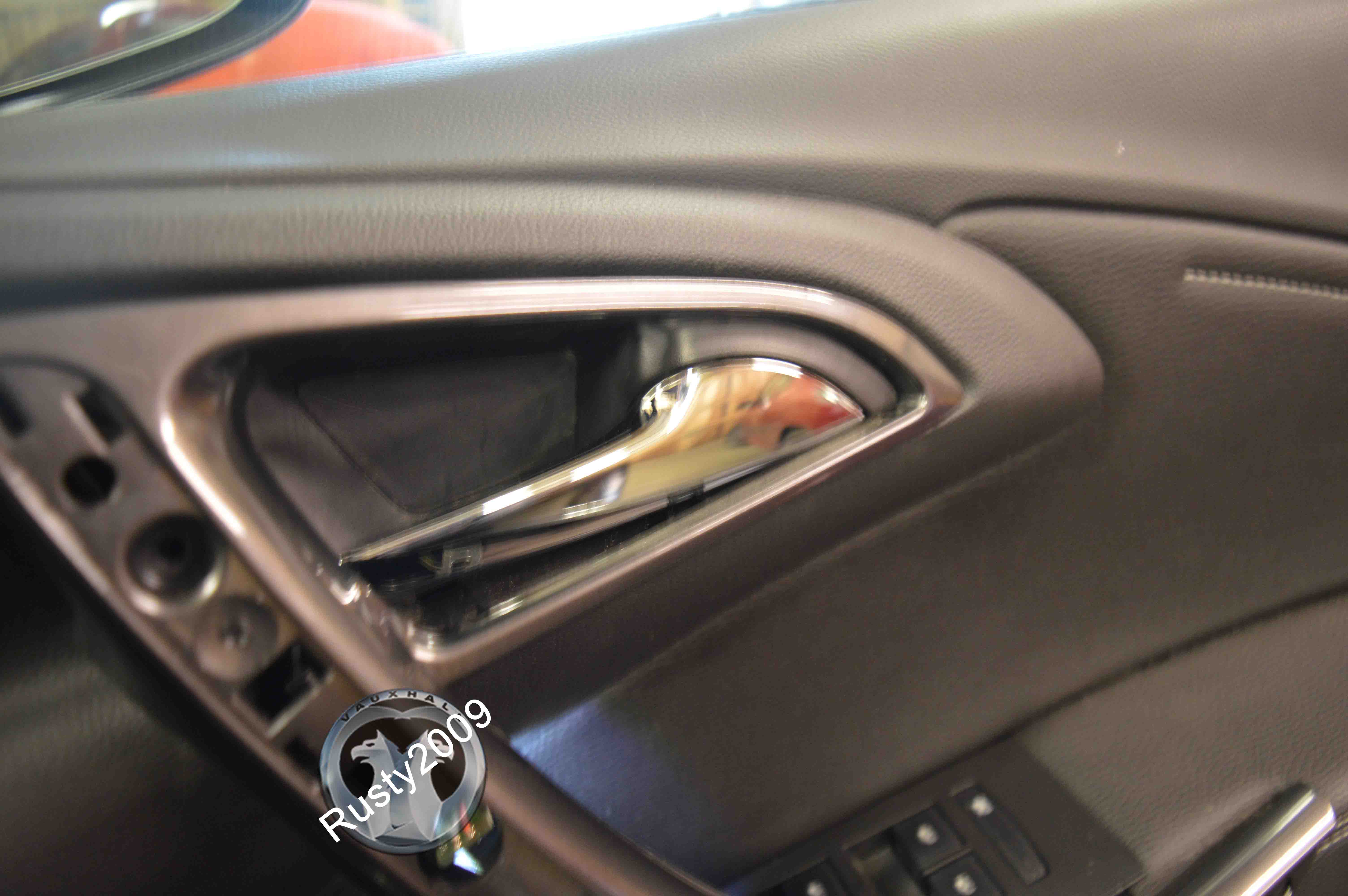

Then work your way up the trim go in from behind and again use a twisting method

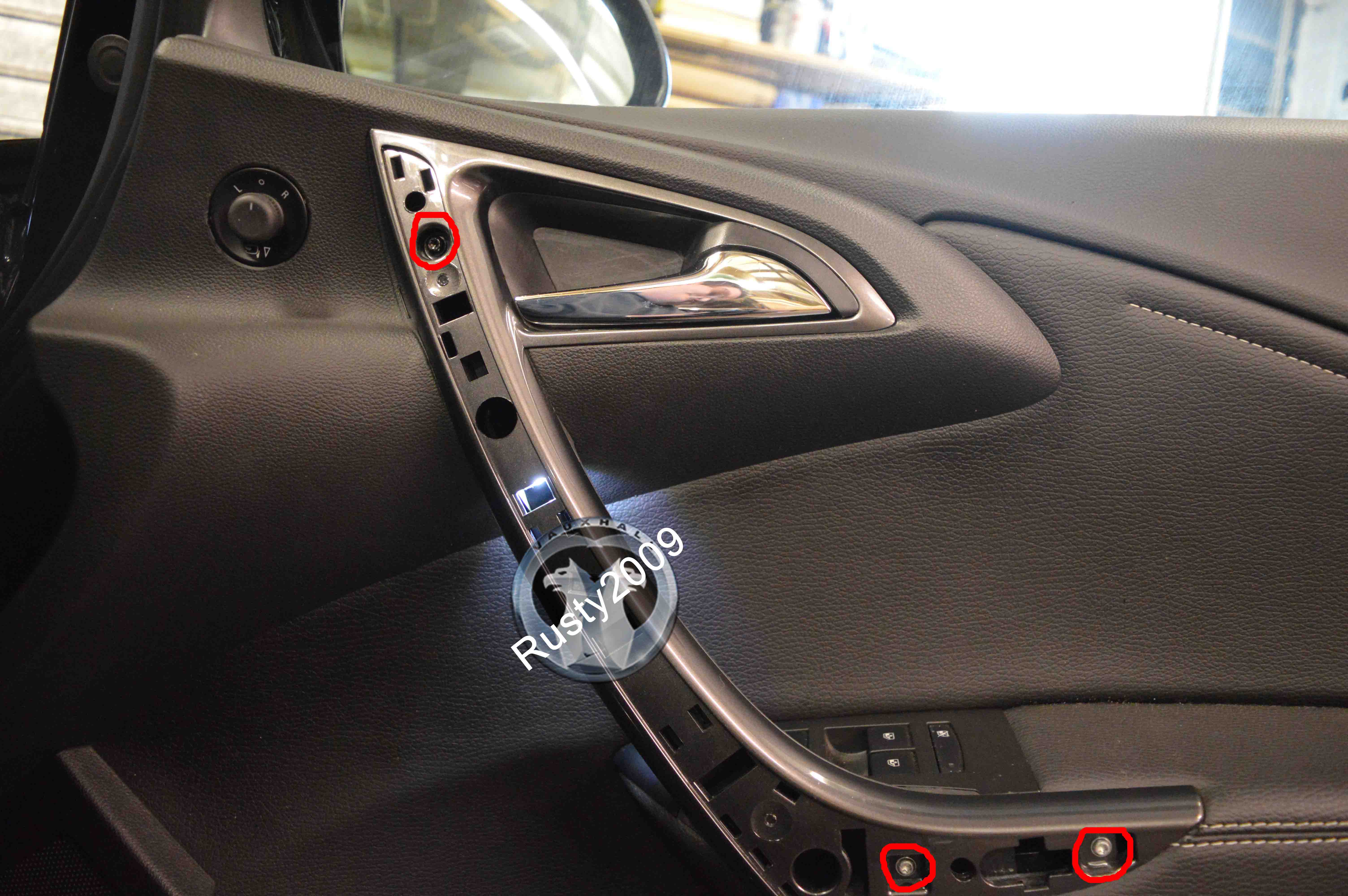

Once the trim is off there is 3 screws that need to be removed as marked.
Once removed the trim will be lose

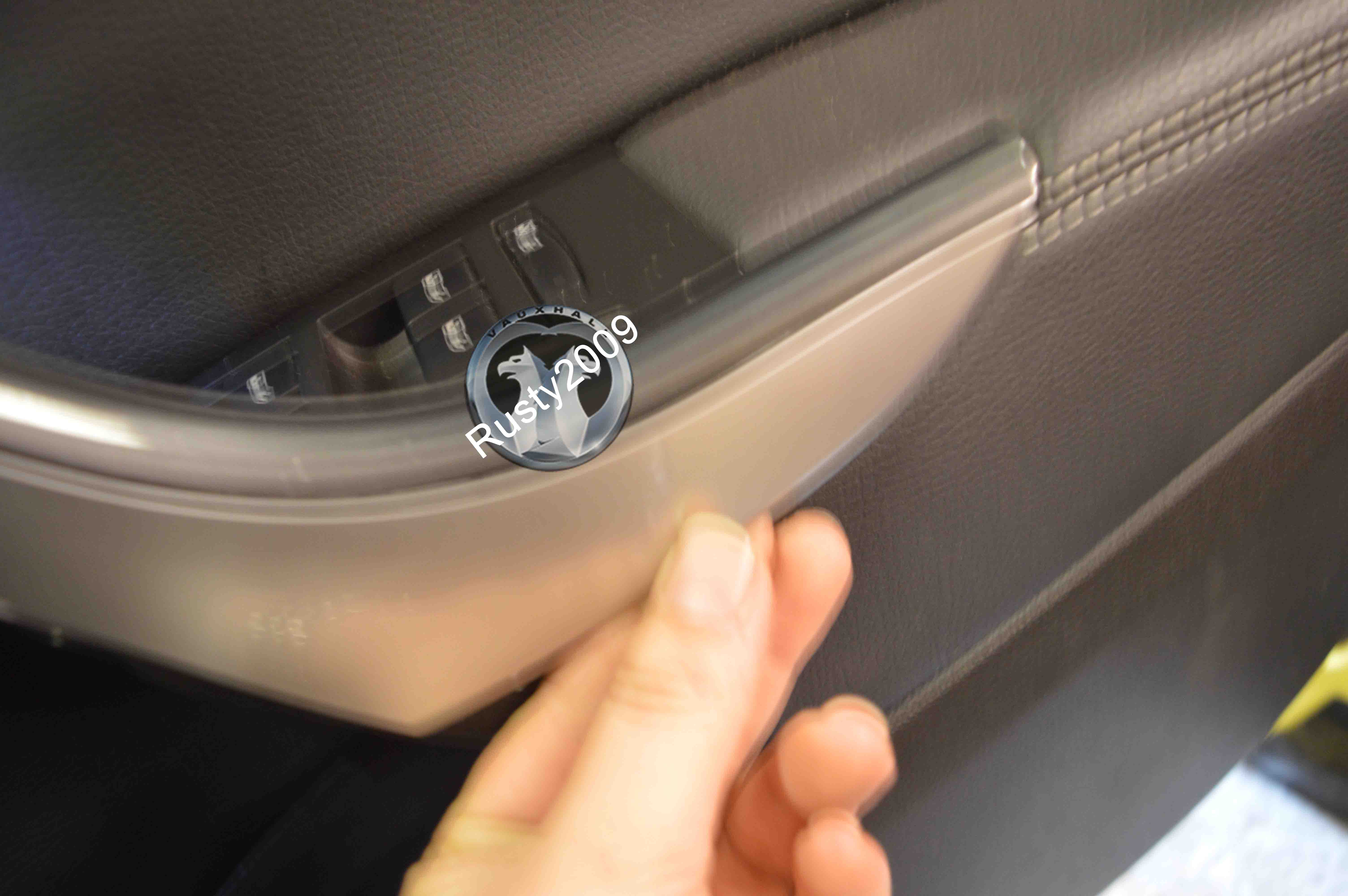

Get your trim tool and then get in behind the time and again using a twist method un-clip the bottom clip then just work your way up.
When you get to the top (around the door handle) you need to unclip top & bottom equally
On refitting start at the corner of the handle and work your way along then down.
